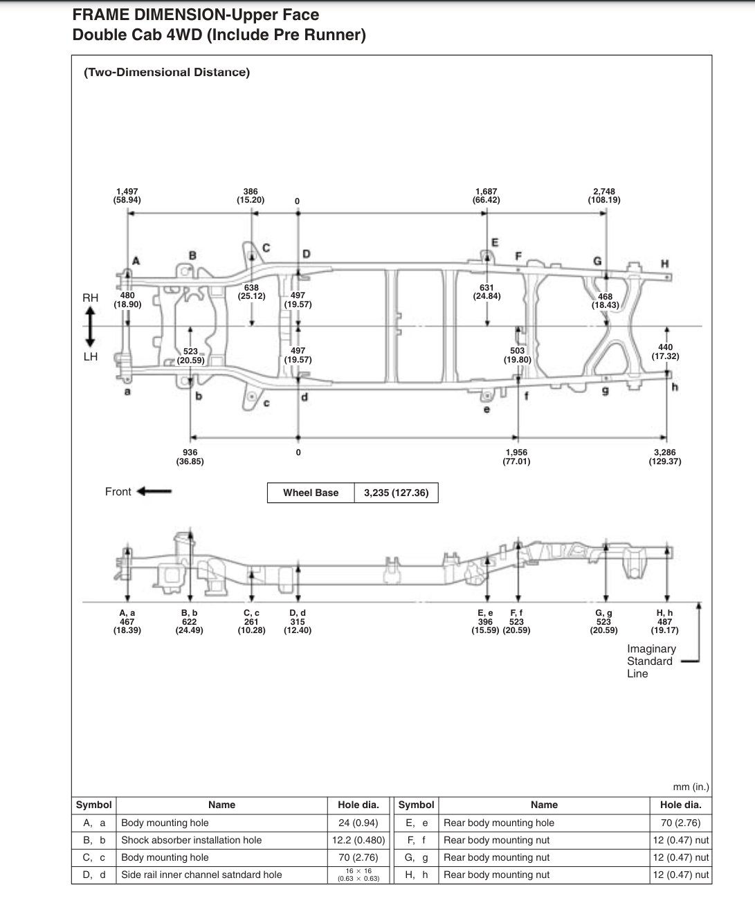

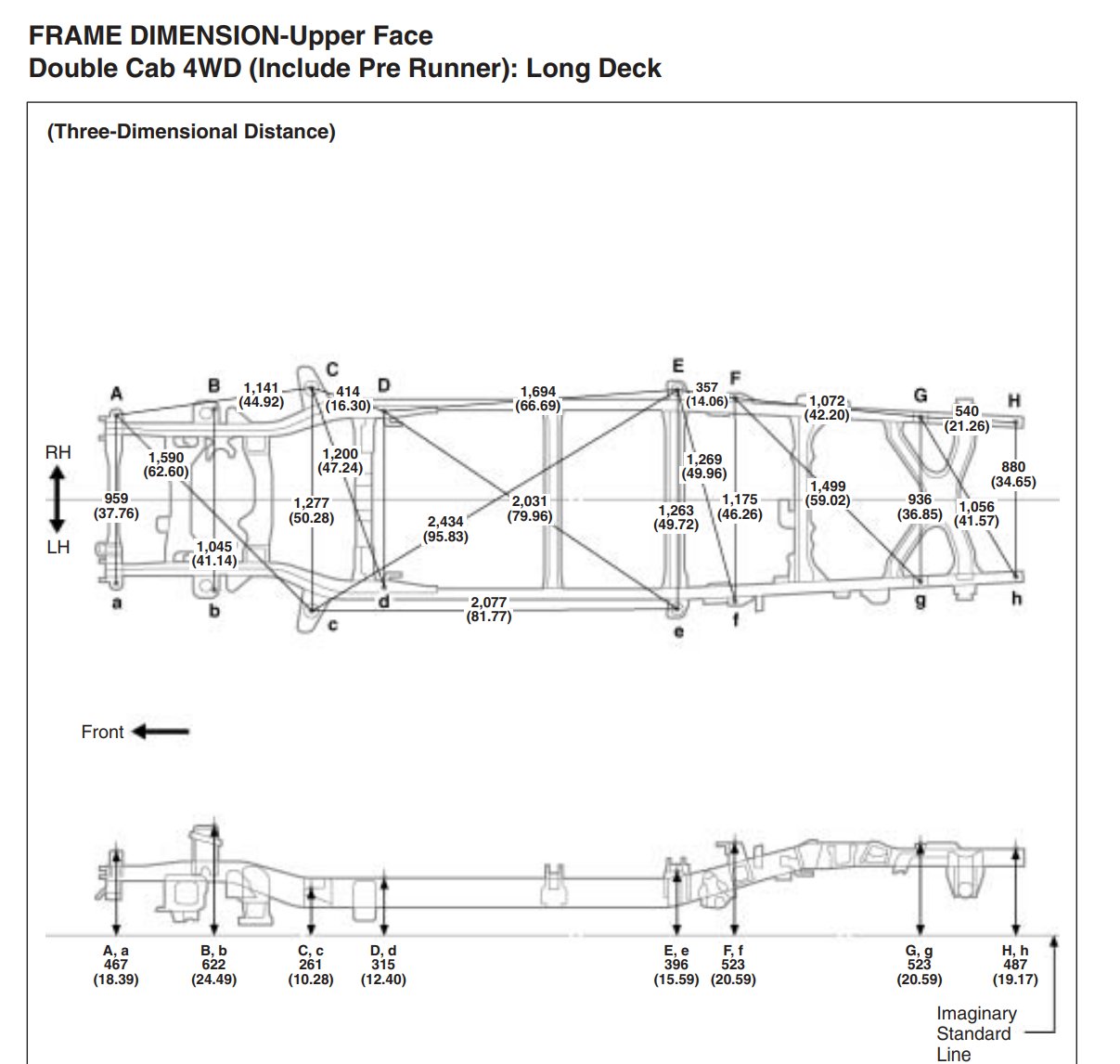

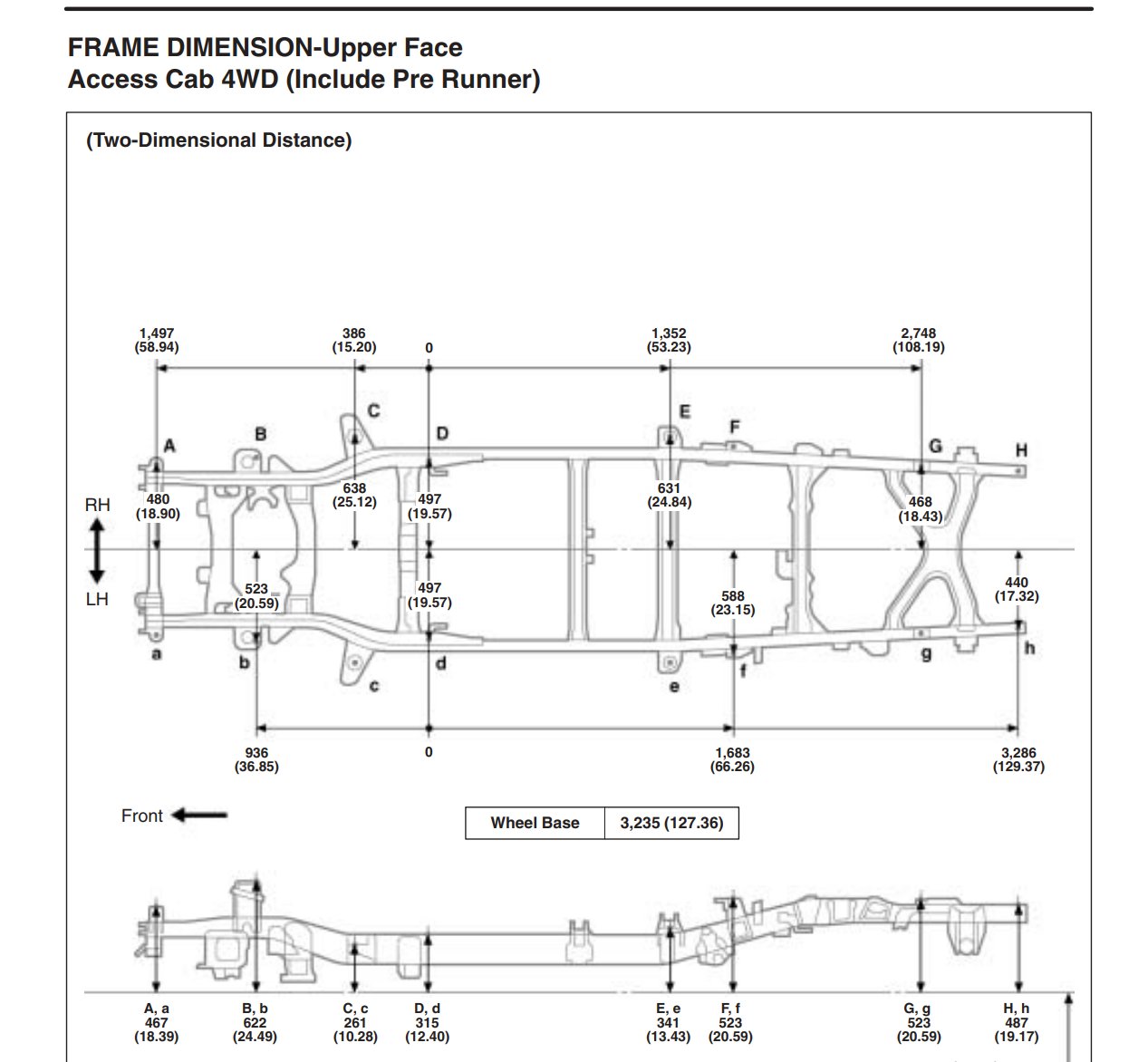

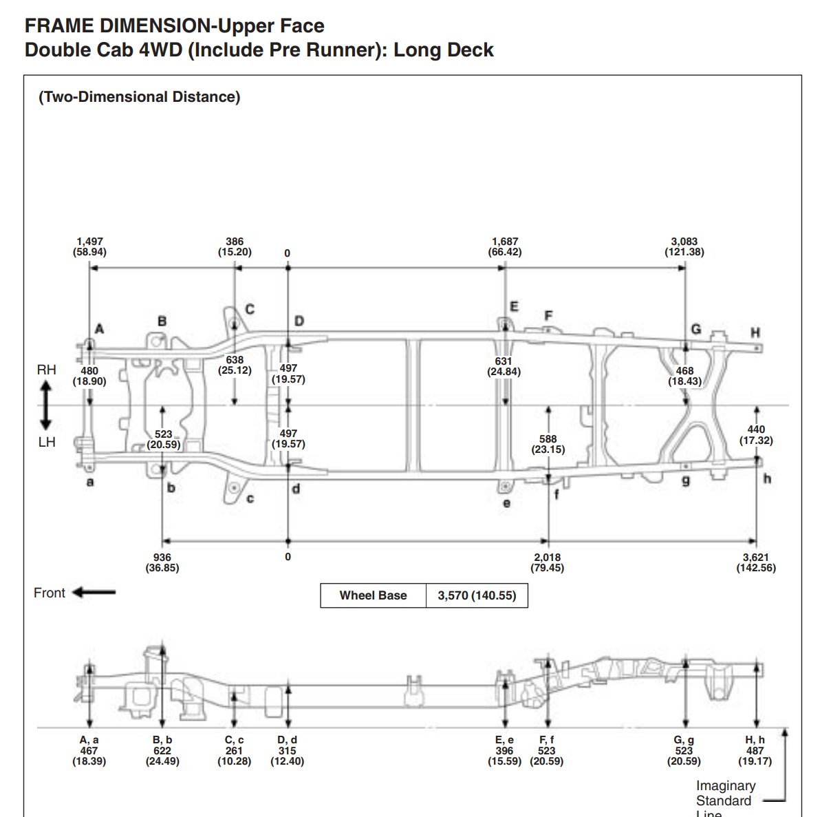

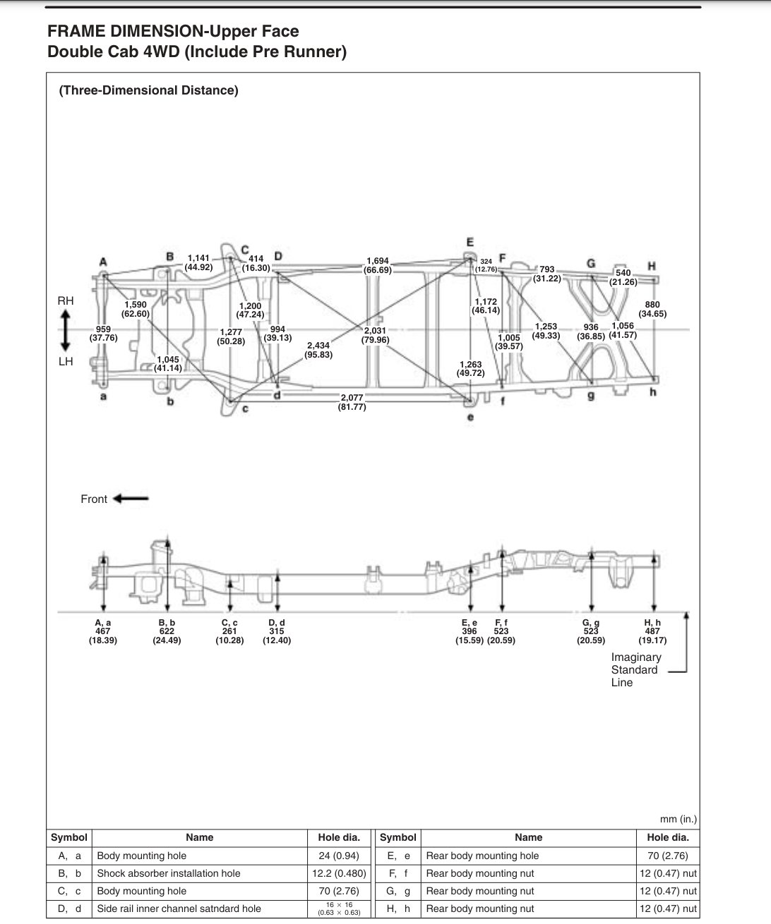

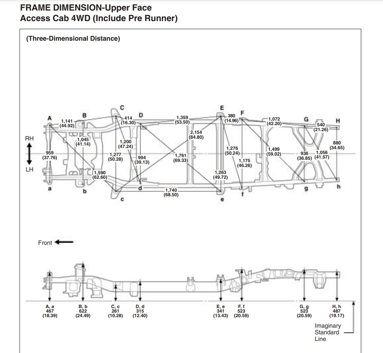

    Do the second gen access cab and double cab share the same chassis? On V6 models
    Just wondering if it’s possible to swap cabs/box

    I'd think the cab mounts are different.
    As well as the bed mounts.
    I'm going with, No.

    They are different.

    Any chance you have the spec for a 4wd double cab short bed?
