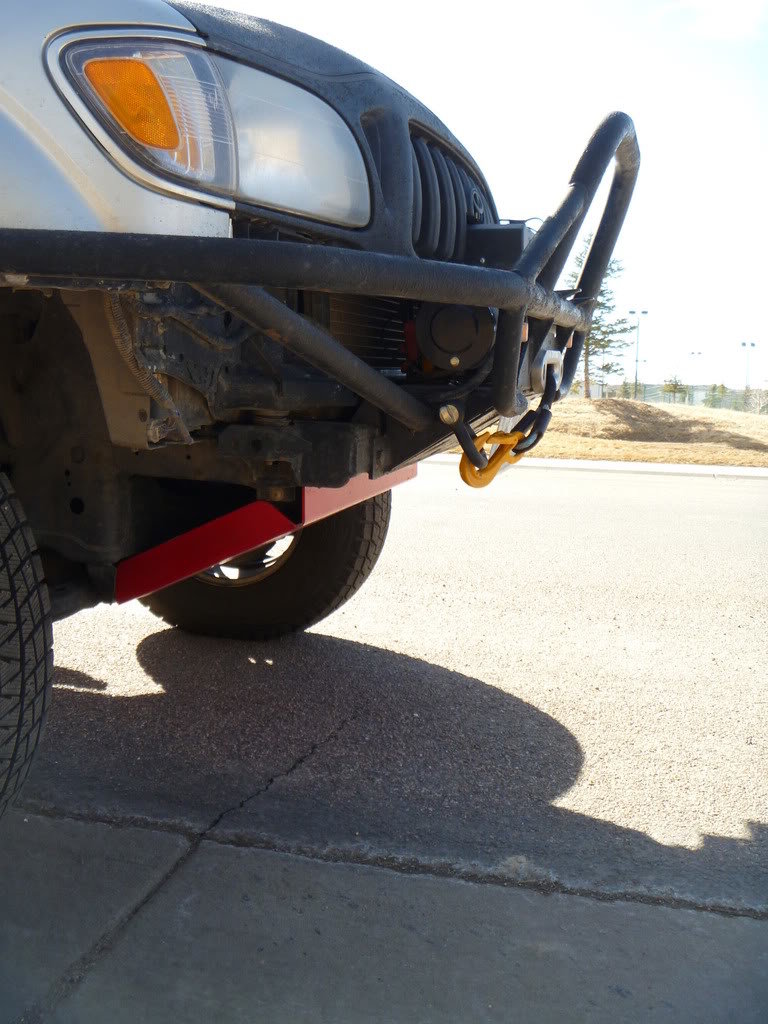

    I had my bumper installed a month or two ago. I guess I somewhat rushed into it... I asked the guy installing it to keep it "tight" and not let it stick out too much. It's sticking out almost 6" from face of grill. I like the looks of it, but feel it needs to be closer. I'd pay someone pretty well to re-do it and get it 2.5" closer to the grill. Anyone know someone in the Denver area that could help?

    They were supposed to pull those crush cans off. I wouldn't recommend pulling from it as it, it will rip that thin sheet metal right past the bolt that holds it on. you essentially have 2 17mm bolts holding your bumper onto your truck, same thing happened to me before I got all the equipment to from no on do my own work. I had to cut it off and re do it correctly, mine sits so far back I had to notch that rad crossmember behind the upper bumper bolts. I believe when I had it on my truck it stuck out like 3.5" from the grill but I no longer have that bumper. Id be more than happy to help you if you were closer! Goodluck!

    Hmm..i thought he did pull the crush cans off. He unbolted the stock cross member, and then there was some thin like sheet metal tubes sticking out that was cut off. There was not any steel tubing included with my metal (i got my bumper during the holidays and apparently they were all out), so the guy used 4" steel tubing and welded that in place as seen in the picture. I thought maybe he just used too long of steel tubing?

    The extension pieces should have been only 2" long. I am pretty specific about that as I also make sure to tell guys that the crossmember should sit back against the body mount once installed on the 01-04s

    I think I remember something about 2-3". Not at all assigning blame to anyone, except the guy who did the welding lol. Scotty, any chance you know someone that can help me out in the Denver area? If not I can always come to Fort Collins, but I know how busy you guys can be? Willing to pay of course. Thanks.

    The pieces were supposed to be 2x3 .188 wall.. Looks like he used whatever he had laying around. We cannot fix that without a new crossmember.
