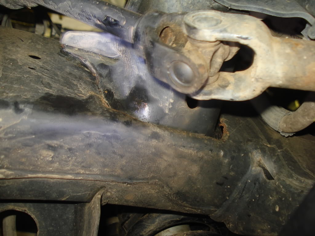

    Does the failure of the frame at the motor mount trigger a frame replacement these days? All of a sudden my engine fan is getting into the shroud and I suspect I'm going to find the mount pushed into the frame on the passenger side.

    Confirmed driver's side suspension console has caved into the frame.
    Terrific.
    Calling Toyota in the morning to speak to their frame inspection Tech.

    I took the truck in this morning. The frame failed the inspection and I am now in a rental.
    I will be waiting to see what Toyota Canada says once the dealership files their report.

    My motor mount broke this morning to. My dealership take some picture and call me next week. No rental ,and he let me go with my unsafe truck!

    Broken around the welded job, rust come from inside the frame . frame is dead!!!

    That's the exact same failure as on my truck.
    My dealership pulled my truck off the road and gave me a rental.
    You might want to call the dealership and ask to speak to their service manager and ask why you were allowed to drive away in an unsafe vehicle.
    Or, contact another dealership. Is there another one close by?
