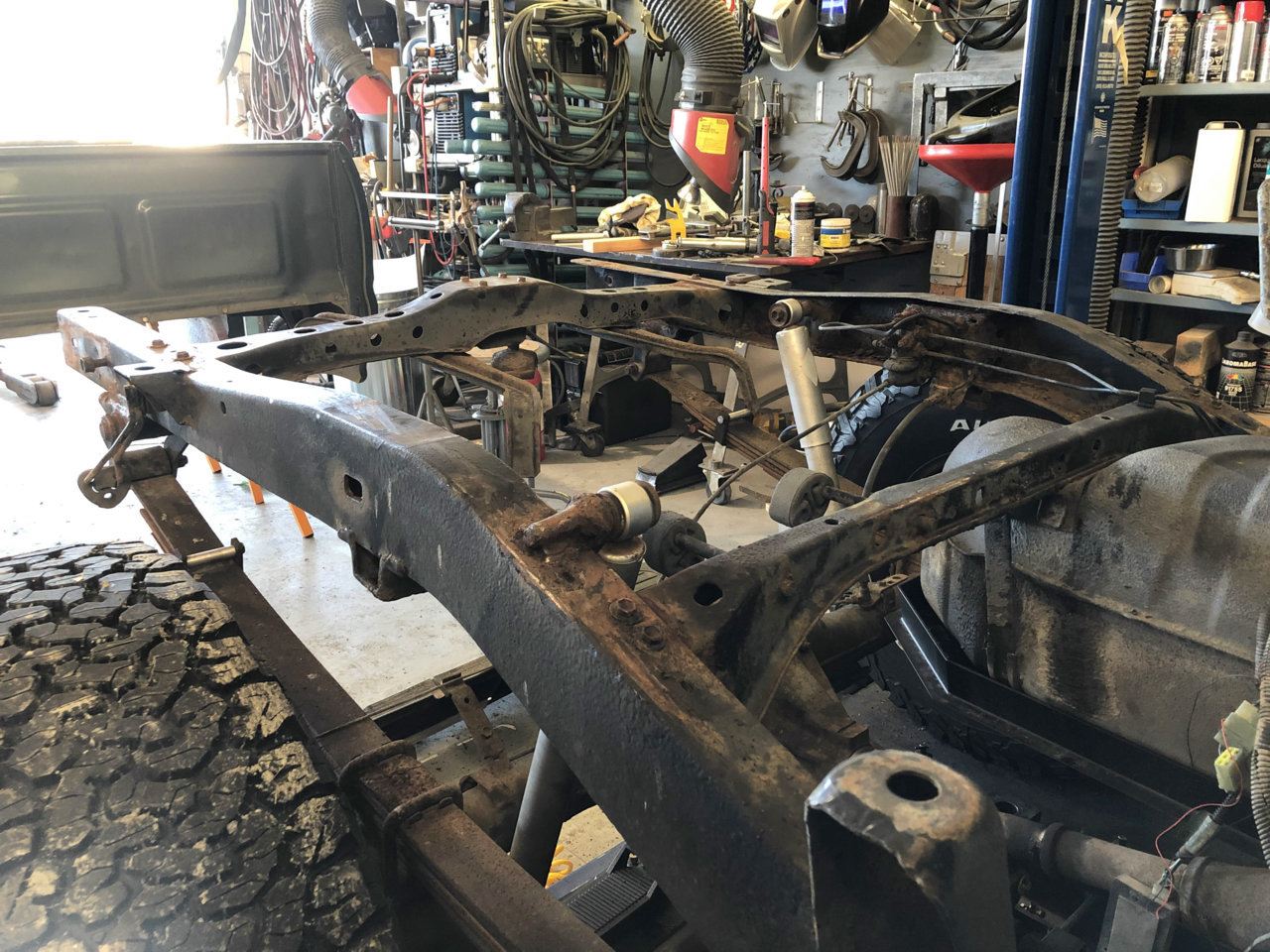

    Just posting this to help maybe debunk some questions or perhaps help people gauge how bad is bad.

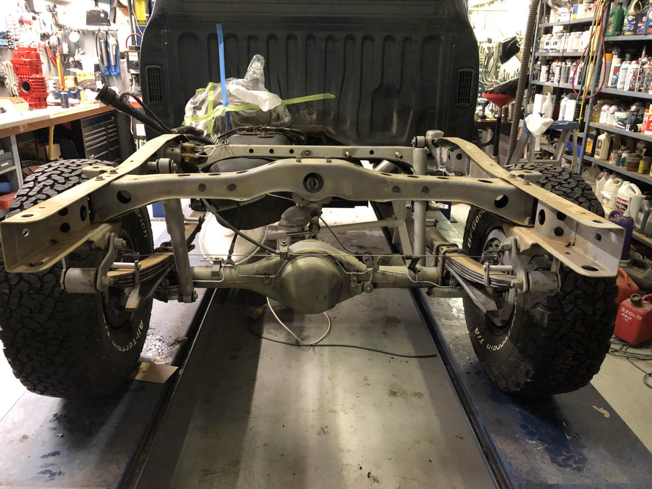

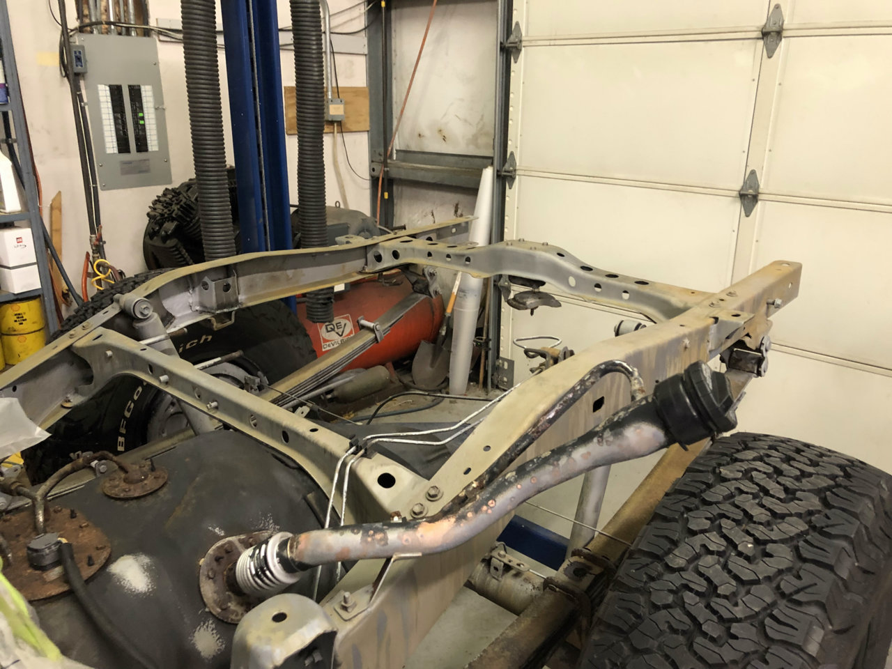

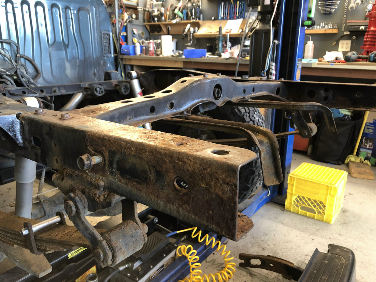

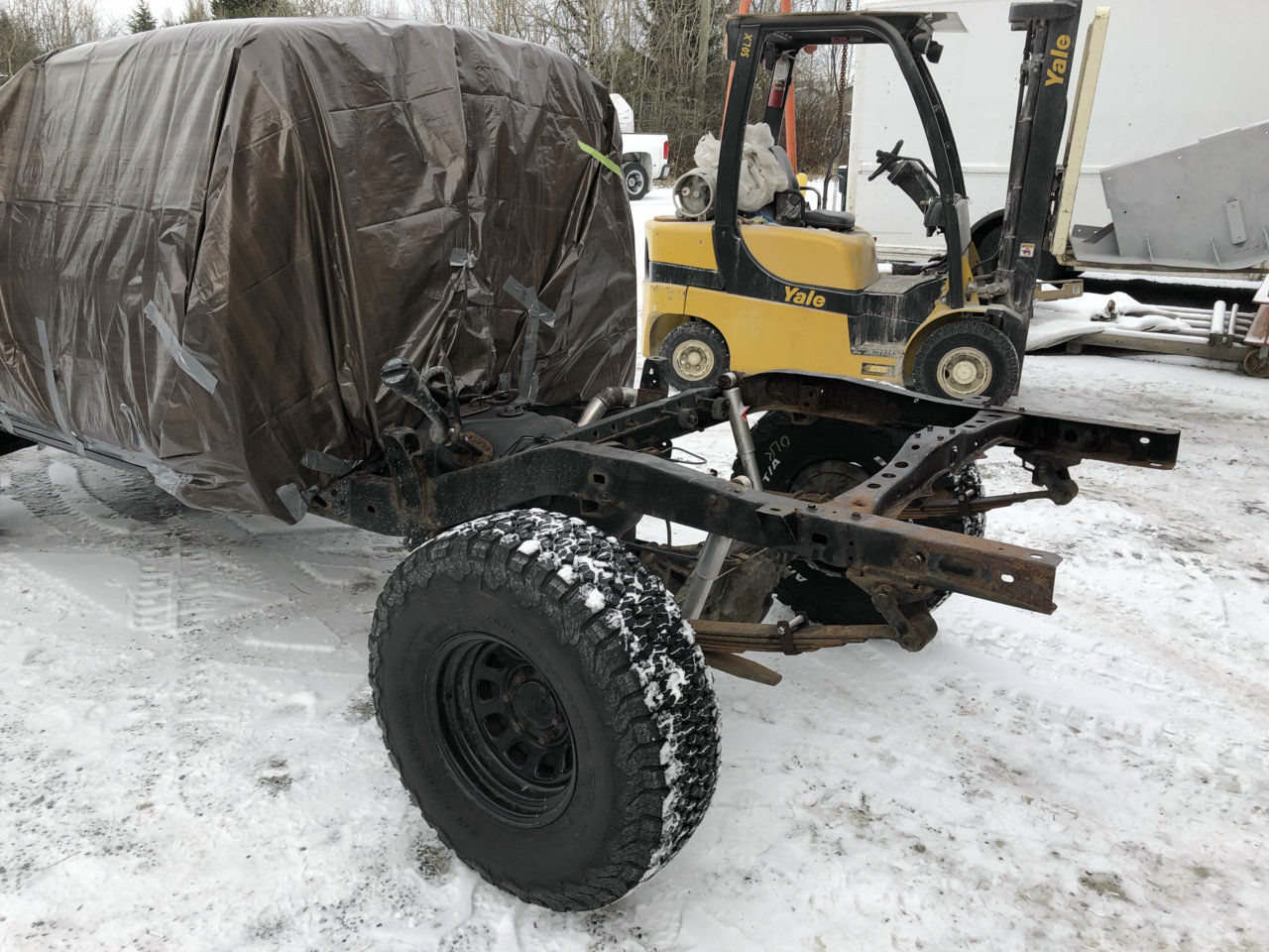

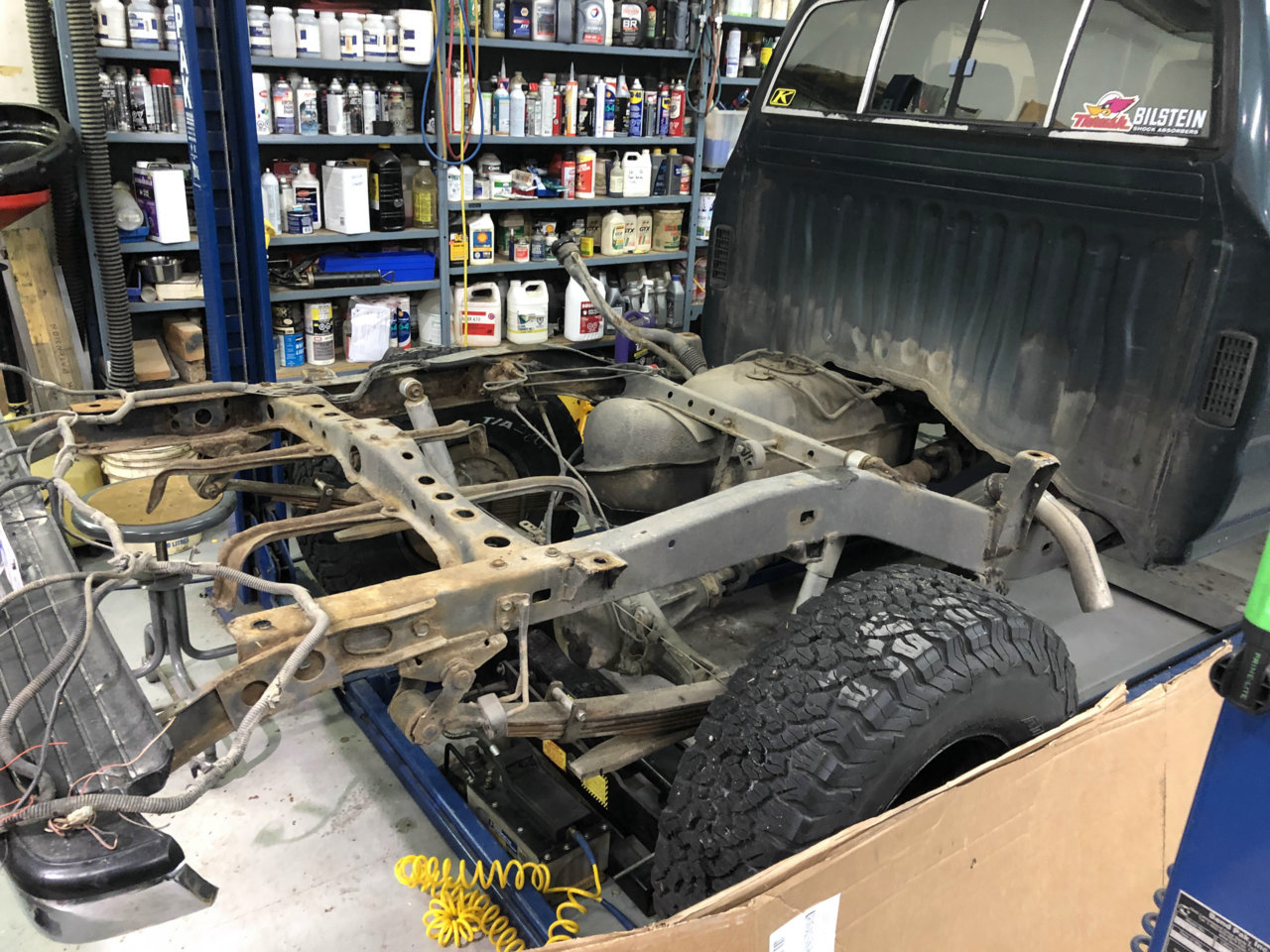

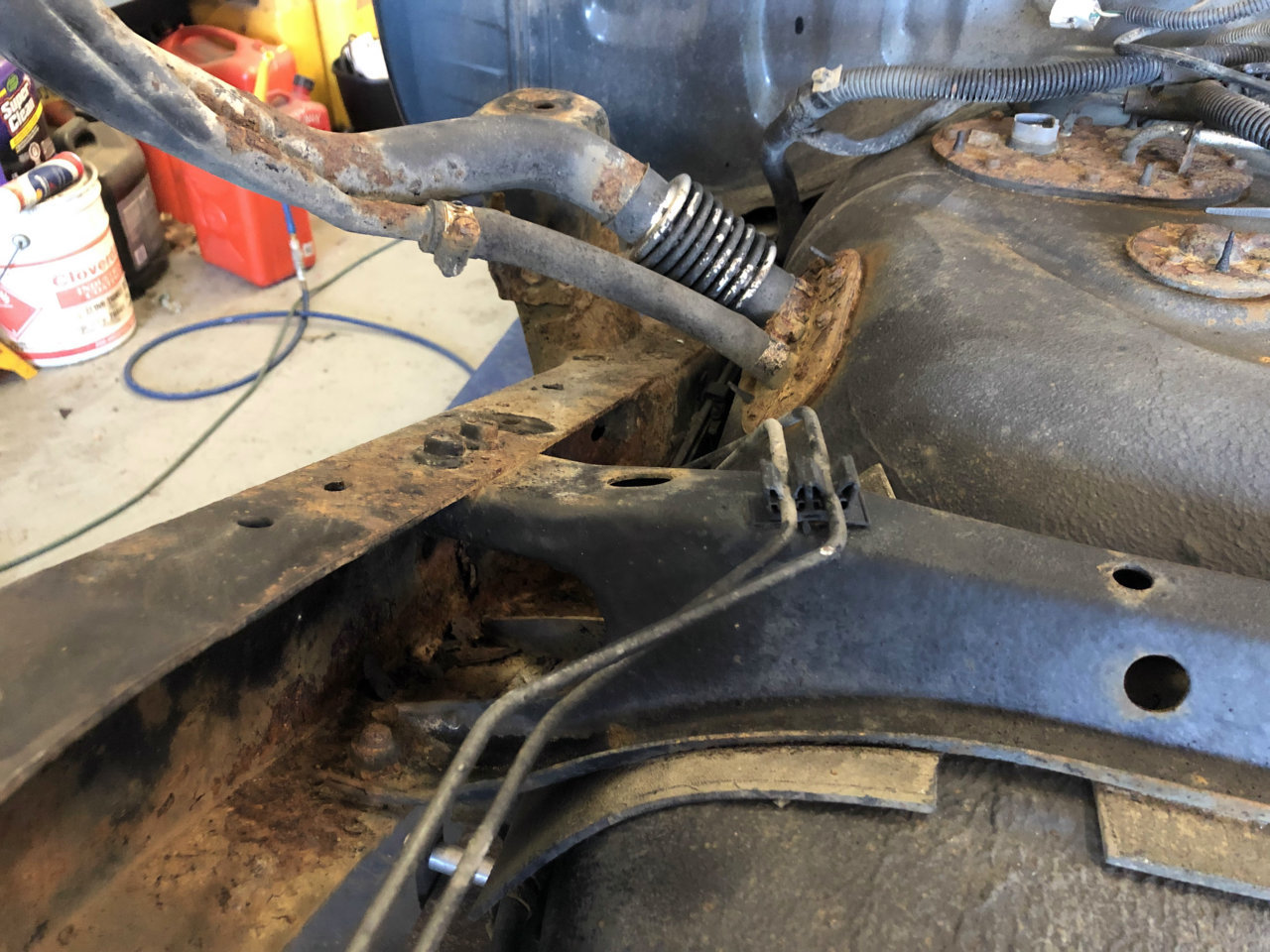

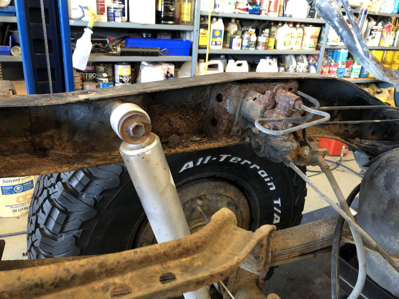

    This is my experience at least, I bought this truck cause I was told this frame was solid I couldn't see any issues at first, but once I got underneath it I some a little bit more than I was comfortable with, so off with the box.
    20B868FC-63C9-48B7-A15C-4EFCBCC4ACFD.jpg A7F2D457-4C73-40BE-B25E-0C862D80A46F.jpg

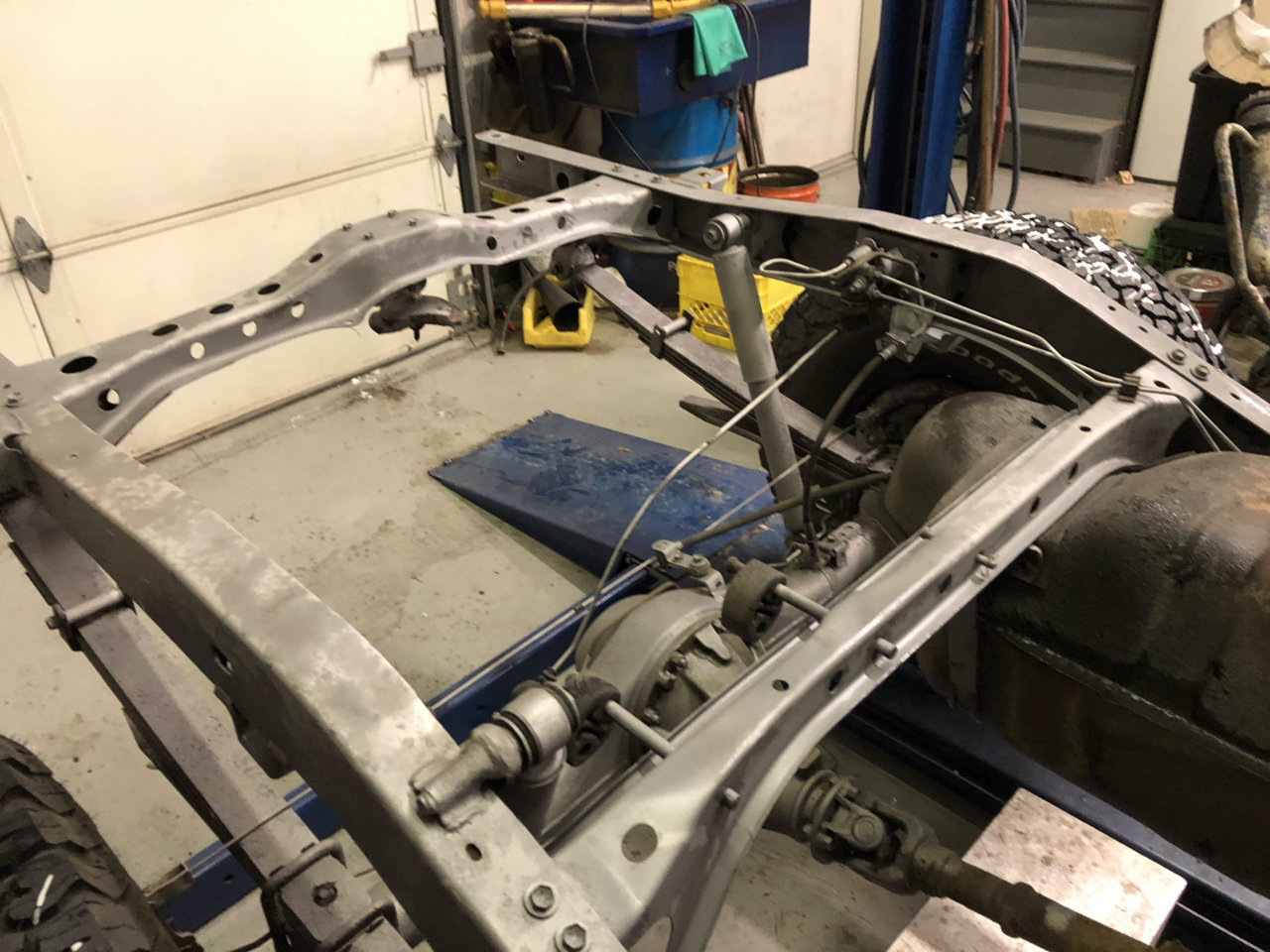

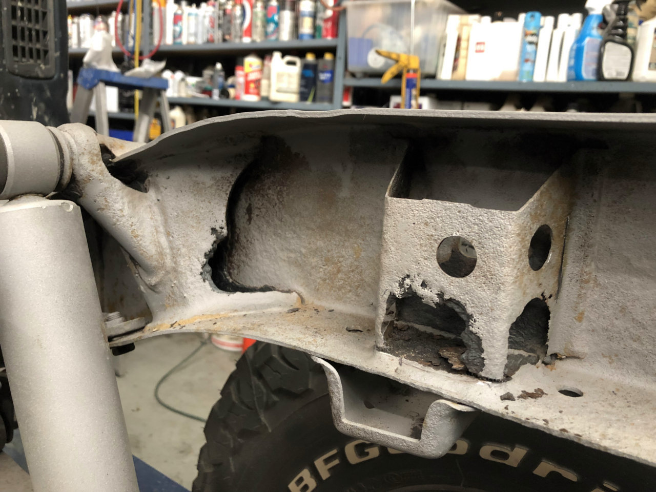

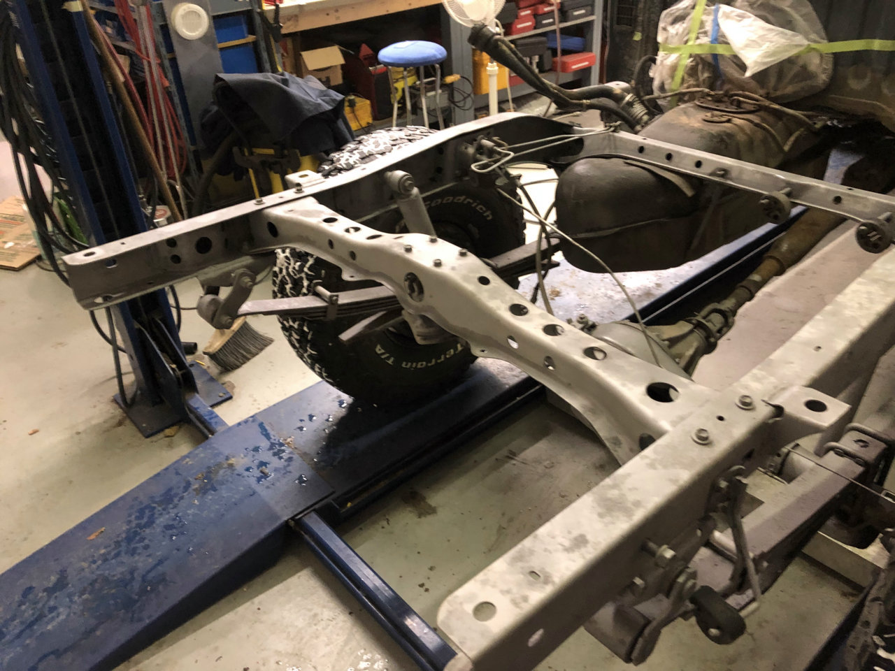

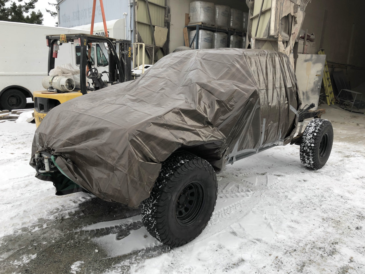

    Soo, this was what I was working with, so I started to wire brush off the preventative, and to little success, luckily for me there is a sandblasting shop locally that could fit me in, for me to do the box section of the frame cost me around 285 CAD,622F7B8B-B868-4785-8AB8-09A90FAC0016.jpgDB5F2EC8-D001-4D81-AD45-DCC80E1264D6.jpg
    F987998C-C75D-4F2A-98CD-EA37DA823D06.jpg 2BD12D68-3168-4D06-8F43-3CEBE5F35DD7.jpg

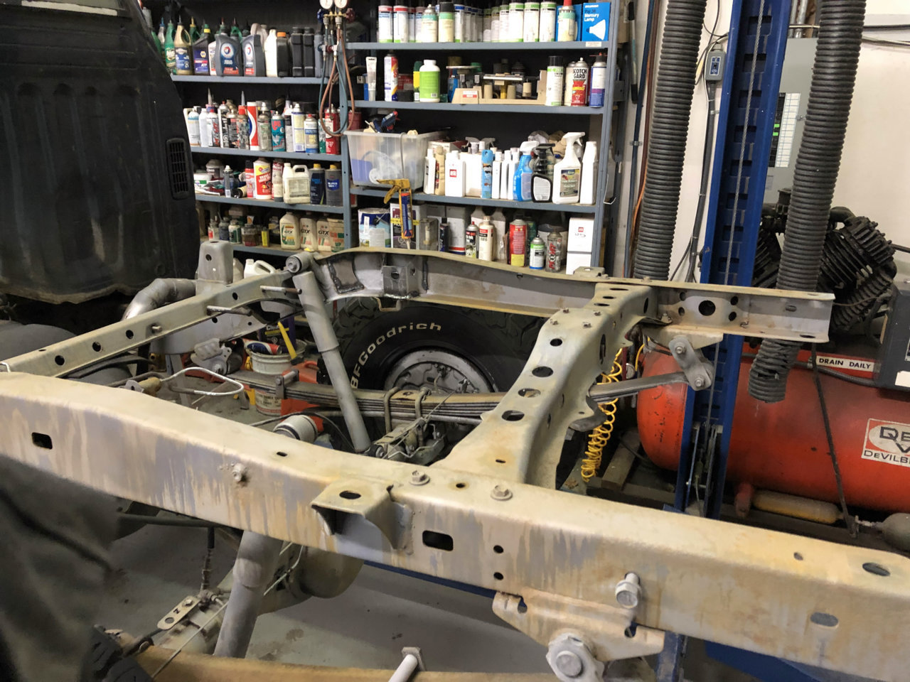

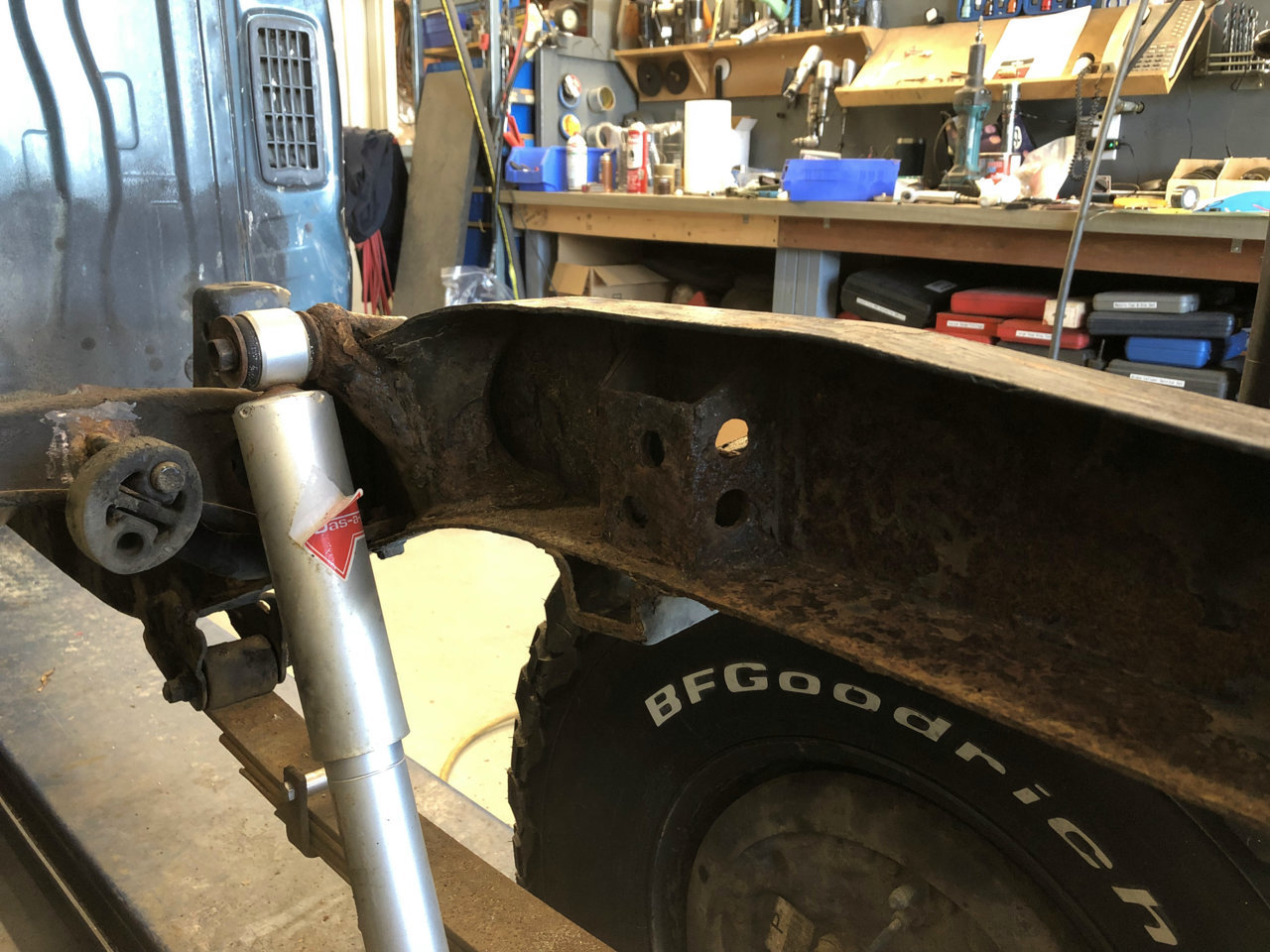

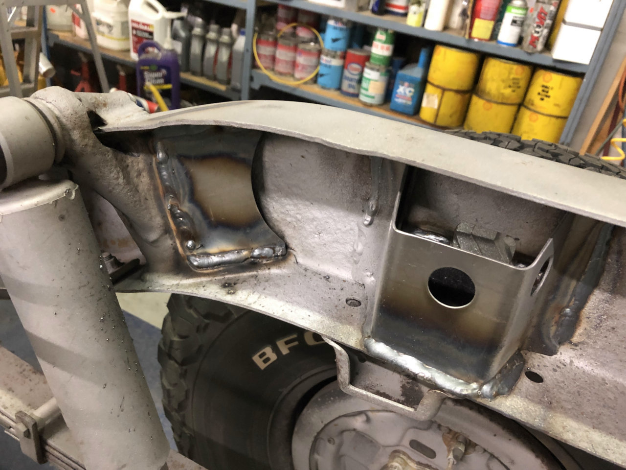

    93BA3B45-F92A-4920-A45F-8C242716D1F6.jpg so if you notice that some of the Cubby pockets are rotted away, but the main rails are bit pitted, but still structurally sound, I will also add this, some of rot will have been made worse with bead blasting, but the damage was still done. which I made a couple of patches to reinforce the sections 74E135E0-CC01-469B-8957-7C0F6DEE65C6.jpg
    2EC4F2C4-EBB1-4A6B-8873-17DDC0E1A02B.jpg A86E3752-EE57-4279-B768-82EBB0A0AC53.jpg 1E198AD8-D519-4C9C-B297-8CBB4C4B9833.jpg

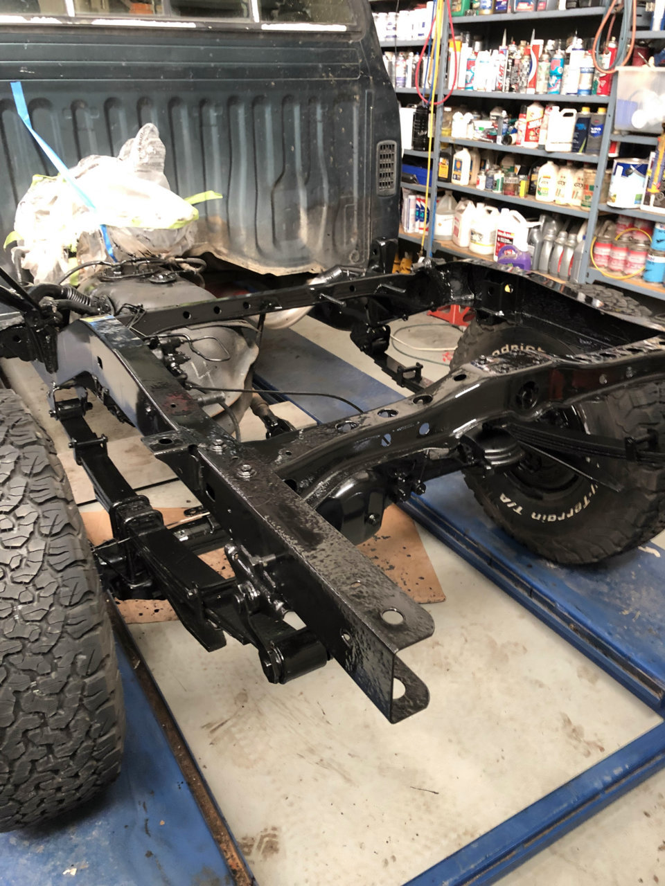

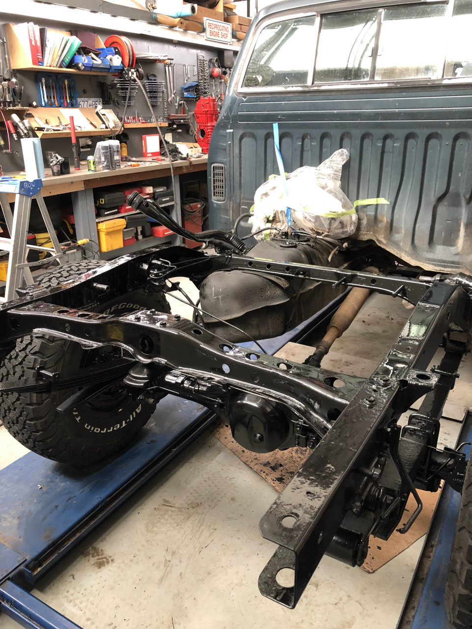

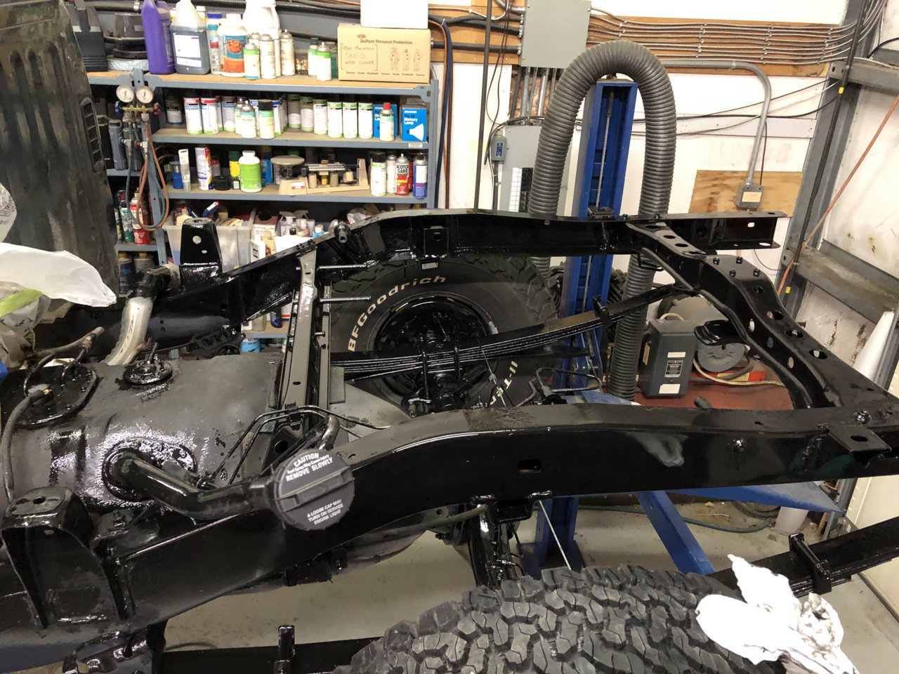

    At this stage the frame is cleaned up repaired I now have started, to prep the frame, diff, and leaf springs for POR15 Application, so degreaser,metal prep, and paint and ill follow it up with Cosmoline to add on top of it.
    92411A92-EB85-4F79-A919-0B1F7BD29F6B.jpg 71B1BE42-E6E4-4D44-8776-F17951FCBB07.jpg F696469D-FC51-4634-B5FF-12700FDF2D2B.jpg 517EF953-C149-48CE-84B9-5D020F6D6C75.jpg

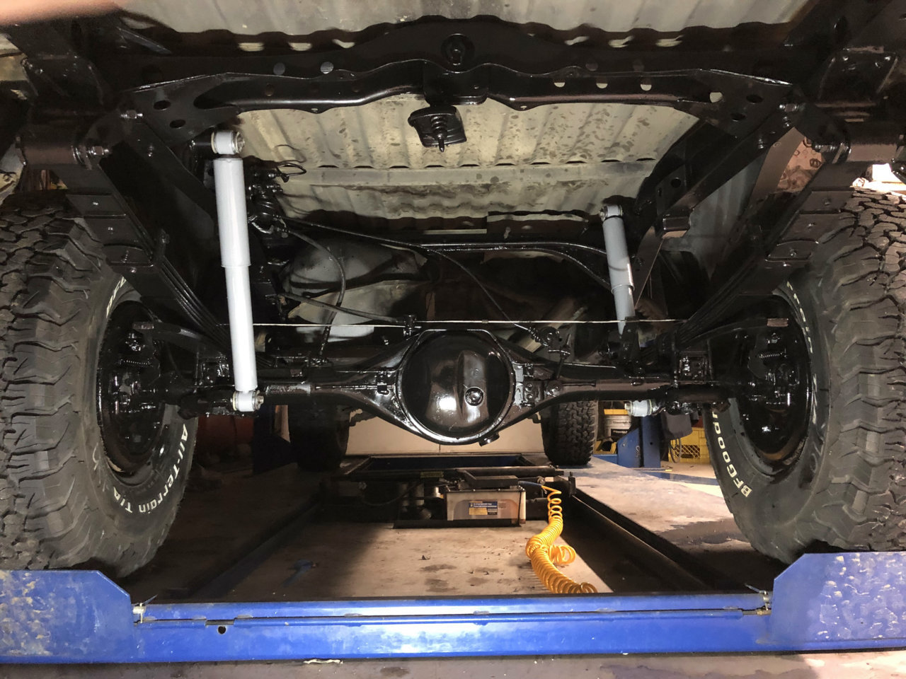

    Fully reassembled, POR15, Cosmoline applied
    What I can say is its a lot of work but it will surely last if you take your time to do it right, POR15 is incredible product, it applies super easily and flows out easy to make a beautiful finish and unbelievably strong paint.
    Even this clean frame had a bit of rust to it but it was like the add said after I got through the worst of it was still solid.
    So I hope this helps those who maybe questioning whether a frame is solid or not, and which areas that might go first, on mine it was primarily where the shocks mounted and pocket sections and one spot where I was starting to go was beside the fuel tank on the inboard side.

    Nice. I would say you are good to go, now!

    Nice job you were lucky you got to that quite early another Winter would have been lots more work.

    Looks fantastic!
    keep an eye on those shock mounts,
    They are the worst design for collecting water and dirt in them and tend to rust through the frame because of the
    poor design with no drainage and you don’t see these area as it’s hidden.
    I ended up cutting out the complete shock support section out so there is no cavity there, it’s all open space
    for water and dirt to pass through and added trail gear supports in that area.
    The shock support is totally open now,

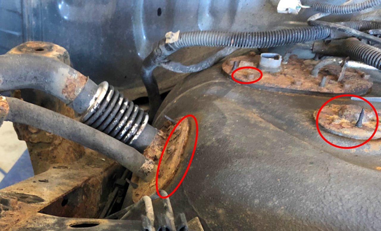

    Replace all those brake lines, and that block. Also the gas tank area with heavy rust might wanna replace that. Nice job on the frames.

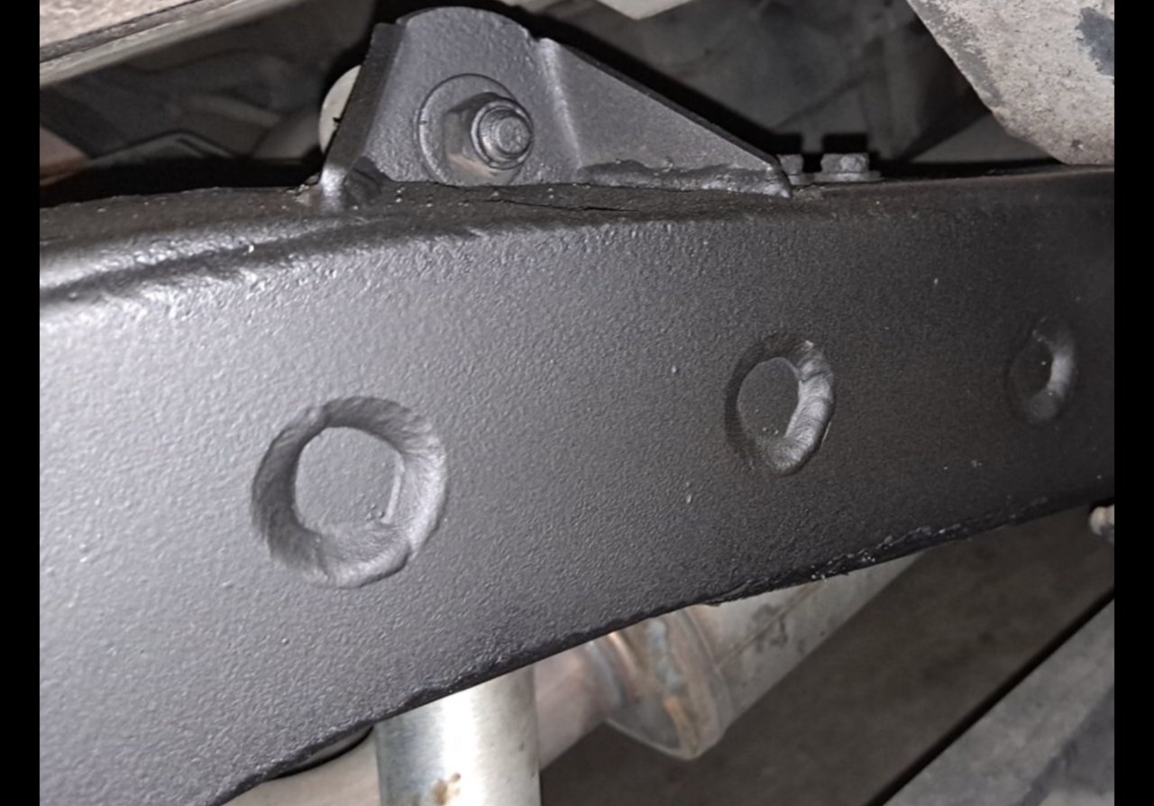

    Did you topcoat the POR-15? The standard stuff isn't UV resistant -- it'll get dull and chalky with exposure to direct sun and eventually come off. With a topcoat -- almost any topcoat -- the stuff is practically indestructible.
    Most of your frame, of course, isn't going to see sunlight and will be fine. The arches over the rear axle might see UV, depending on where you live and how you park.

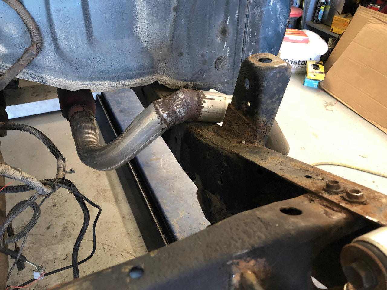

    I would definitely address the fuel tank filler gasket. They get hard and crumble resulting in a fuel seepage. Your's looks toasted.
    The fuel pump looks original. I'd replace that unless you don't mind dropping the tank or removing the bed again in the future. Those bolts are notorious for round off and/or breaking. Soak and let set. I use small vice grips and go slowly.
    The housing on the right there has a small vacuum shutoff inside. The dome on top and the hose connection tube both rusted off on of my trucks. I could not find one to buy (don't come with new tank) so I had to make one.

    @jruiz555, thanks for the suggestion the maintenance has been piling up abit just got the truck in November so been tackling all the rust issues first, but i will be doing brakes and fluids soon
    @4xdog i just used the standard kit of POR15 no top coat, for those areas with UV i coated in cosmoline which is a waxy like substance hoping that will pick up where POR15 lacks
