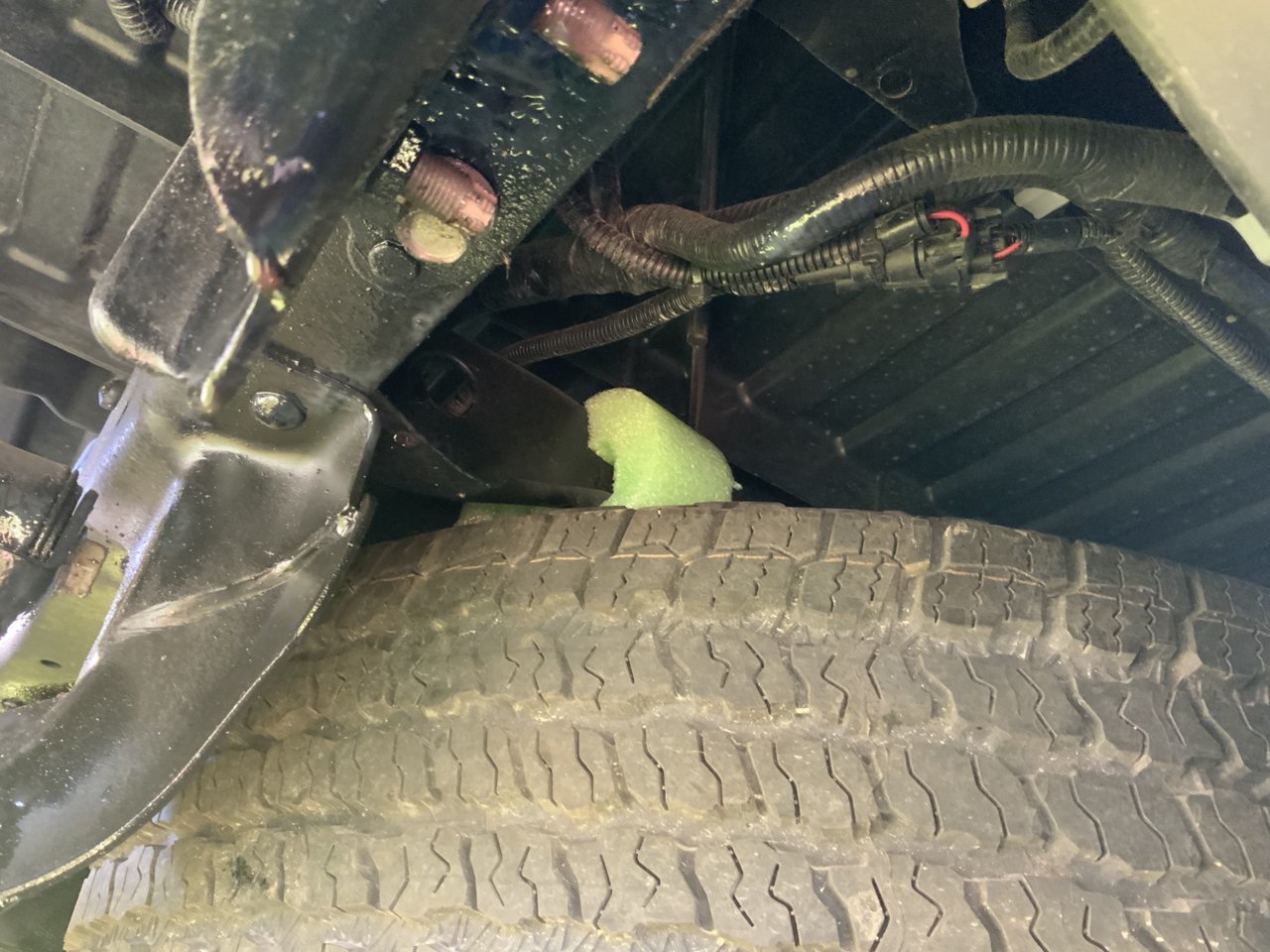

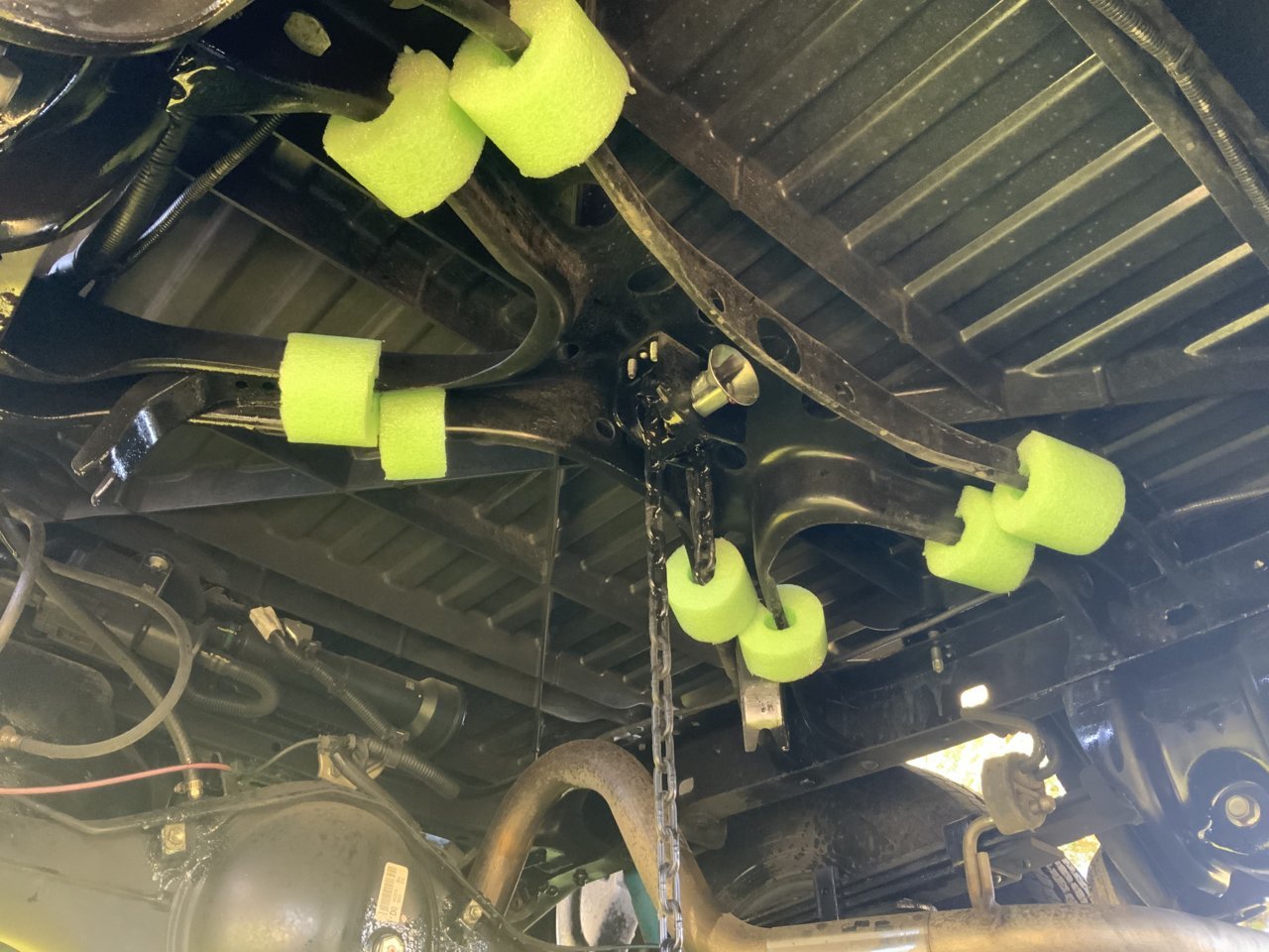

    There are two threads discussing this same issue. On one of them someone suggested using a pool noodle. I am giving it a try.
    321BD2FE-D3A7-4545-AAAE-6E4444C02941.jpg 7C3FCBBC-27D6-4AAE-B222-CAE4D885FA66.jpg

    I just dropped my spare in prep for undercoating and noticed the same thing. Only 1,500 miles on it and large indents already. Putting new tires on next Saturday. Will have to sacrifice a pool noodle. Good idea!

    Wow. Nice thread revival.
    I first used a donor tire and cut the sidewall out of it and put it on top of the spare. Worked great, but caused the spare to hang about an inch lower and it was noticeable enough to bother me.
    I now use pool noodles, have for about a year and it works great
