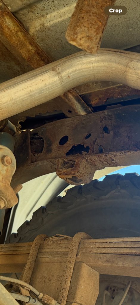

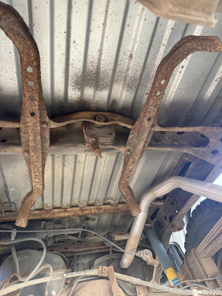

    Glad you had it checked, its 100% not repairable. Walk away.
    I can't stand people posting this AFTER the buy the damned thing.
    It's not critical at that point, but indicative of the rest of the frame.

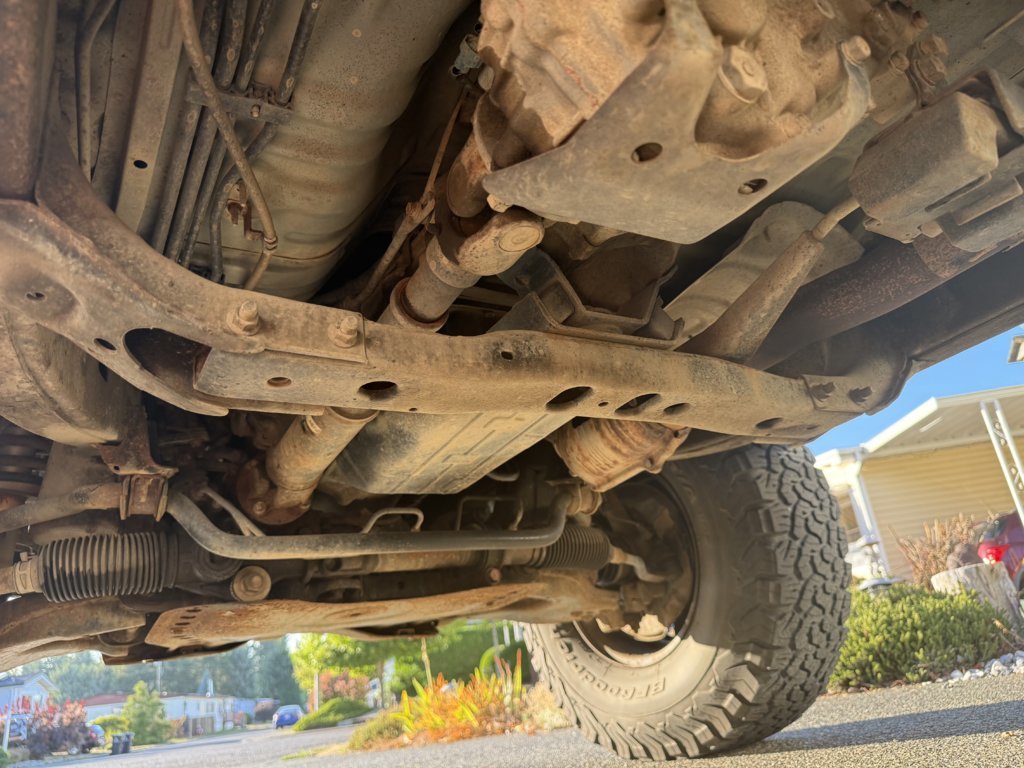

    More photos - struggling to upload haha

    Appreciate you guys - life savers. It's a 4x4 4 Door, super rare around where I am located (Canada) with only about 150k miles. Is there a price for y'all where you think this could be worth it or is this a value my life and move on type of thing haha. You guys are the best - happy the internet exists.

    I can't see a situation where that is worth anything at all. I wouldn't touch it

    If its east of manitoba, fortget it, all the 1st gens in that area are worthless now.
    BC is ideal, but in Alberta where we are we're seeing rust like this and its hard to spend over 5000$ on something that could turn into scrap metal one day.
    I would wager the truck you are looking at is $12000-14000 CDN

    It's by far not the worst posted here... but it's toast. To the right person, that truck might be worth something, but they'd be buying it knowing they were going to have to rebuild the entire rear frame, or maybe buying it for a (relatively) low milage engine.

    Tell them to part it out. It’s not even worth a frame replacement. IMHO

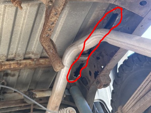

    1) This specific spot below is definitely bad and in need of square tubing (plate) welding repair. That specific spot has corroded out because there was no "weep hole" for moisture to drip out from inside, it is close to the hot exhaust pipe, and gets spray from the rear tire. That's an easy $500 repair around where I live. Easy repair. And, no, a frame repair such as this does not need anything like to be stress tested or anything like that. Or recertified by anyone. Just stop. A quality welding repair with flat plate is all that is needed. This is plain carbon steel. MIG or TIG or stick weld.

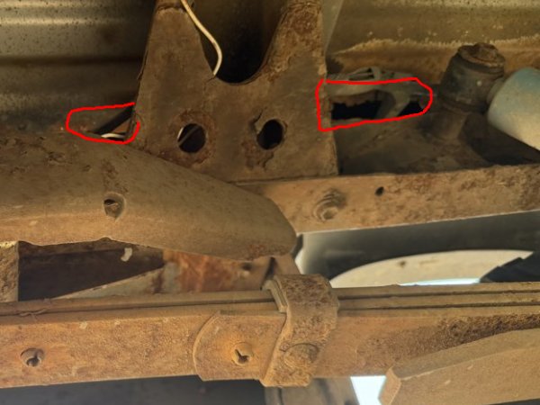

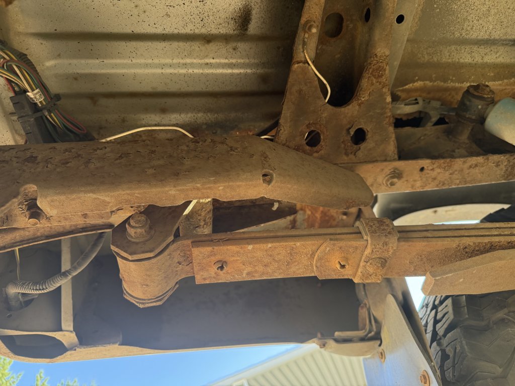

    2) This particular spot on top of the rear leaf spring, between the u-bolts, is called surface delamination. It is flaking. Because water (moisture) gets trapped there and causes what you see. However, one can easily also see the leaf springs all still have solid integrity. Ditto the u-bolts. The overall layer of rust is - at this point - considered to mild advancing surface corrosion. Those u-bolts can be easily removed and that area touched up. Those are $10 ubolts. The leaf springs can be pressure washed and treated with Fluid Film, WoolWax, or Cosmoline to mitigate (stop) ongoing corrosion.

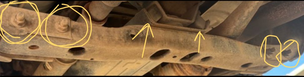

    3) There is absolutely nothing wrong with this structural member. All four of those nuts are easily removable by anyone with grey matter between their earholes. Look at those bushings (arrows). Nothing wrong there. Surface corrosion. Yeah, you bet. Is that rotted? No way in hell. That can also easily be removed and cleaned off with an ordinary pressure washer and treated. Just stop with the "fracture or tensile strength will be reduced nonsense". OK, fine, It might be reduced from something like 10 tons (20,000 lbs) before it folds to 9.5 tons (19,000 lbs). For those of you cackling about such a reduction, I say this -->
    If that structural member fails, after being grit blasted with baking soda or pressure washed and then treated with a rust inhibitor, one has WAY more serious issues to contend with. Like your truck was PANCAKED between two fully loaded semis. And the rescue crews are using vacuums to suck the remnants of your body out of the cab.

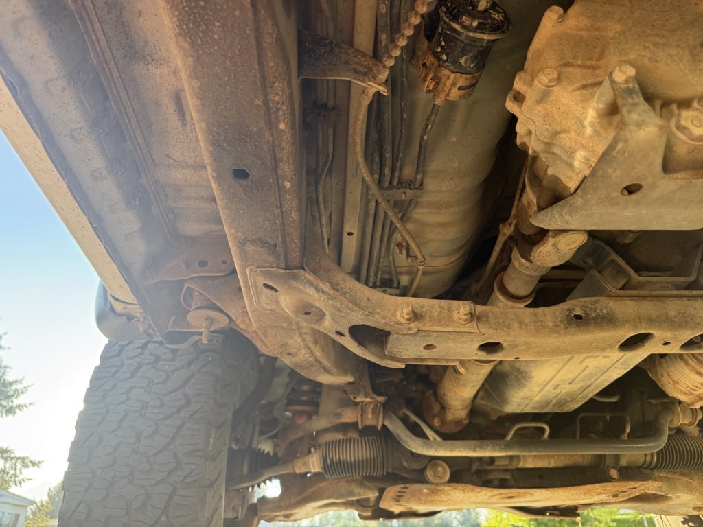

    OK the spare tire is missing. But that bracket is still treatable. Or replacable for $300 or so. Is anyone even looking at the floor pan and exhaust? They are fine.
    5) The power steering rack is leaking slightly.
    6) The U-joints need to be replaced.
    7) The pics that show the floor pan all look A-OK.
    YES. This truck needs TLC. Is the frame "toast"? Not in my opinion. If the price was reduced from $14k to $6k, it may still be worth consideration.

    I was leaning towards this train of thought, but my issue is, this is what we can see. The other critical spots are not shown and its likely been passed on by other potential buyers for its price to be reduced so much.
    Like you spotted, once I see the metal splintering/spreading, its a big concern, and its what we saw kill most of the 2nd gen frames.
    An inspection would be a good idea, but I feel like its hiding much more.

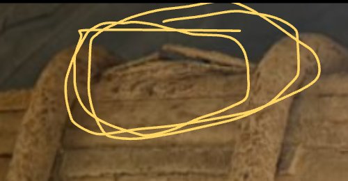

    All the mental gymnastics and it's wrong. There used to be a bumpstop there. The bumpstop backing plate broke off due to rust.
    Also the bed has large rust holes on both sides, basically scrap.
