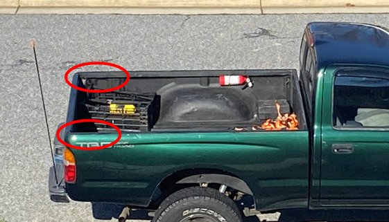

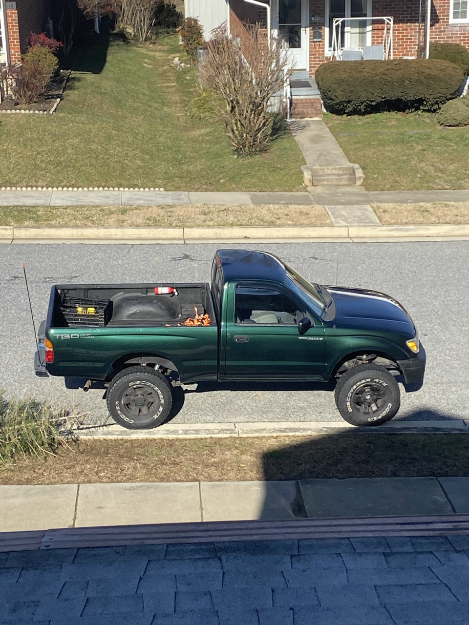

    Time to address the elephant in the room. My 99's frame is bent, which I just recently noticed. Really upset about this. It's bent evenly right where the bed meets the cab. The gap between the cab and bed at the top of the bed is much larger than at the bottom (Will include pictures). I have absolutely no idea what happened. I believe that the frame bent before I repaired the few rust spots around the leaf spring hangars. Maybe I overloaded it? Don't know. TRUCK HAS NEVER BEEN JUMPED.

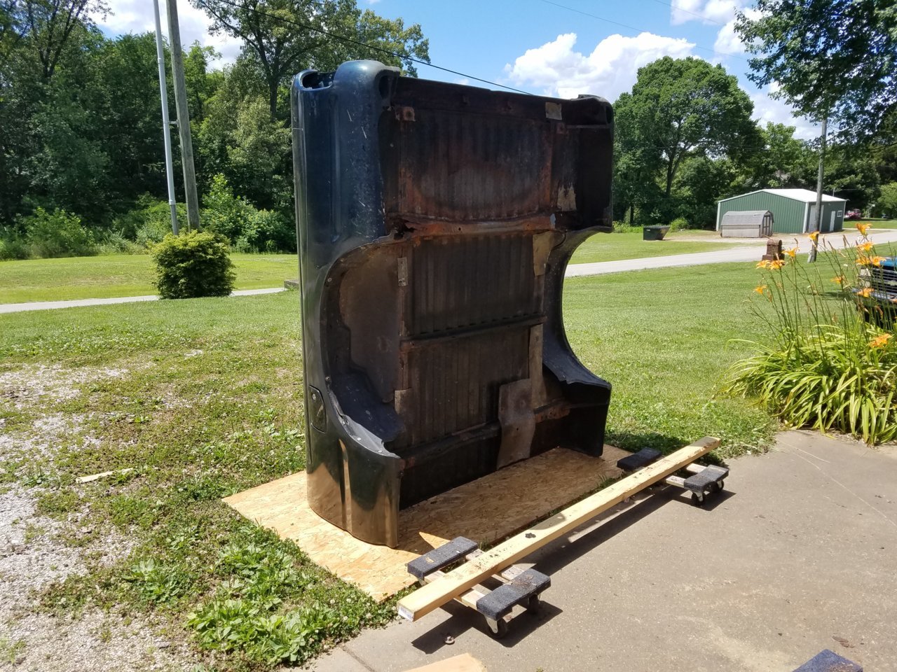

    if you are sure it's intact, and that when you repaired the frame it wasn't mis-aligned, I would get a friend and each grab the bed at the red circled areas and lift. As someone already said, possibly your rear bed rail under the bed has rusted and collapsed.
    This is the bed I pulled from one of my trucks. See those rust holes at each end of that cross member? Those are the mounting points.

    -Bed is in great shape. Minimal rust. We will try what you said but I don’t think that’s the issue.
    -I am fairly certain the frame is not broken. I’ll crawl under the truck tomorrow to confirm this. What I believe happened is it bent before the rust was repaired, so when we repaired it, it solidified the bent shape.

    And to be clear, is the gap between your bed and cab even or not?

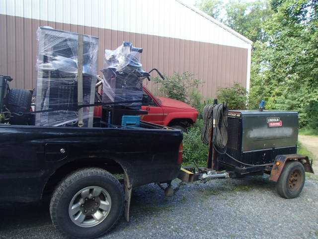

    about 3" at the top 1/4" at the bottom between the cab and Bed

    Mines probably 2” at top
