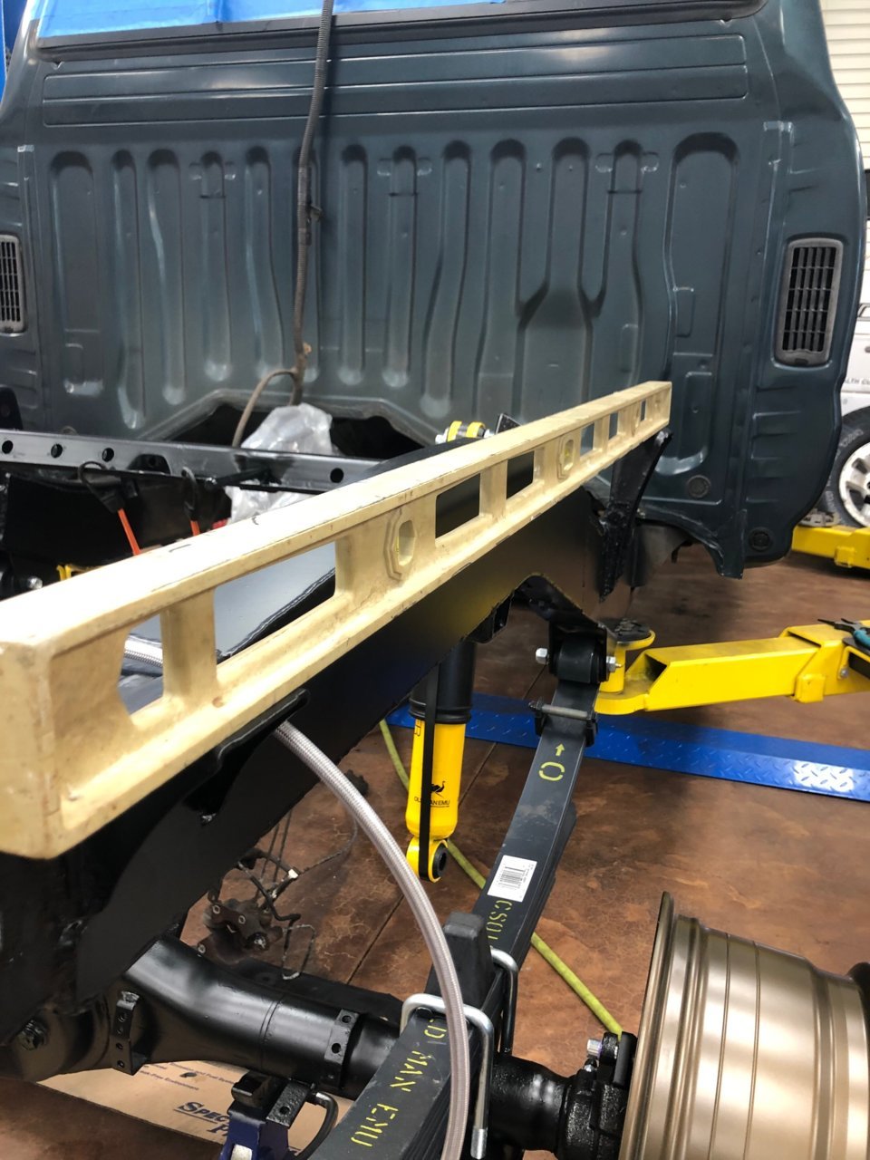

    Probably not bent. When you welded on the frame, the frame pulled/warped down. Mine did the same. Shim the box and worry about something else on a 20+ year old truck.

    Throw a straight edge on the frame you’ll know if it’s bent pretty quick.

    That really won't work. Too many bends in the frame to begin with.

    Would work if we’re talking about a horizontal bend but it’s a vertical one

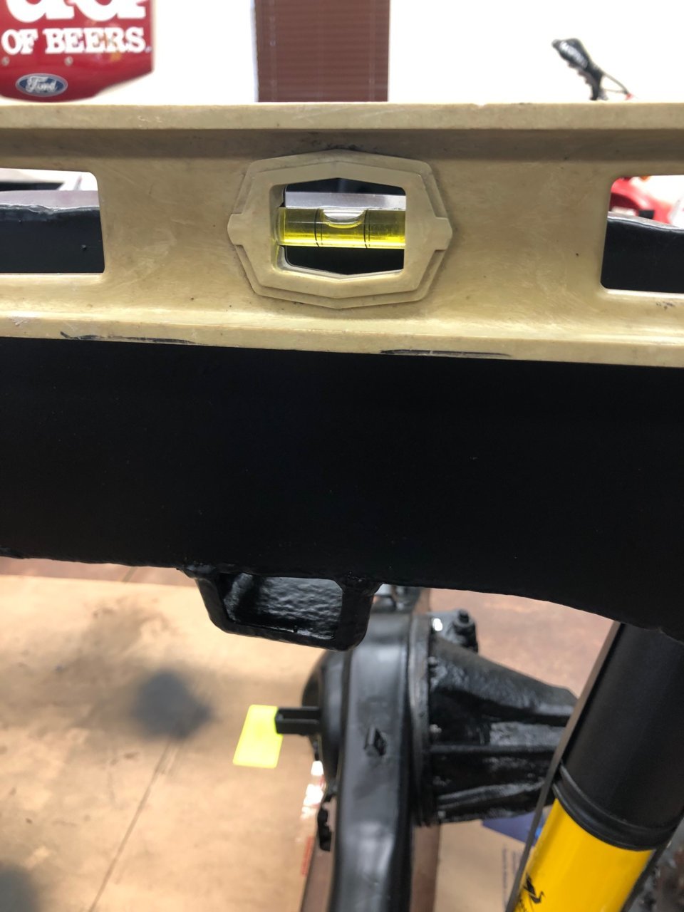

    A little late to respond here but when you did the welding on the rear of the frame did you happen to run a level between the front bed body mount and the middle bed mount? That may tell you all you need to know. When I did the repair on my frame I kept a level on both points to make sure it didnt wonder out too bad.

    No... I did not level the frame lol. Guess it is what it is. Time to box it and shim the bed I guess.

    Yeah that wont be too bad of a job to straighten out at least.
