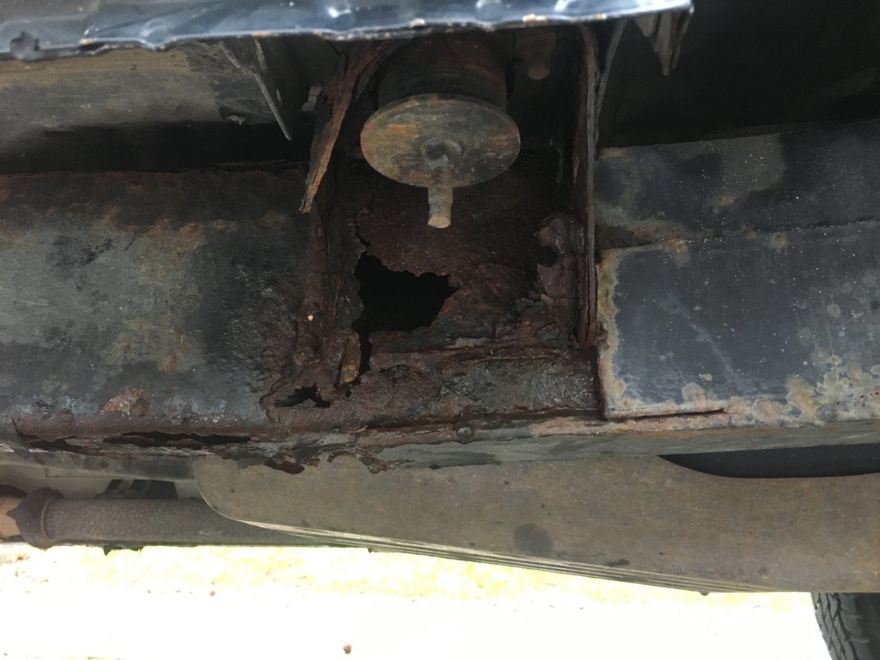

    I just bought this Tacoma (2001 Xtra Cab 3.4 4x4 MT TRD SR5) from a used car lot in MS and I recently discovered the frame is cracked almost all the way through in front of the driver side leaf spring. What do I do? It already has some patches on both sides so it looks like it would be hard to properly instal the safeTcaps. I don't have any experience welding either.
    Its a one owner truck that runs great and I have zero problems otherwise. I just can't believe I was sold this! The crack was covered with paint and mud when I bought it. The title says it was turned in at a dealer in IL and the Lot I bought it from bought it from the dealer. It was taken to a dealer in 2014 for the rear tire carrier but they didn't do anything about this. im feeling pretty screwed. I only work as a bartender and basically emptied my bank for a reliable ride to work.

    That really sucks... they should have disclosed that to you. Take it back to the dealer you bought it from, if you just bought it, it has to be still under warranty from them. It might still qualify for Toyota’s frame replacement as well, I would check into that, which would be awesome, getting a reliable truck and a brand new frame. Good luck

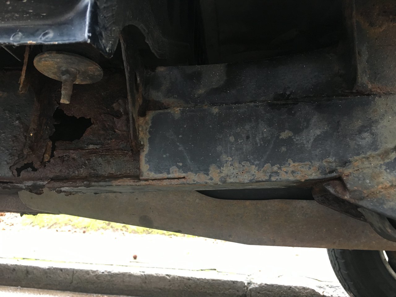

    That needs to go back, it has been previously plated to cover the rust too, look at those squareish pieces, those aren't stock.

    I called Toyota and they said that it was not under warranty and there are no recalls issued. It is also not under warranty from the used car lot. Toyota said a new frame is about 6,000 dollars just for the frame. I WISH I could get a brand new frame. I just don't have money like that. I would even do the labor myself if needed. I have done an engine swap. :help:

    Take it back, and either get them to replace the frame on their dime or get your $$ back. That frame is toast, and if they even looked at the underside of the truck then they knew it when they sold it. If they don't want to play ball, lawyer up.
    Don't accept any offers to 'repair' the existing frame, either. If it's rusted through there then it's probably got a bunch of other spots that are paper-thin as well.
