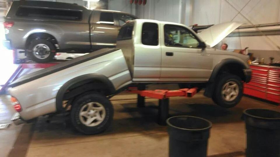

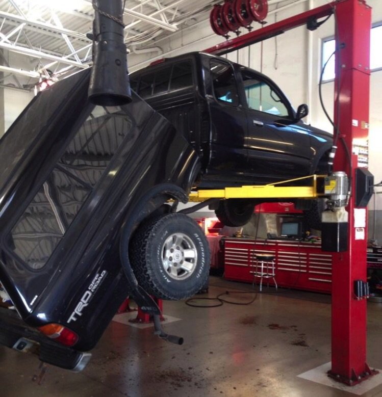

    EFCFFFE6-6BC4-43BF-BFD4-2DB083FF9E85.jpg 1C968363-6DA4-4C18-8FE8-CEF42E08D83B.jpg 9A49684C-E0E8-4D5B-90F1-2B879DDBE8E5.jpg
    Poor 1st Gens! And to think that some 3rd gens may go through this all over again…

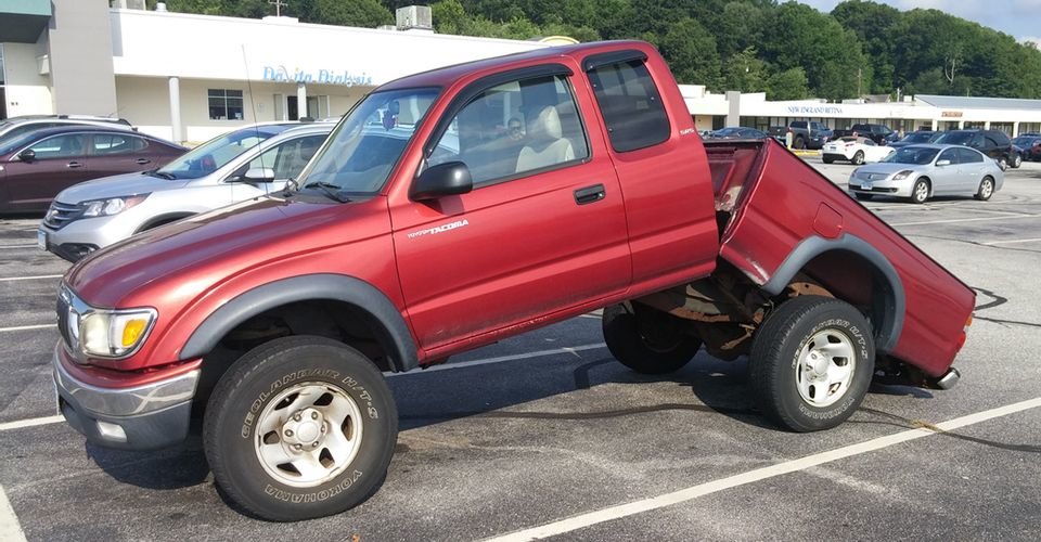

    08 TRD Off Road
    Toyota frame issues fixed...
    JCGarfunkel, Sharpish, Burns and 3 others like this.

    Nothing wrong here, it’s just the dump truck option improperly deployed. Another case of not reading the owners manual.
    ExhiLuxPA61 and Finn-2187 like this.
