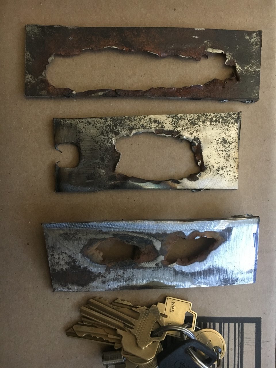

    After several inspections, turns out that that it’s stil structurally safe and that the bend came from the heat being applied directly to the weakest spot and the liquid metal contracting. Going to either correct the angle and add fishplating frame the bumper to under the cab (cheaper option), or just live up to the rebuilt title, cut off the ass end and rebuild it with 4” boxed steel and create a flatbed with a cage for racks/rooftop tent/or an enclosed sleeping & gear space (more badass option).
    Also, the pieces that were cut out obviously show rust damage along the bottom face of the frame, but from around the weak spots, the metal returns to nearly full thickness. And the internal side walls of the frame looked pretty clean wth no flaking rust issues.
    40F4A94D-DE82-4AB7-ADCB-17D39CC715E6.jpg A6ED6E10-2E65-4385-8A49-0B755A417F2C.jpg
    One piece showed thinning up to almost the side of the frame, but it was right in the middle of the longest stitch and everything up from there was bomber.
    That rear end still leaves much to be desired and the frame isn’t great, but it’s a long ways from dead. We can rebuild him! That previous strengthening plate may have actually exacerbated the frame’s natural weak point, where it comes out from under the cab and turns upward to go along under the bed. Creating a pressure point at the front and rear ends of that plate. So I’ll be getting all that fixed up one way or the other!
    Someday, when I have an enclosed garage space, I'll look at swapping onto a new frame just to have a project. But until then, I’ll make it solid.
