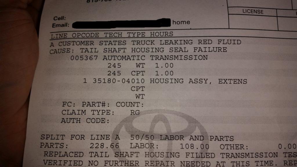

    Here is the description of what was wrong and what they replaced.

    So, the 'cracked case' was actually the tail shaft?
    1) did they give you the old part to prove it?
    2) did they claim things like this 'just happen' (they don't)
    3) did they deny damage when they had the unit R&R for the frame work? Can they prove they didn't? (No)
    Hopefully they picked up the full tab.
    If not, and you paid your half, hopefully that was by CC?
    Maybe call the CC and put the bill under protest, while opening a case with Toyota at the same time?

    Suspect dealer. I wouldn't take my vehicle to that place.
    When they replaced your frame they should of did a thorough inspection of the parts they removed and disassembled. They should of also advised you that some normal wear parts might need to be replaced once disturbed.
    If they failed to disclose any of that the repair bill should fall on their shoulders.
    ____
    You can also look at it from their perspective. Say you go in to get brake pads done. They discover your rotors are warped. They shouldn't be on the hook if they identified to you that the rotors were warped prior to doing the job.
    ___
    If you have documentation that states "no leaks" during inspection prior to any work being performed I feel this is the best leverage you can hold over Toyota and Dealership.
    At least they are willing to 50/50 split on a part that maybe 1000 miles down the road was going to fail.
    ____
    Is that part price the 50/50 split price? If not it looks like they hit you for the list price rather than their price which is not cool.
    ____
    Or you can look at it as a $400 transmission flush. I was just quoted $350 from my dealer for an AT flush.

    Once you pay the 'agreement', they'll consider it a done deal. You'll have a much harder time convincing them to give back your $400.
    Look at it this way... The seal could very well have failed on it's own 2 or 3 months from now. You got off pretty easy IMHO.

    More like taking it in for brake pads and getting it back with a leaking brake line. The brake line may have been old and worn but it wasn't leaking prior to the work.
    So his trans wasn't leaking before the work on the frame, then it was after. Maybe the part was ready to fail but it seems suspicious to me.

    It says right there the cause of the leak is a seal, no mention of the tai housing. That seal is under TSB I would not pay them a penny they should replace it for free and be happy with that. They taking you for a ride man.

    I don't get it. It says right on the invoice. " Cause: Tail Shaft Housing Seal Failure". It doesn't say that the housing was broken or cracked ... it says seal failure. I would want the broken piece just to prove that they actually replaced the housing and not just stuck a seal into it.
    How about a picture of the New Housing?
    Somebody got screwed....

    I can't believe the ending to this story...
    This is all on the dealer...
    Labor only $108 for tailshaft replacement, hardly, sounds about right for seal replacement + the part...
    Bummer...

    I see "housing assy" on this invoice which indicates the housing was replaced like it says on bottom and must have had seal in it. There is no way the seal costs $228 by itself. It does not list the seal seperately either which strikes me as odd too. There better be a nice new shiny non-leaking rear end on that tranny and still they need to pick up tab based on no leaky before and then leaky after frame job. The only thing wrong to this fairy tale ending is them trying to jack you for half the cost of their screwup. No splitty cost. How about you pay half of the cost of just the seal itself since they claim and it is a wear item at very most. ( All colorful adjectives ommitted for Bill) :D

    They replaced the entire rear housing assembly. I saw the old part myself. I didn't see any cracks on it, but there was fluid all over the rear seal area, and on the front part that bolts to the other piece of the transmission housing.
    I asked if they had any idea what would cause it to start leaking. the only thing the advisor said was that the tech told him that with the new suspension (new rear leaf springs and shocks) may have changed the alignment or angle and caused a leak. I don't know. My total was 355 which was half the cost. I already paid it, as I just wanted my truck back. I'm not going to get an attorney, as it would cost me way more to pay for an attorney then it would to just pay the 355. I only took it back to the dealer cause they had just done the frame replacement. If i hadn't just had that done, I would have taken it somewhere else.

    Well good its fixed but its bad Toyota dealer screwed you for $355. They should have replaced this for free. Have you tried callign Toyota corporate ? see what they say?
