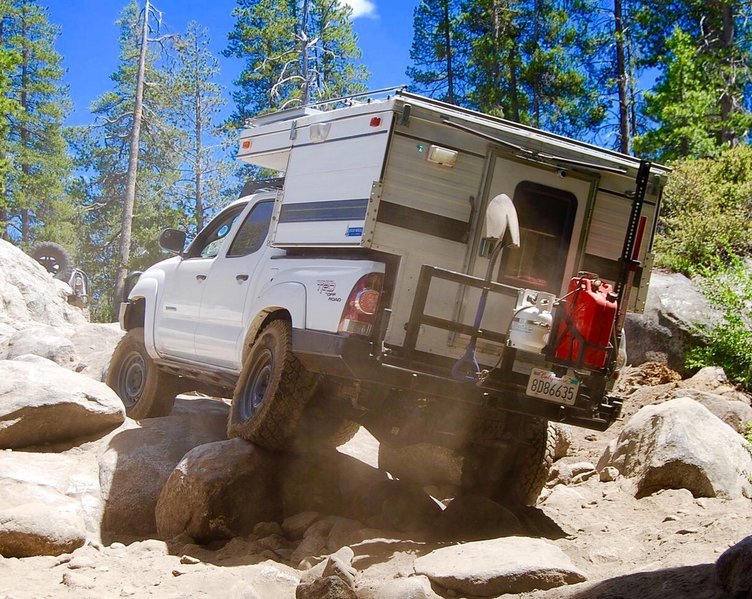

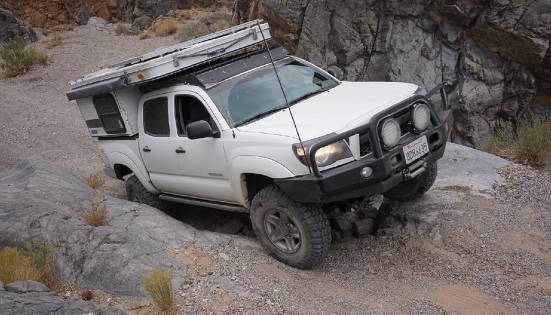

    Not that sketchy. Re-gear and keeping the swaybar is recommended. Big brakes if you have an automatic. Mine was a "Falcon", which FWC only made for 2 years (2004-2006 IIRC).
    Wheeled the 6700 lbs. thing a little bit.

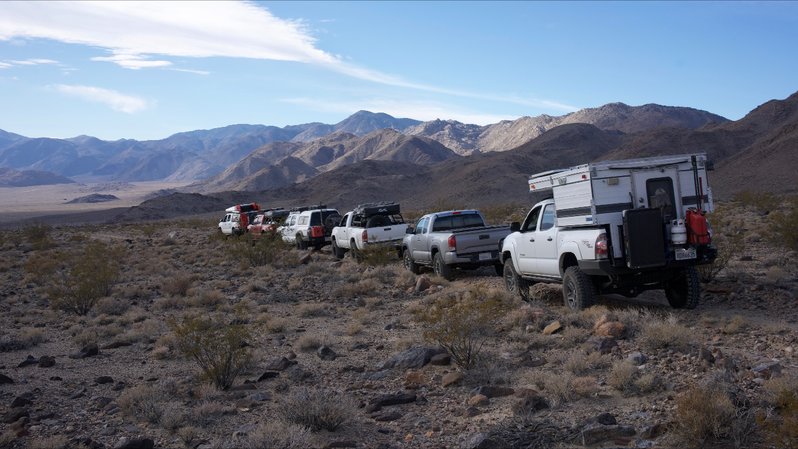

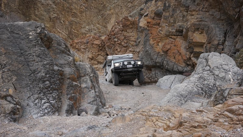

    Managed to keep up with these guys.
    And ran Slickrock (Bear Valley) twice this past summer.

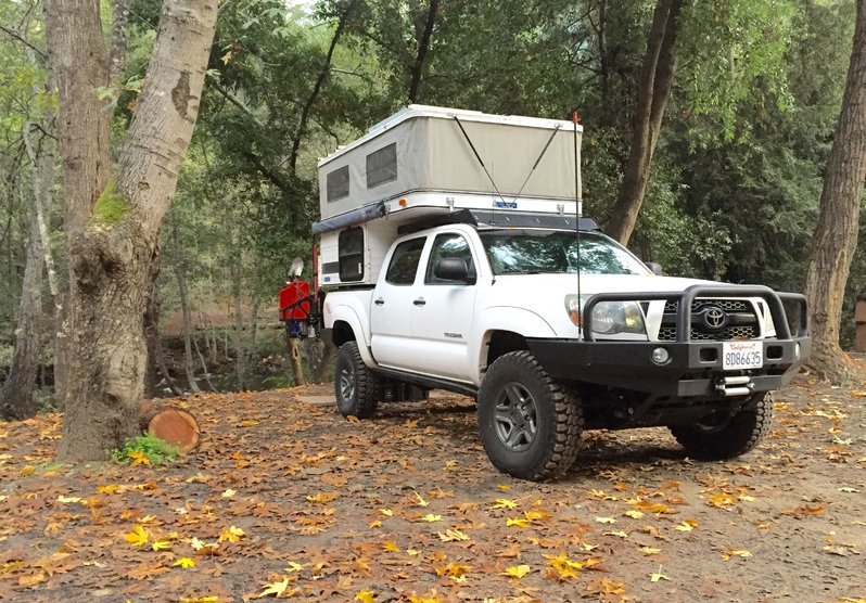

    And camping was really nice.
    Not re-geared yet, but will be soon. After it goes in for a custom camper tomorrow built on the new foundation.
    Not a true flatbed. Kept it at stock bed height for a lower COG and lower travel height. Also pre- planning for 35's...
    I'll probably start a build thread. Either way, I'll keep you posted on the camper company's future offerings.

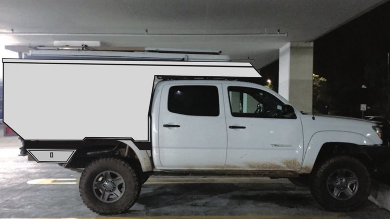

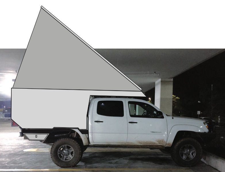

    I agree, the XP fits the bill. It is still mounted on a flatbed though. And really expensive. It will be hard to find a fabricator that is willing to do a frame-mounted camper. It's a lot easier to find one to work off a flatbed.
    My Madmax flatbed was basically built as a foundation for a permanently- mounted camper. It will never be used as a flatbed. My camper will not be self contained either, so they are mounting the walls to the edge of the flatbed. It's as close as I could get to a frame- mounted camper. It will end up looking something like this:
    Won't popup that high, have a sloped nose, or be that low profile, but hopefully this gives you the basic idea.
    What's your budget?
    Also, do you want a hardside or popup frame mount camper? Cabover or just in the bed?

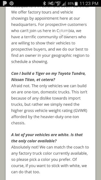

    Found this in the FAQ on their site...

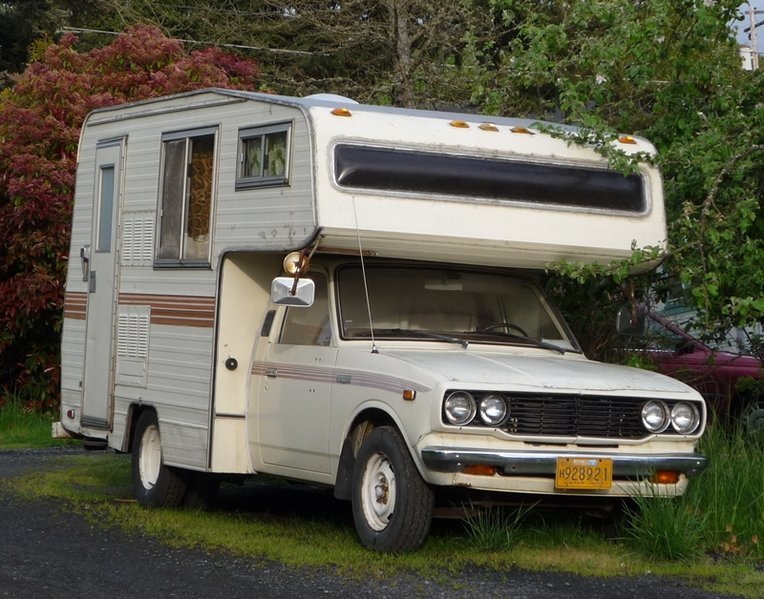

    So, why DID Toyota quit making the chassis they used to have for frame-on Campers and the U-Haul rental trucks? Have a friend here with a neighbor who just bought a older used Toyota truck with dualies and a box body that was either originally a frame mounted Camper of one of the U-hauls. Seems that a 2nd or 3rd gen with the more powerful 6 cylinder engine would be a natural for that type of conversion...

    Well that's exactly what I had seen before as well and I think that the new trucks need a little stouter frame to do this. Maybe I'm mistaken but I think the older trucks had a thicker frame.
