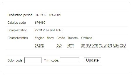

    After clicking on most of the frame numbers on that Toyota page, and inventorying the features listed under each, by trial-and-error I found the "complectation" (extended number) that describes my truck:
    Do you spot any correlation between that number and my VIN number?
    Complectation: RZN171L-CRMDKAB
    VIN: 5TEWM72N23Z288xxx
    Neither do I.
    So ... it seems neither the "complectation" or shorter "frame number" are displayed on the vehicle.

    The "complecation" (I have never seen that word) is actually the "Katashiki" code. You can try some searches using that word, but you likely won't find a breakdown of this as it's primary usage is during the manufacturing stage of the vehicle.
