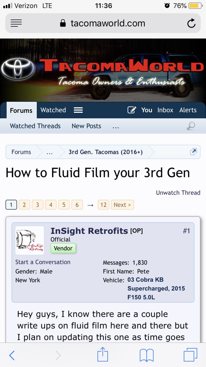

    I don’t know how to link one thread to another but below is a screenshot of a great write up on Fluid Film.
    Should be very similar no matter what gen you have.
