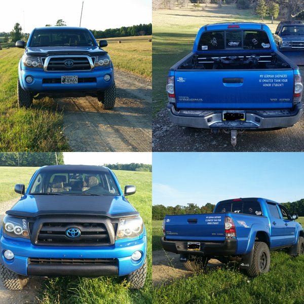

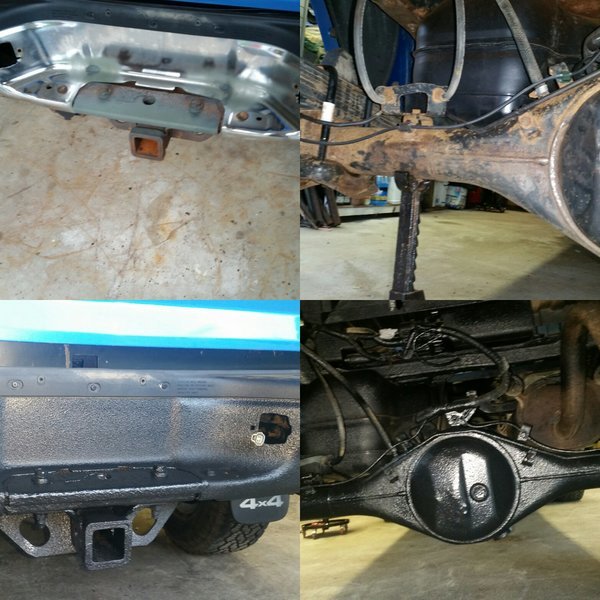

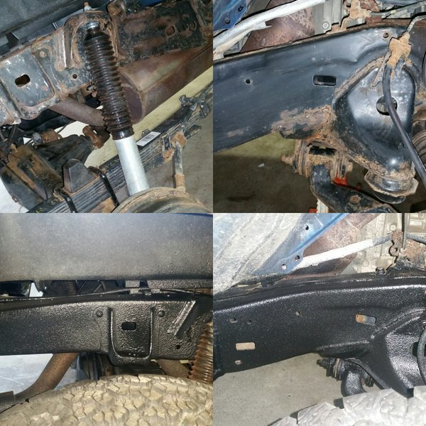

    in the pre mode right now hope to spray this weekend or next week doing frame grill roof part of hood may back bumper can post pic if you would like also using upol raptor spray

    2009 Dcab Man. 6spd v6 Tacoma TRD Offroad elocker
    end up using 10 bottles of raptor but happy with how it turned out
