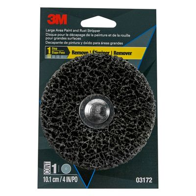

    by wire wheel he means..[​IMG]
    or
    not
    and especially [​IMG]
