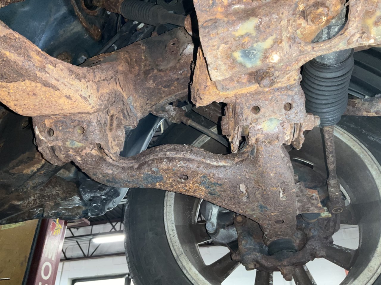

    Hey guys. Last week we bought my son his first car - an 08 Tacoma. I have an ‘18 4Runner and appreciate(d) Toyota’s quality and resale value… so a Tacoma seemed like a great first vehicle.
    Car had a clean Carfax and the seller was like “its really clean!” Truck ran like a champ and has only 65k miles. The vehicle had good service records where it was serviced at a Toyota dealership (this is important). It was listed as a dealer vehicle at one point in another state. When we checked it out, there was torrential rain and a tornado watch. The truck looked great from
    The inside and outside, under the hoof was typical… but we didnt know about the frame issues and didnt crawl under the truck in the rain. Regrets.

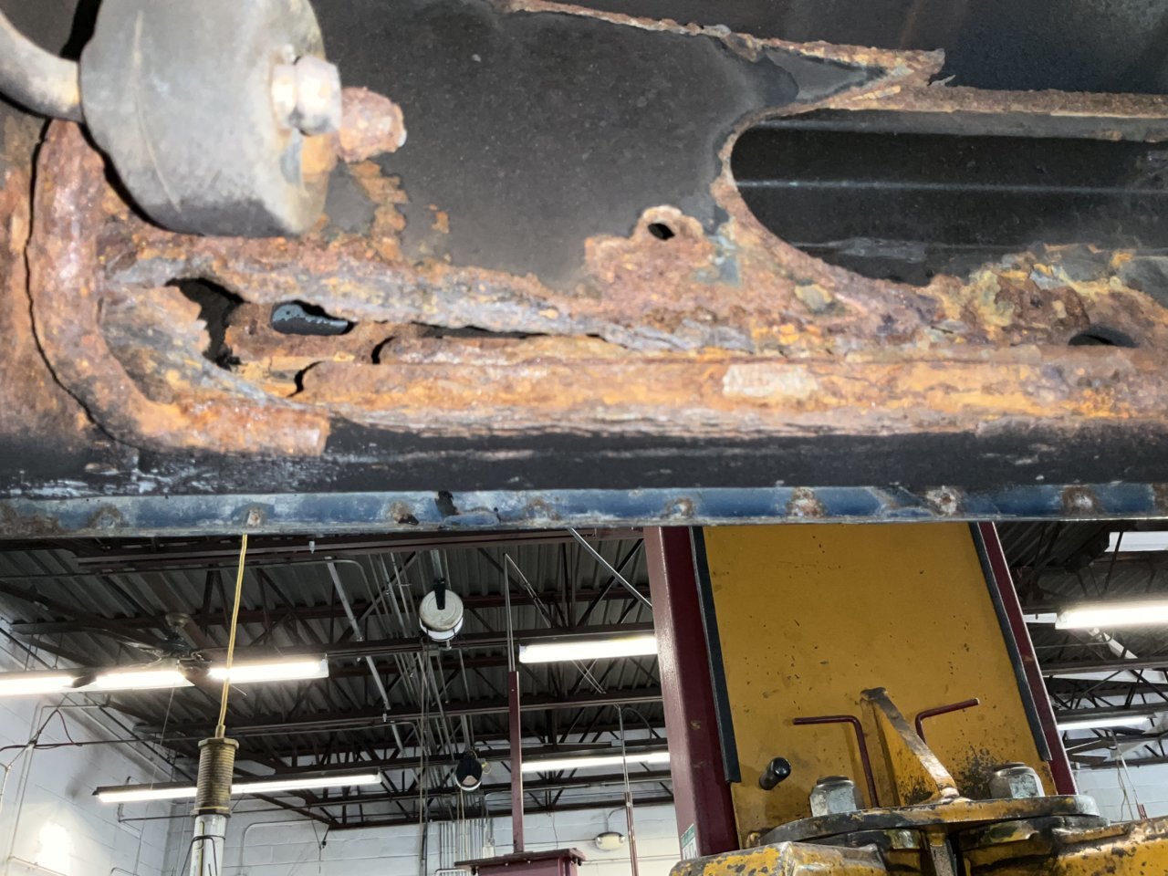

    fast forward to today, 10 days later. Truck was seen by Toyota, who more or less told us to get lost. The last open campaign expired in 2020. Carfax
    Showed first sale in 2010, but Toyota says it was in 2008, so the 12 year settlement period ended in 2020. So we took it to get a Maryland safety inespection and it failed due to extensive rust. There are several large frame holes and pretty extensive rust on the hubs, control arms, lines, etc. it has zero chance of legally passing inspection, and we now have a $12k lawn ornament.
    I am obviously pretty upset about this, but in looking at the Carfax report again, I can see the Toyota dealership service the car three times in the year following the service recall (2017 and 2018). The campaign was open at that point in time and I find it extremely difficult to believe that this extensive rust only occurred in the years following. With how bad it is, I cant believe it was flawless in 2017 and 2018, and 4 years later i can put my fingers through the frame. Toyota says it received frame treatment (crc?) in 2016.
    I’m ar a loss for what to do. I cant afford a $12k loss but its a bit late for that. I am wondering if there are any loopholes or maybe legal recourse, since Toyota had the car several times in 2018 and during the recall. Ive seen 15 years mentioned on these boards, but dont see it mentioned in the settlement agreement.
    Is shopping for a rolling chassis even worth it? I dont mind putting in a month or work to swap it, but if its gonna cost me $10k to find a salvagable chassis then its not worth persuing.
    Man. Life has really been piling it on lately… this one is on us for not crawling under it. Believe me this is a lesson that we will never forget.

    Hi, sorry to hear this. Unfortunately about once a week someone posts this same exact topic after they unknowingly bought a truck with a rotted frame. There is no legal recourse. You’re going to have to try to sell it or get a new frame.

    I'd look into Safe T caps and look into having it repaired and reinforced.

    Well at 65,000 miles , I would be looking for a frame. You still paid to much , but with a frame , control arms , and some bolts you could get some use our of it .

    Wrenching is something I'd say a huge majority of vehicle owners don't do at all.
    Morale of the story is really just about due diligence.
    But as you said, you're kicking yourself in the ass for it. No need for the rest of us to continue doing so.
    As I stated above though, maybe look into getting it repaired. I wouldn't call it a complete loss.
    Getting the bed off is an easy feat for many and that'll provide all the room needed to reinforce the frame (or cut out what's bad).

    I think you'd have to prove he knew how bad it was, which by using the dealer for maint. (?) he may not have and woud be very difficult to prove without first hand knowlege he did.
    edit: After some thought I believe I'd sell it off for what you could get to someone who wants or doesn't mind a big project as you didn't sign on for one.
    It prob. would be a long, tough effort on your part.
    The good news? You're not going to lose 12 thousand
