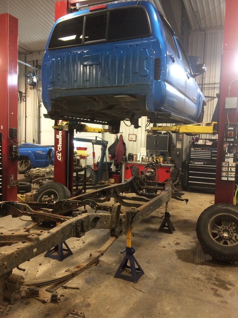

    She's in pieces...A96CB34E-280E-4613-A33E-E9AC27DDC948_zps_4bdc612906f12ae3359c4db4587758c75a1255aa.jpg

    Hey folks. Apologies for no update after getting the truck back - other life stuff got in the way. Truck runs great and rides super! No issues so far. Repair bill to head office was just over $14k...
    FYI, I asked the dealership for a set of the frame plugs. They don't spray the new frames, but after 3 or 4 polite requests they gave me a set of the plugs for free. Was told they don't come under a separate Toyota part #, only as part of the spray kit they apply to "passed" frames, and so can't order or sell them. Will have them installed after I get sprayed underneath.
