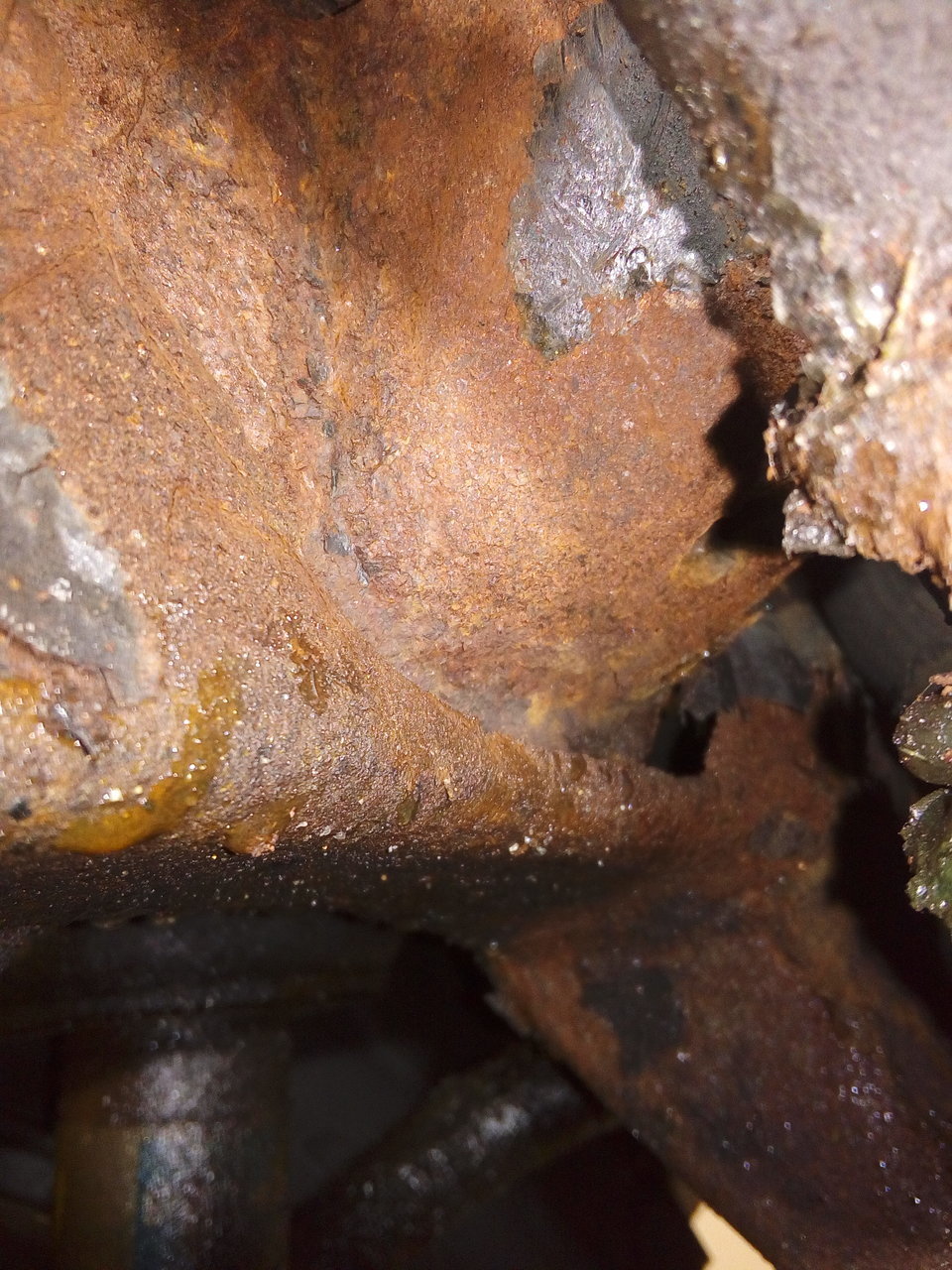

  15. Dec 20, 2017 at 9:23 AM
    #255
    tacotaco2
    tacotaco2 Member
    Dec 20, 2017
    #238970
    5
    Hi guys,
    Got some bad news from my mechanic the other day. My driver side engine mount that is welded to the frame just caved into the frame. Reading the forums, it looks like a common issue. The mechanic printed out the limited service campaign H0F for the CRC/Frame replacement. The issue date is Aug 28th 2017 so it is quite recent.
    The truck was first sold in the state of FL but then imported into Canada in 07 and has been registered here since. Punching in the VIN on Toyota Canada show "VIN is not valid". Punching it in Toyota USA shows the service campaign H0F listed.
    Here is where is gets super fun!!- In the cold weather states where the campaign is valid it does not list Florida (where the truck was first sold) but also says where the truck is registered. The truck is registered here in Ontario and has been for 11 years. Do you guys think I have a leg to stand on for getting the frame replaced?
    I have an appointment Friday to have it inspected but so far its not looking good as they already said they cant find any service campaigns listed for my truck.
    Any help would be appreciated!

    Okay took a couple beers but made it through all the postings (sorry for not doing it ahead of time... panic set in when I got the news). Future visitors with US trucks now registered in Canada page 6 is where you want to go... I will call Toyota Canada to hopefully open a case #. Hopefully dealer doesn't give me a hard time about missing the LSC that ended last Demeber since there is a current LSC in the US.
    Anyone take their truck to Ancaster Toyota? I see others had luck in Brantford. I could limp it over there if I will have better luck.
