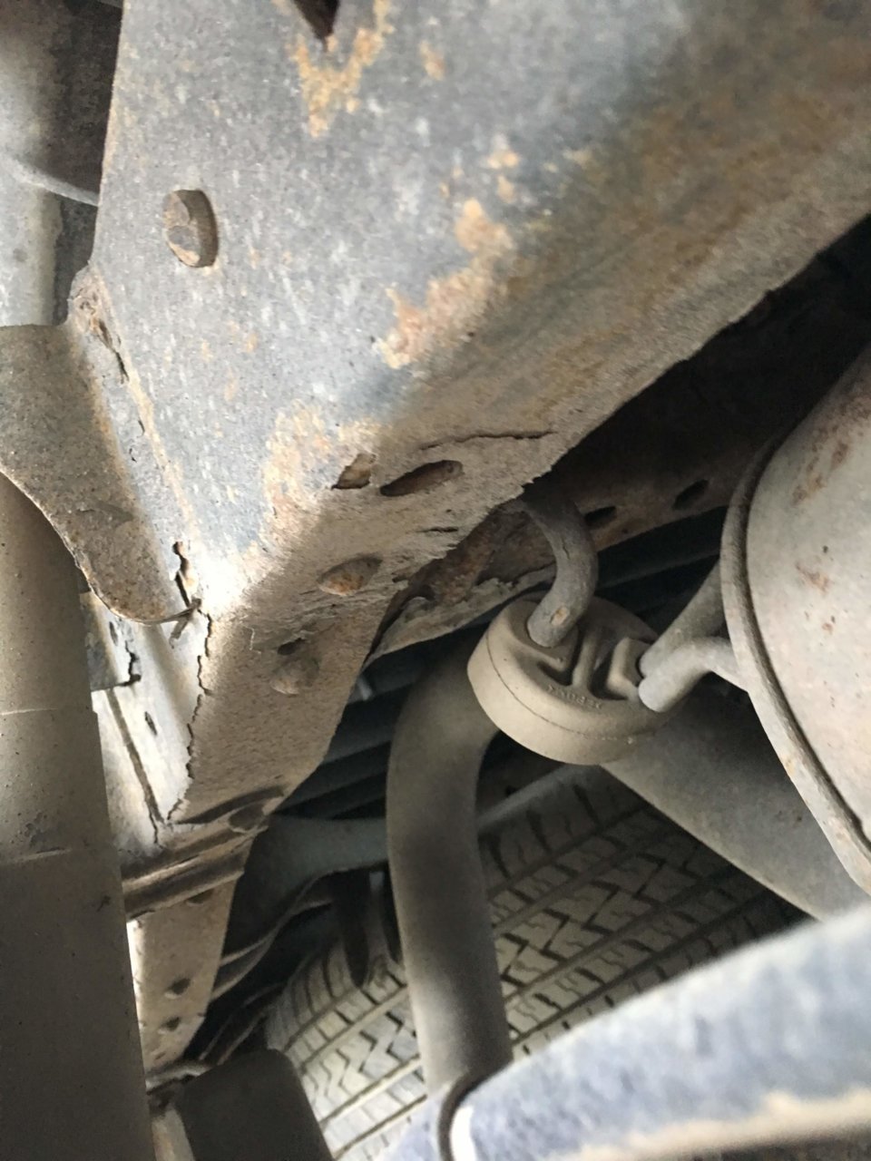

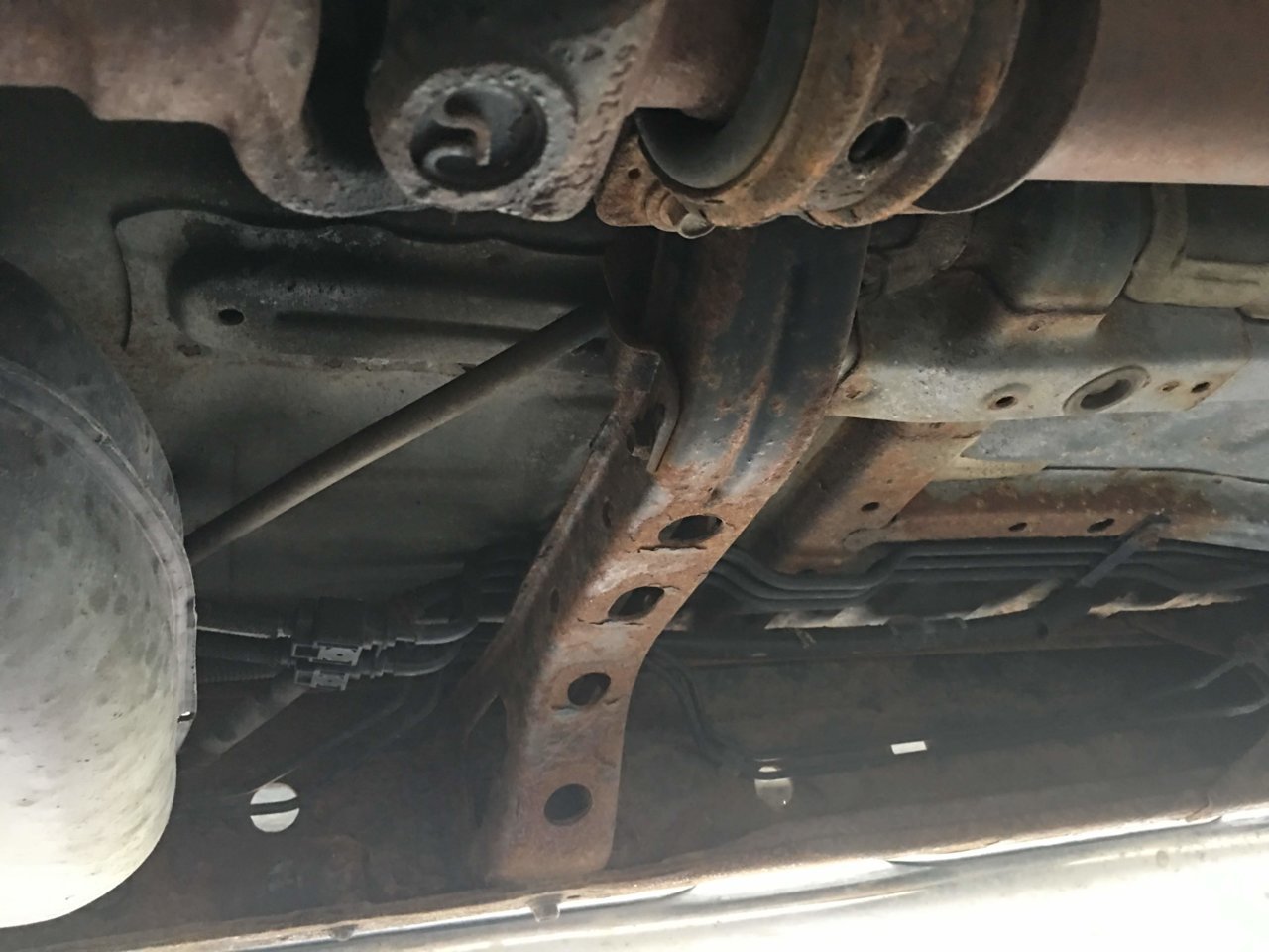

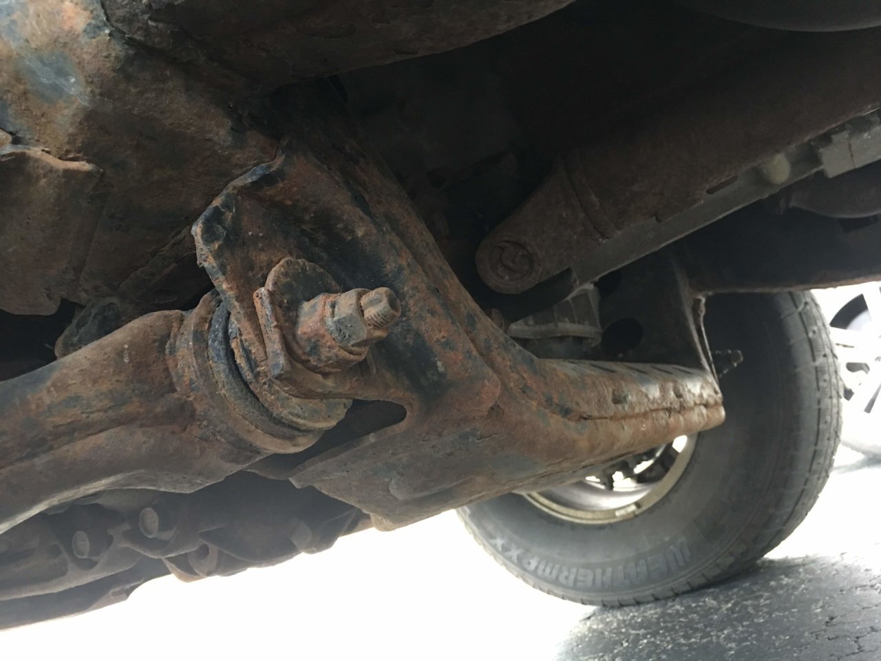

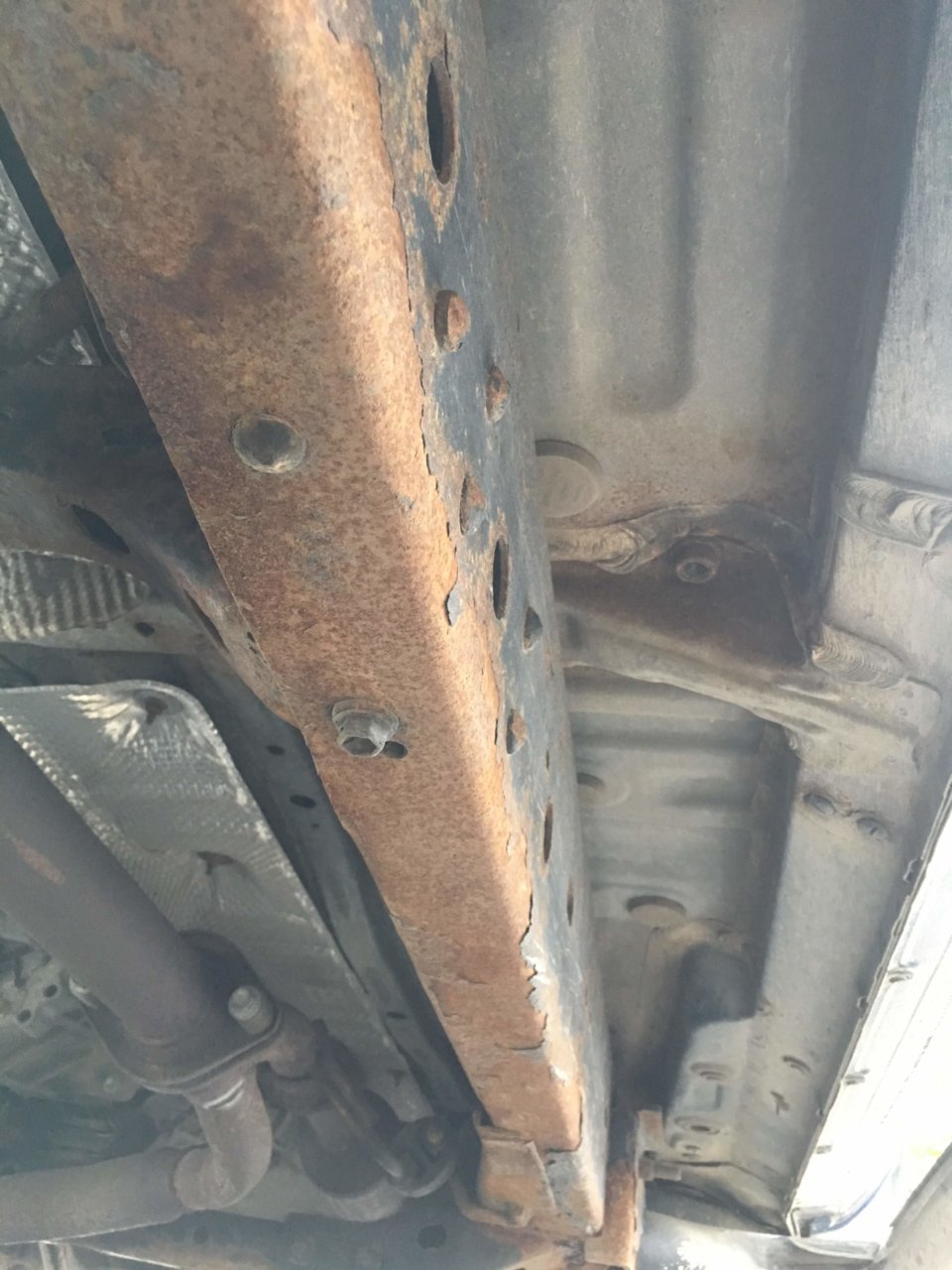

  14. Sep 21, 2018 at 3:23 PM
    #294
    IgorSchneider
    IgorSchneider Member
    Aug 6, 2018
    #261905
    17
    Igor
    2007 4x4 6M OR AC
    Here are the pics of my frame, they aren't the best but give a decent idea of what qualifies for a replacement.

  15. Sep 21, 2018 at 3:36 PM
    #295
    dreadedyota
    dreadedyota Well-Known Member
    Jul 27, 2018
    #260785
    65
    Ernest
    Ontario Canada
    2008 Black Tacoma TRD.SR5.Sport
    Camburg UCA,Cowl Induction, ECGS, Exhaust Reroute.
    Thanks for the pics, I was just researching what would qualify for a replacement. I have an appointment Tuesday to see what they will do. Compared to your frame mine isnt all that bad but i wouldn't mind getting the corrosion spray

  18. Sep 21, 2018 at 6:05 PM
    #298
    TireFire
    TireFire Superunknown Member
    Feb 6, 2016
    #177349
    7,666
    Olympic Peninsula
    Kinda surprised that qualified. I mean it should IMHO but where's he required 10mm hole?
    DLillest likes this.
