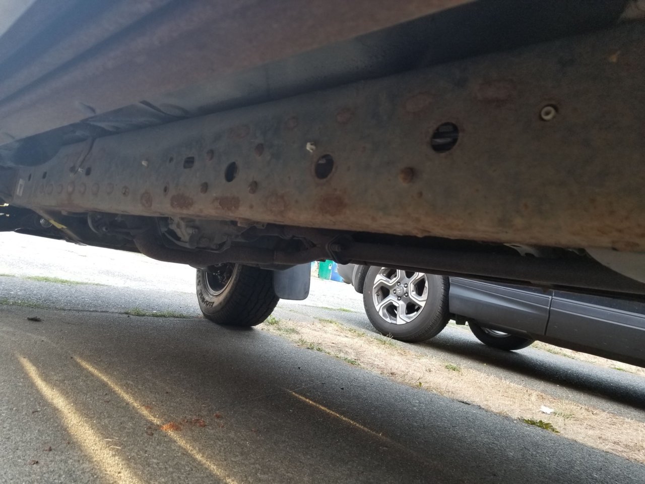

    When I was buying the truck I did a visual inspection and didn't see anything worse than this but I can just assume that the dealer threw it on a lift and had a more through viewing.

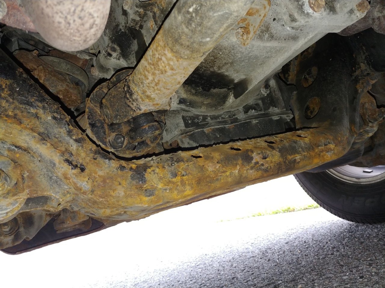

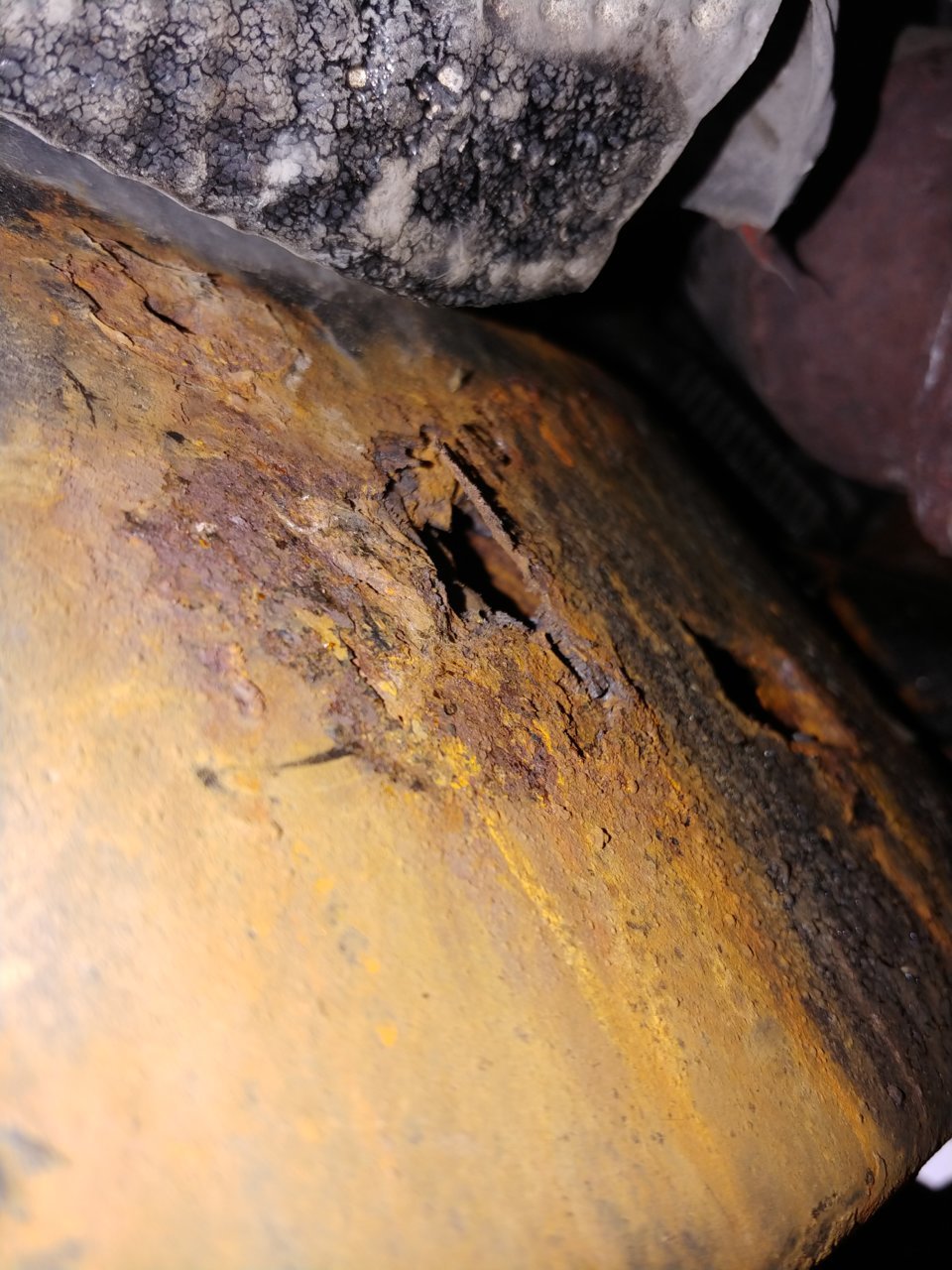

    Myn is a 09 went for the inspection in Duncan, BC. They said because there were no holes they only can do the coating. Even sent pics to Toyota and it got denied for a replacement even though every weld on my frame is rusted and cracking. Plus down the frame the inside welds have rusted through to the other side. So is their plan to just cover it up. 20180828_185615.jpg 20180828_185603.jpg

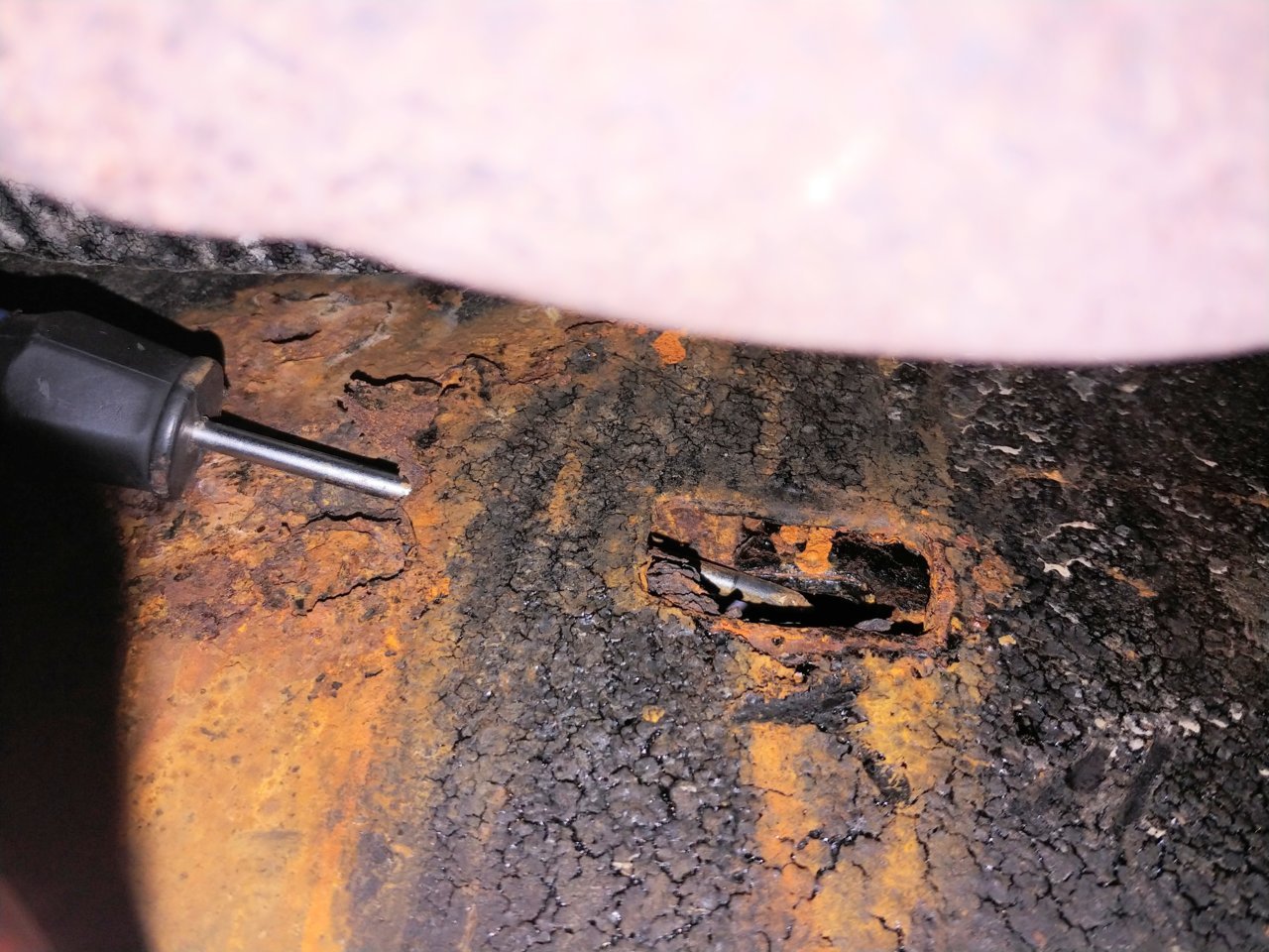

    I was told already that I was getting the replacement but it will either be in October or in the spring according to the dealer.
    Here are some pics

    Wow, that's pretty bad. Was your frame previously coated with the CRC?

    Yea it was. I actually bought the truck in July and from inspecting it briefly while laying on the ground, it had that nice CRC. The seller even provided the paperwork showing that it had been coated 6months prior. After a full carwash, I got underneath and noticed the frame was rotten near the cats.
