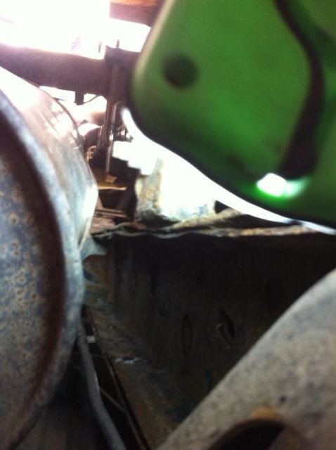

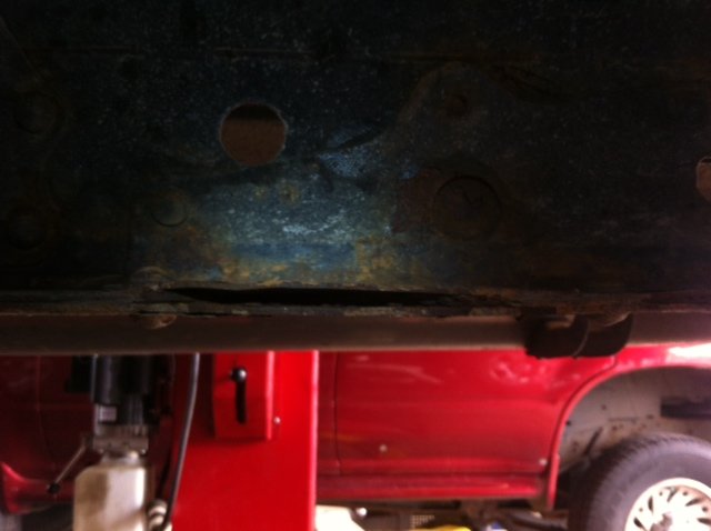

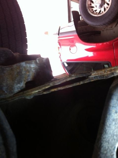

    sorry i did not get any pics today but if there is a hole bigger then 10mm(1cm) they it fails, if you have 3 toonie size holes you will be getting a new frame for sure

    ok i figured out how to post pics so here are a few. keep in mind i didnt have the same problem as most people. i dont have any holes going through my frame what I have is the 2 piece C channel frame bending from rust in-between the 2 layers of metal and this failed it
