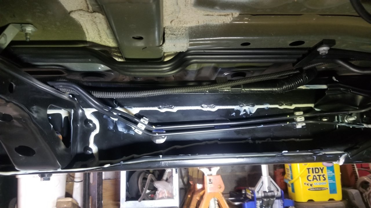

    I was also told 12 years from first date of sale. My frame was sprayed 6 days ago, fairly good job was done but this white waxy stuff is still just as soft as the day I picked it up. It is still more like a grease then hardened wax. Called dealer to find out if it will harden up but they have not returned my call. If I was to wash my frame with a garden hose with a direct stream, I believe it would remove it.20220411_114445.jpg

    Does the dealer do any prep work on the frame before covering it?
    If the frame still has rust and all they do is coat it, wouldn't the rust just continue underneath, and potentially leave you worse off than before and potentially after the frame warranty period?
