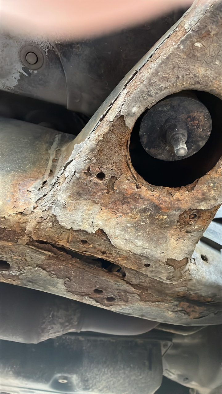

    Hi there I was wondering if any of you know what could be done for my 2008 Toyota Tacoma that got the inspection and was sprayed a couple years ago but now has multiple holes in the frame?
    I have also had it undercoated every year since than.
    I have contacted Toyota Canada (I live in Ontario Canada) and was told there could be an extension that may cover it but he was unsure. My local dealer told me they can’t do it. But after reading these post I feel that I should be covered under some sort of warranty since what they did to it obviously did not last long. Very frustrating since there are older vehicles out there that will out last my Tacoma. I thought these vehicles we’re supposed to last forever, but anyways anyones ideas would be very helpful. Thank you!

    In the same situation. Just found this on my truck and waiting for a call back from the dealer.

    Will do. I got the following message from Toyota Frame Settlement. Might want to give them a shout at toyotaframesettlement@epiqglobal.ca. Bold and underline are mine.
    Good Morning,
    Thank you for your email.
    Without the VIN we are not able to confirm whether the vehicle would have been covered under this Canadian settlement.
    However, the Enhanced Warranty Program for frame corrosion available under this settlement provides the additional coverage only for the later of 12 years from the date of first use or up until July 21, 2019. Given the age of your vehicle, unfortunately it would fall outside of these parameters and there would be no recourse available to you under this settlement.
    As the independent third-party administrator appointed by the courts, we are not part of Toyota Canada. You may wish to discuss your concerns with the dealership or Toyota Canada directly. The Toyota Canada Custom Customer Experience Center can be reached at 1-888-869-6828.

    That's what I've realized. Still waiting for Toyota to give me call. See what they say. I'm going the route of taking it to a local autobody shop to have them remove the junk spray Toyota put on, weld the affected part, paint and then Fluid Film it. I'm still not ready to give up my truck. Just refreshed it with new suspension, changed all fluids, brakes, etc in 2021.

    I'm glad you took my comments the right way. So many people post in here - with trucks well out of the window - and rail about how unfair Toyota was to them and how they're going to sue Toyota out of existence. Truth be told, twelve years is a pretty solid frame warranty no matter how you look at it. As for suing Toyota, I'm sure any number of lawyers will be more than happy to bill them for a useless effort - while telling them they've got a good chance of winning.
    BTW, there is a company now making patch panels for Tacoma frames. This will be not only more cost effective than scratch built, but safer (if properly installed) too.
