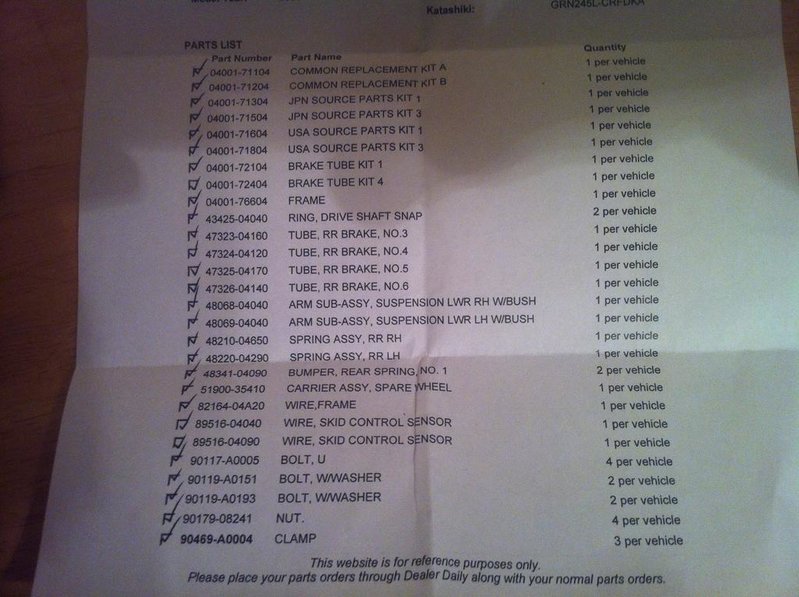

    I've had mine done since July with no problems. The dealer didn't do any additional work other than the frame replacement, I wasn't charged anything, got a loaner free for a week and they put my rack bushings in at no charge. Here is a generic parts list, mine was the same.
    courtesy of nitro1021:

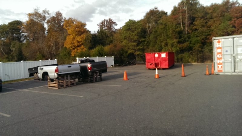

    Failed frames way in the back corner of photo,also truck beds sit on pallets as more frame swaps are under way...

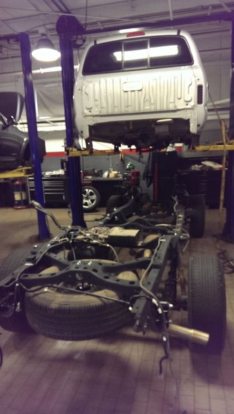

    Here is one being done today,he walked me back to show me how they leave the motor and trans up inside the cab. He even let me shoot this photo
