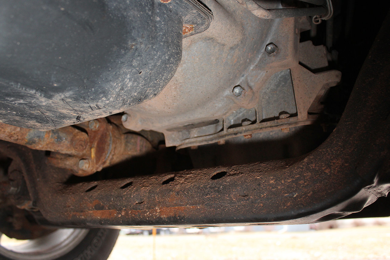

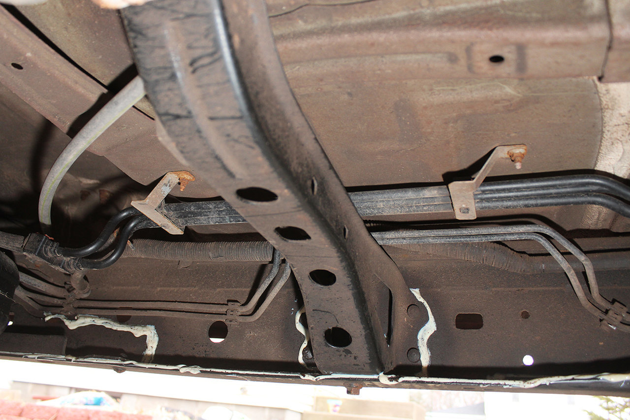

    Here is my follow up, post inspection. Set up the appointment with Maplewood Toyota and dropped the truck off early on March 12. Complementary rental was a 2019 Camry SE. Would have been nice to try out a Gen 3 Tacoma but the Camry was interesting for comparison since my DD is a 2015 Camry SE. As I mentioned my truck has a fairly easy life overall without a ton of winter use. Here is a before picture of the frame, you can see a little of the old Fluid Film treatments remaining and general dirt.
    The next day they called when working on the truck, recommended a change of the cabin air filter and spark plugs. I declined both as I can do the filter much cheaper in under 5 minutes and had already done the plugs myself. The truck was done mid-afternoon and I picked it up late that afternoon. No charge.
    I was surprised at how limited was the amount of corrosion inhibitor used. This is the same area of frame shown in the before picture above. You can see they didn't go crazy cleaning the frame either concentrating on the areas the CRC would be applied.

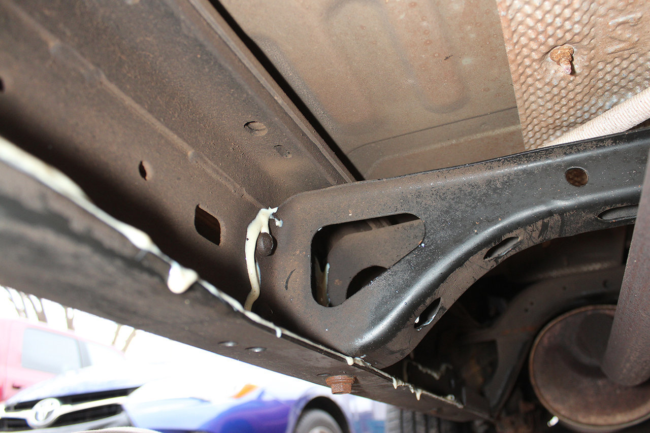

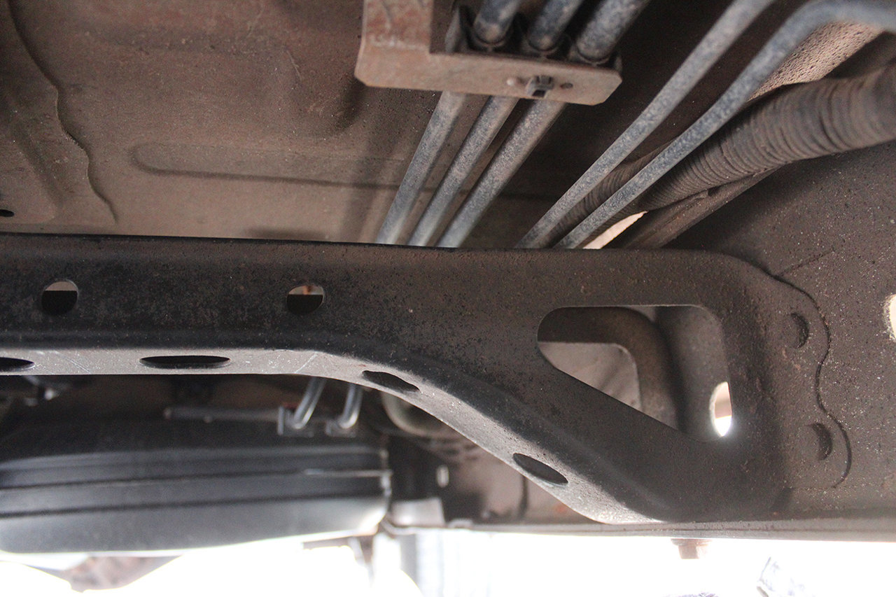

    I wouldn't worry about this stuff hiding problems or promoting rust. Here is another picture showing the frame rails on the passenger side post treatment. It runs down the seam near the bottom of the frame and around the cross member mounts. It's been over 2 weeks since I picked up the truck and just took the photos today, the sealant is still very wet, I suspect it won't set up any time soon.

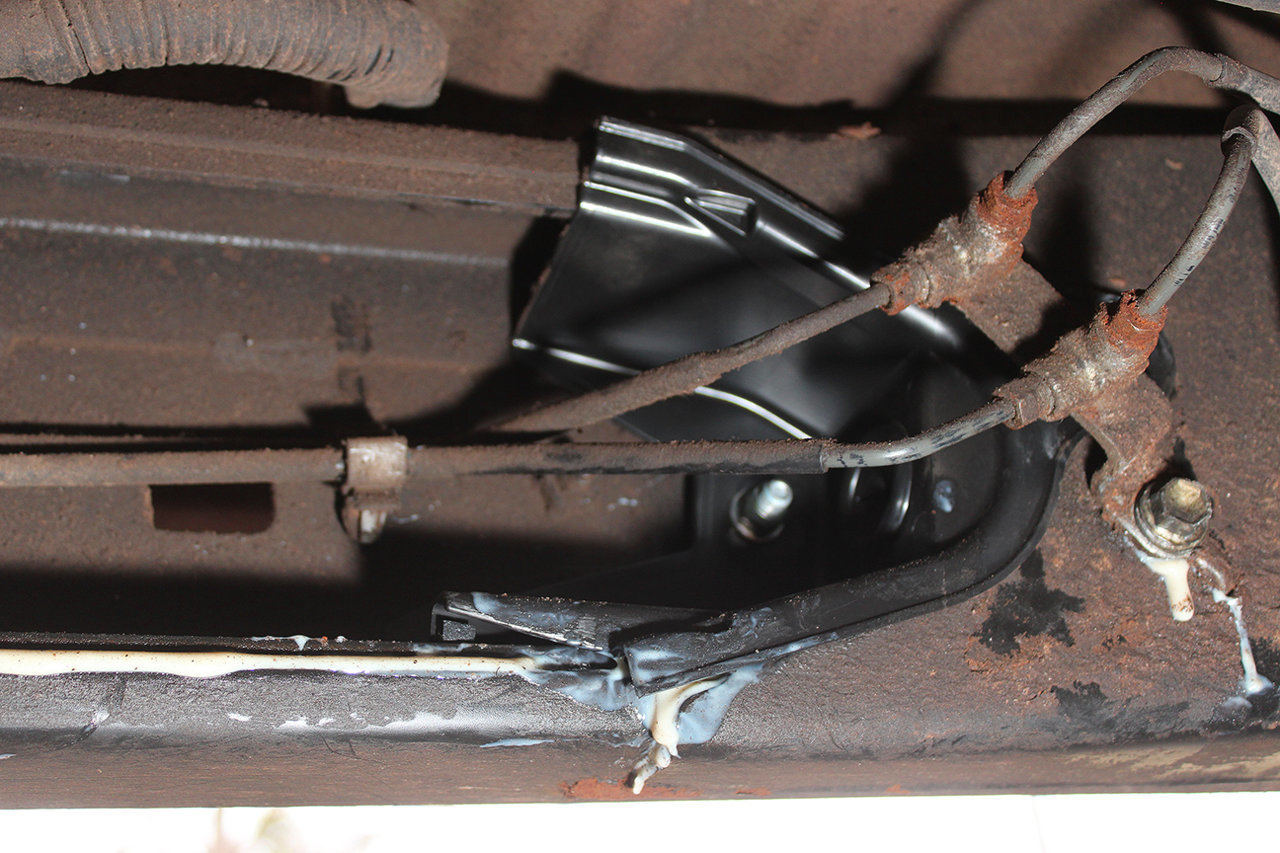

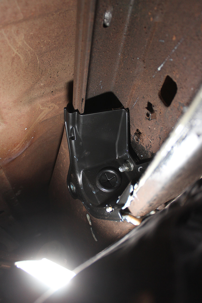

    The biggest change I could see are the caps installed that block the frame where they go from the long open section to the boxed section at the front. Here is a look at the new cap on the passenger side of the truck, the bright area is the opening to the front wheel well. Of course, this isn't an air tight cap.
    Here is the cap on the driver side. This side looks a little trickier since the brake lines had to be moved aside and worked around.
    There were plugs installed farther up on frame as well near the front wheels.
    If there was one surprise for me it was the areas that weren't treated. For example the cross member under the engine has ways for salt to get in, evidence of rust along the seams but weren't touched.
    The bottom line for me is that it's done and the frame coverage is in effect until 2026.

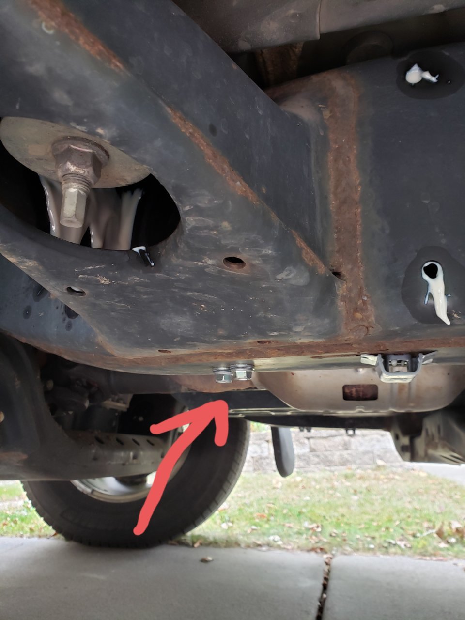

    Lo and behold, the dealership called Monday and said the plugs were in. I dropped it off Thursday night and picked it up at noon today. All done. Looks gooey like all the other pics.
    I am curious about these bolts they put in. I'm assuming they hold something inside the frame?
