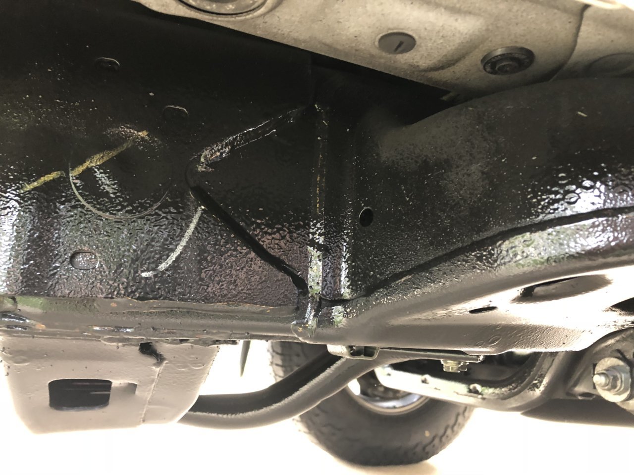

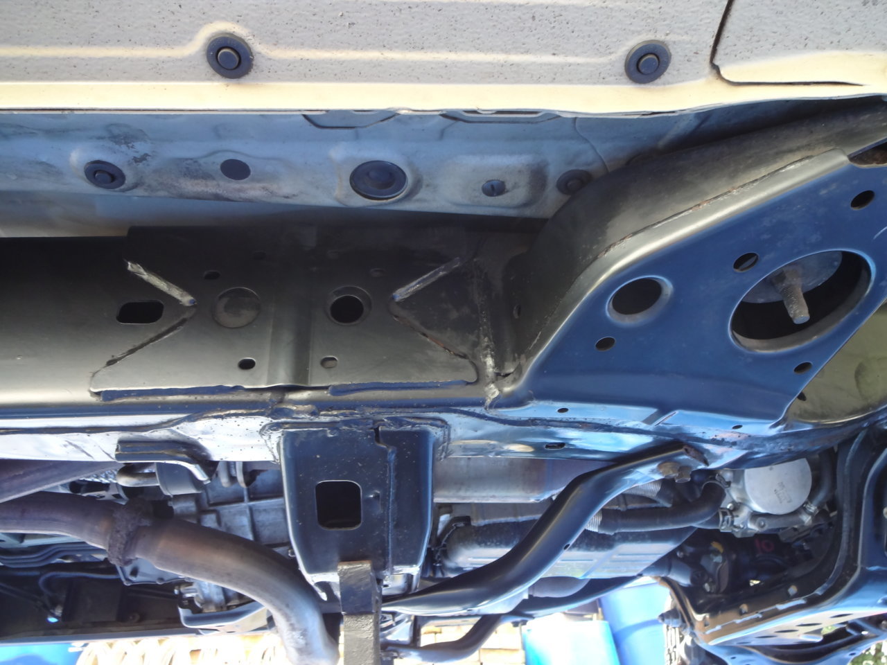

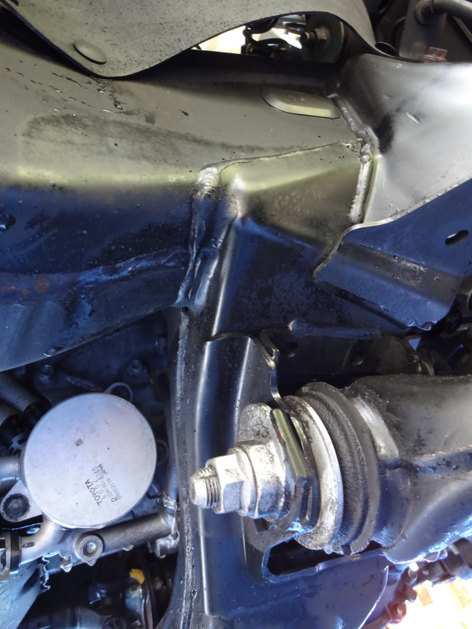

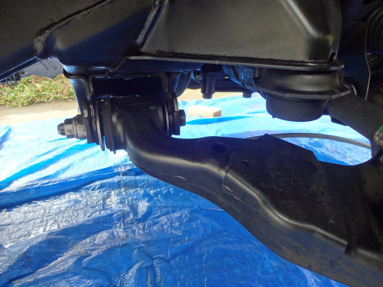

    Two years in the rust belt and still looks new thank you fluid film.

    It also appears you don't drive your truck very much. I too use Fluid Film and so I know that shit picks up road grime like a damn magnet. Yes, no rust, but the underside of your truck will look like a greasy old sock that's been laying on the highway. In your case, your truck is barely dirty at all, which tells me you haven't driven it much with FF on it.

    That is a clean-ass undercarriage

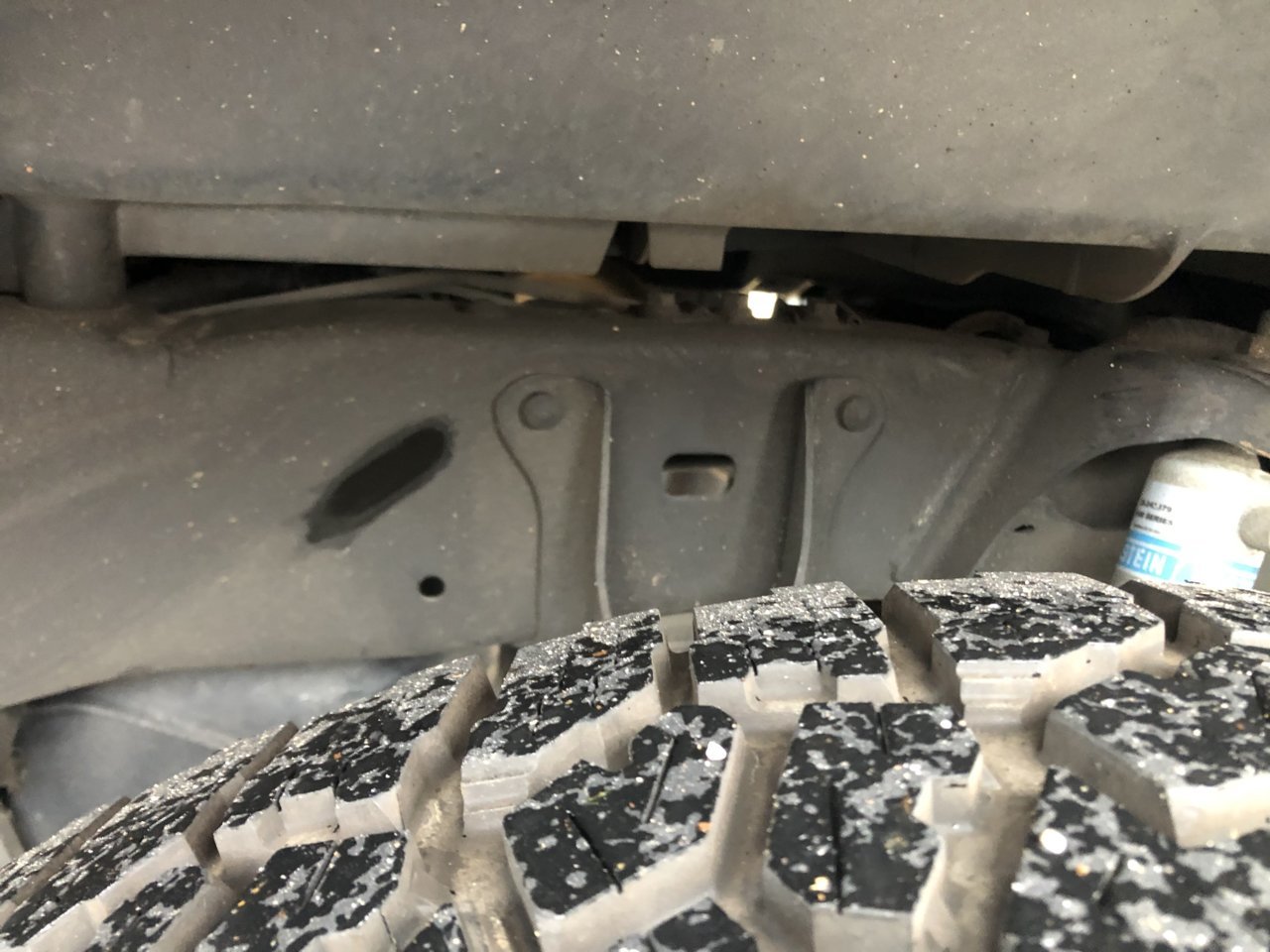

    I got 45k on my truck in 28 months I do drive it. The fluid film in my experience dries to a dull wax like coating in about 2 weeks and takes a lot of effort to rub it off. I’ve included a photo of what it looks like a month after application and I took a rag and rubbed a spot to show the shiny frame underneath. If the fluid film is all oily and greasy for more than a couple weeks my guess is your using too much.

    Ah, there we go. That's what I expected to see. I wouldn't say it dries so much as it just collects a thick film of dirt.

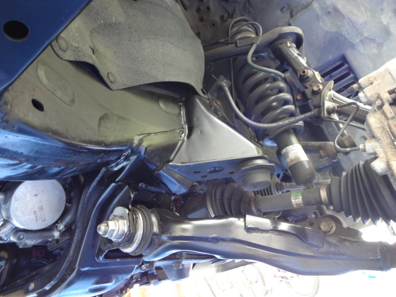

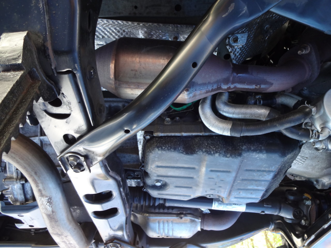

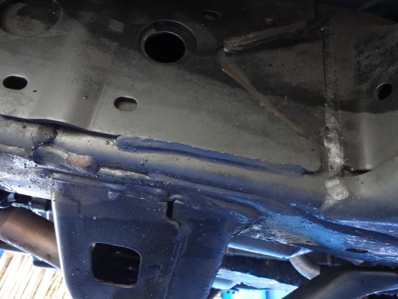

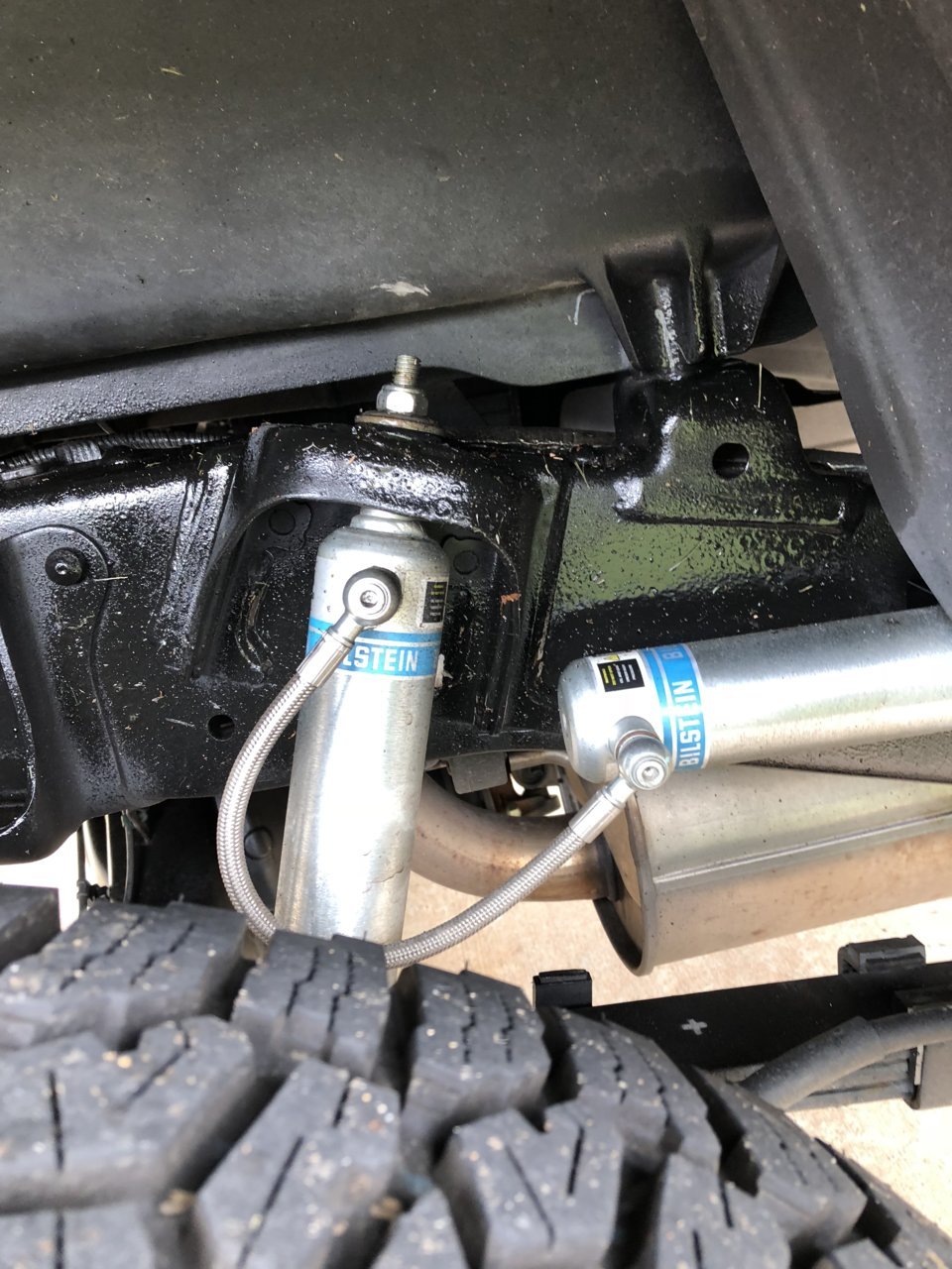

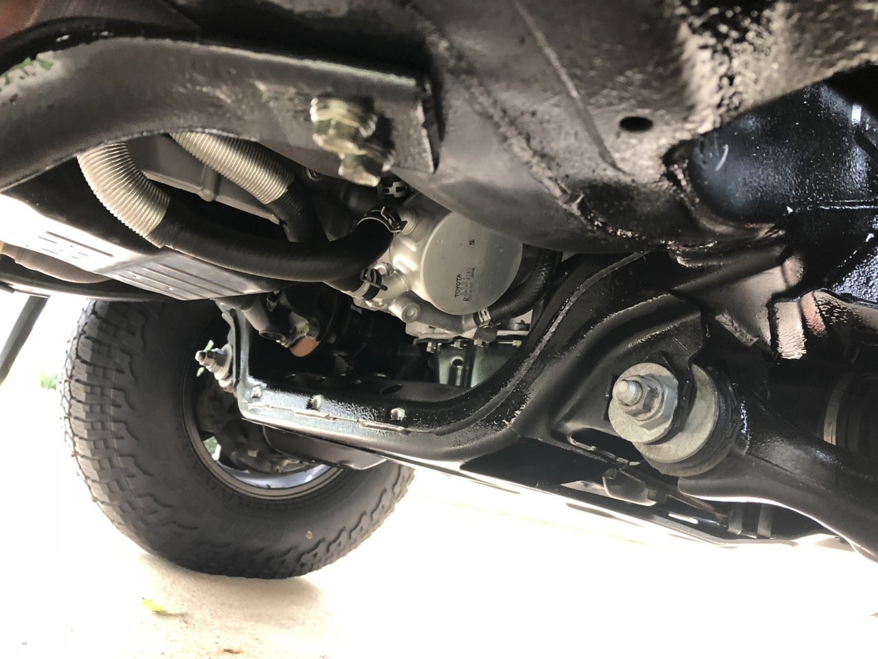

    I wash the undercarriage before re-application.
    I noticed a few rust spots, but here is my 11/15 TX built SR5 a few weeks ago during the process of Fluid Filming it.
    Never got a letter about the recall- maybe New Jersey isn't included.
    FWIW...

    looks really good IMO. As a jersey guy who just did a fluid film treatment on my 2020, this is assuring to see.

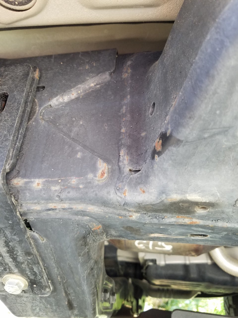

    For FWIW here is the rust I noticed on my 2016 SR5 earlier this summer:
    This spot, behind the passenger side cab mount, was by far the worst spot. I hit it with POR15 and the POR15 covering paint on top of that and then fluid filmed the crap out of my frame.
    I definitely have grime building up on my fluid film as @jowybyo predicts.
    So here is my question: when I apply more do I have to clean the old stuff off like @boynoyce ? I don't care if my frame has grimy grease all over it as long as it isn't rusting.
