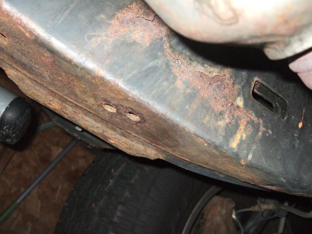

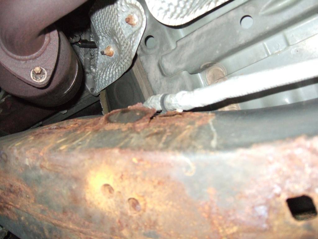

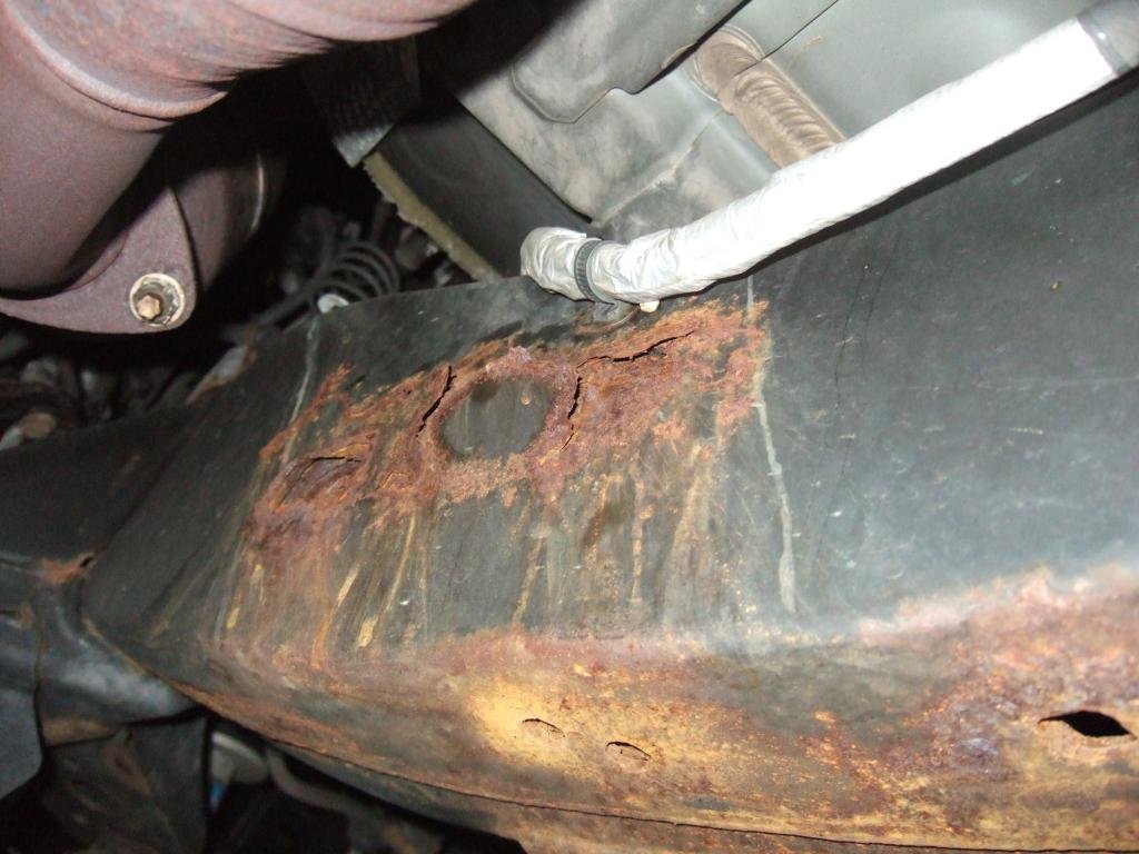

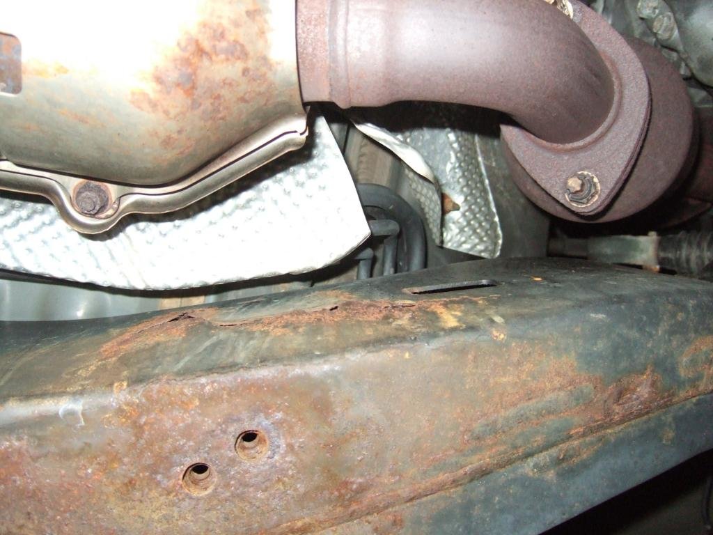

    This is the area you want to watch:
    TRD50[QUOTED] likes this.
