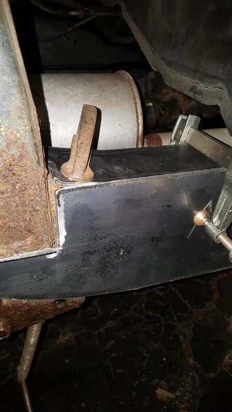

    If you start cutting out large portions, it would be a good idea to tack weld in some support braces between the frame rails. This will help to keep everything lined up. It will also help to reduce warping when you do weld in your new pieces.

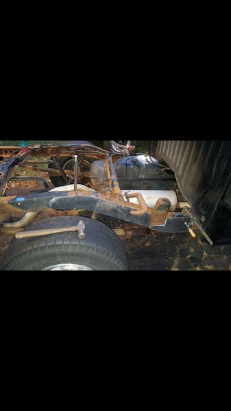

    Gah...that looks ugly. Any pics of the repair?
    nzbrock, good point. Also, sweet sculptures...
    Well, what I'm going now is working to get everything pulled off the frame, and then make patterns. My brake lines are toast...not the lines themselves but the nuts on either end. So I'm going to order new ones, as well as a new main gas line. I couldn't for the life of me get it unscrewed from the tank, so I cut it. In a brief moment of idiocy I about grabbed the torch to heat it up...haha...common sense prevailed.
    This thing is going to be awesome when I'm done.
    Oh, the metal on the frame under the bed is in mostly decent shape, but I'm tempted to reinforce it a bit. I don't do any wheeling, but I use a truck as a truck on occasion... any recommendations on that?
    Thanks for the help. This is a great community.

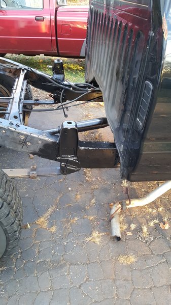

    Not sure what ypu mean by the metal on frame under bed ,but on mine the top section of the frame was really the only good steel left so i ended up cutting my patches about 1/ 4 short so i could lay a good bead into the top then i had a length of 1/8 steel sheared to 2 1/4 x8 feet " i think it was then i laid that on top and welded it in as a cap start at one end then i welded about a 1" section both sides and then kept hammering it to shape and weld as i went

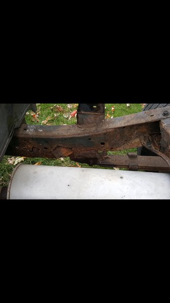

    Wow that looks great! Very inspiring.
    I meant the rear "C" section of the frame that's under the bed. I see you extended yours up the outside a good ways...that's a good idea. I'm just wondering if it would be worth it to do some reinforcement on the "C" section.

    I looked at that too but that section was in good shape on mine so there was no need to reinforce it i mainly focused on the major stress area where the front leaf mount is you need that to be very strong ,i wasnt sure what to do for spring hangers i googled some that were for sale but just didnt find anything worth buying so i just cut all the rot off the stock ones and rewelded them back on im glad i did it was easier to line everything up and i didn'thave to make anything ,i do recommend the polygraphite bushings though for the leaf springs tthey have worked well for me i really lubed them up when i put them in with neversieze and truck really rides nice now with good flex from the springs ,when it was stock the bolts were all seized in the bushings so the suspension wasnt really working

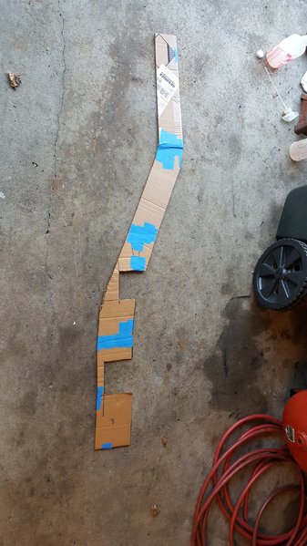

    I made my patterns out of cardboard so that i could actually put them up to check for fitment ,actually made the whole cap piece out of cardboard that way i could slide it right up and be sure everything fit

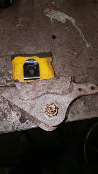

    Mmmm I actually think I have some spring hangars from back when I thought about fixing my old frame before I got a new frame . Would this be something you'd be interested in ? You can go to the All pro website I have the front and rear hangars

    I think I'll try salvaging my current hangers. Thanks though.

    I like the patterns. Cardboard would be easy to trim...

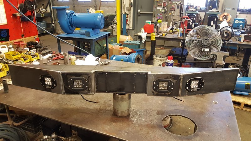

    Got in a little time today to work on my bumper I still have a bunch of welding to do so I feel for you

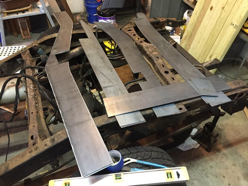

    Got my metal today. Made cardboard patterns and took them to a local metal shop. With as much as I'm doing (which is slight overkill) I had to get a lot of metal so it ended up costing me 600 bucks. That was basically the cost of a 4x10 sheet of 1/8 steel plus a little labor to plasma cut the pieces out. As I've said I have enough to box in the frame from around the leaf spring hangers up to where the frame curves in to go between the front tires.
    Here's some of the pieces. They're double stacked so there's actually more than what it looks like. I'm excited. Gonna spend most of the day tomorrow welding.
