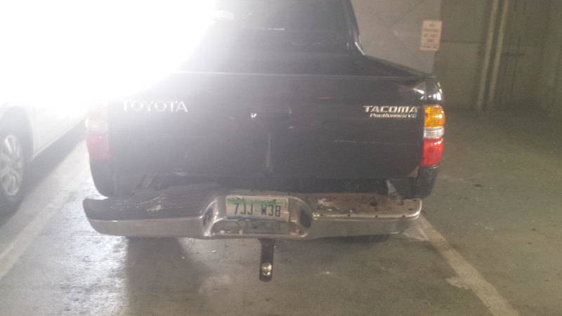

    new project for me. son was rear ended at a stop light. heres some pics.unnamed.jpg REAR BUMPER.jpg after driving my old taco for the last 9 yrs, he came home with this!2017 Tacoma.jpg

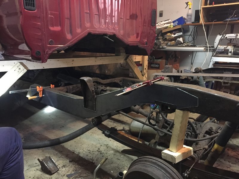

    Cutting off the leaf spring hangers took a while. Mostly because I then tried to save the bolts, but I'm going to have to get new hardware and bushings for the front at least since I ended up just cutting them off. I'd love to just go ahead and get new leaf springs now, but I can't afford it.
    Anyway, I spent most of the afternoon and then evening removing the old undercoating before getting to the leaf spring hangers. Talk about a pain. What ended up "working" was paint remover and an inch and a half wide scraper. Slow going but if you've got patience it does the job. Once the majority of it was off I went over the frame with the wire wheel on the grinder. Messy business. I tried initially to remove the undercoating with the grinder but it smeared it and then strung it out in wispy strands like cotton candy. I wanted to remove the undercoating so I can hit all the rust with Ospho. I've decided to NOT cut out all of the suspect areas, but rather to just box it all in after converting the rust. The way I see it is with all the new metal and what I'll be doing to kill the rust and then prevent more from occurring I should be able to get at least the life of the truck it has lived now before calling it quits. Wishful thinking maybe.
    Here's a pic of the first piece clamped in place to check fitting. Have to tweak it a bit here and there. It extends past the orange clamp about 10 inches. A long way to go yet...sigh. IMG_2872.jpg

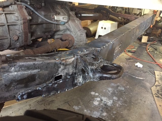

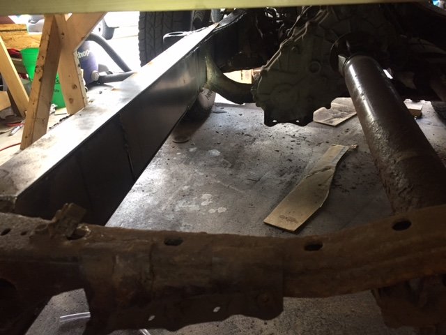

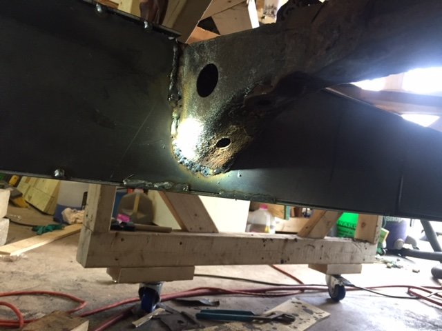

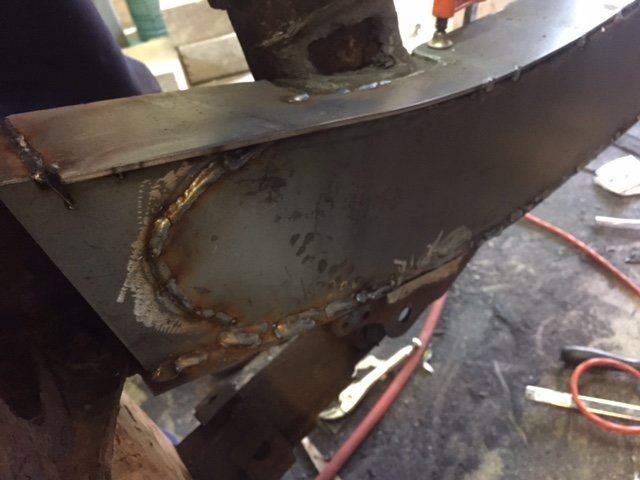

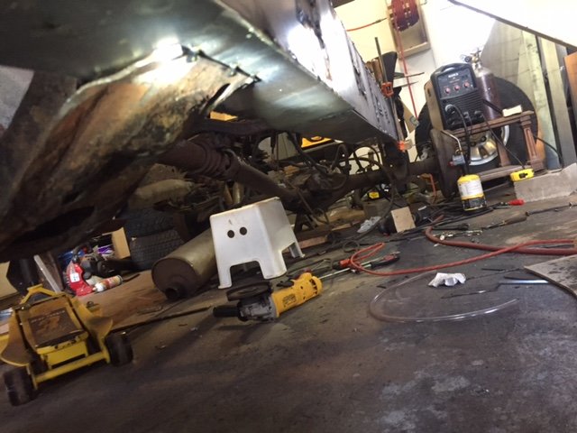

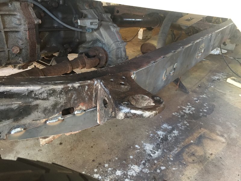

    Finished is a strong word. All pieces are in place on the driver's side. I just need to finish welding it all up. I boxed in the frame all the way from behind the leaf spring mount up to in front of the cab mount just behind the front tire. For the transmission crossmember I held it up with my floor jack, then cut the bracket off the frame, removing the rotted material behind it as well as enough to allow for the new frame piece to slide in behind it. It's just tacked on now, but I'll fully weld it in place. The drive shaft crossmember wasn't fully removed, I just cut an 1/8 inch gap on the lower half and again slid the new piece up behind it. For the leaf spring bracket, I removed the old frame pieces that came off with it when I cut it from the frame, and then bent out the "tabs" to accommodate the new width. Haven't secured it yet, but just have it clamped for fitting.
    Thankfully, there was enough solid metal to secure it all to. The old frame lasted 18 years slowly rotting away, so if I can get that much out of it again...haha, wouldn't that be nice.
    Here's some pics:

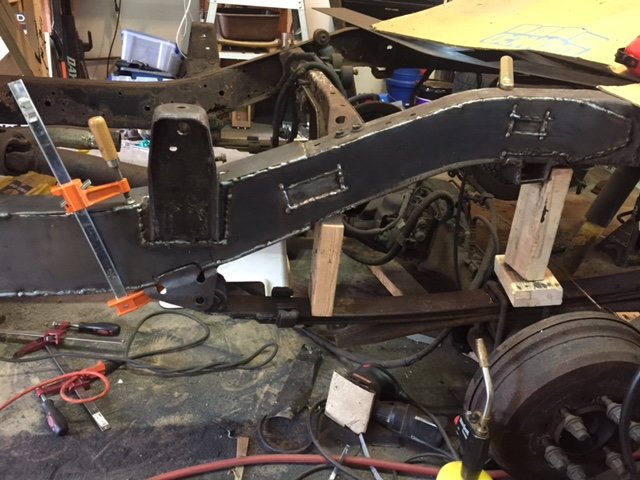

    The new frame piece slides in behind the cab mount just like I did with the crossmembers.
    You can see on the outside of the frame I was able to use several plug welds for added support.

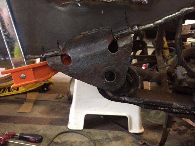

    At this part (right behind the leaf spring bracket) the frame transitions from being boxed to just being open C channel, and it actually gets about a quarter inch narrower. I cut out the rusted material so it's actually open which will give me a place to occasionally hose it out. I added a spacer piece, welded top and bottom, that the inner frame piece was able to be welded solidly to as you can see here.
    You can see in this last pic, too, that the leaf spring bracket inner "tab" was removed. The tab was actually 1/8 thick so by having it fit flush along the outside the bracket was properly placed left to right. I'll use some scrap (got lots of it) to make a new tab to weld it in place.
    I'll then drill evenly spaced holes along the bottom to allow for drainage.
    So there you have it. Same thing will be done to the passenger side, and then I'll start the coating...

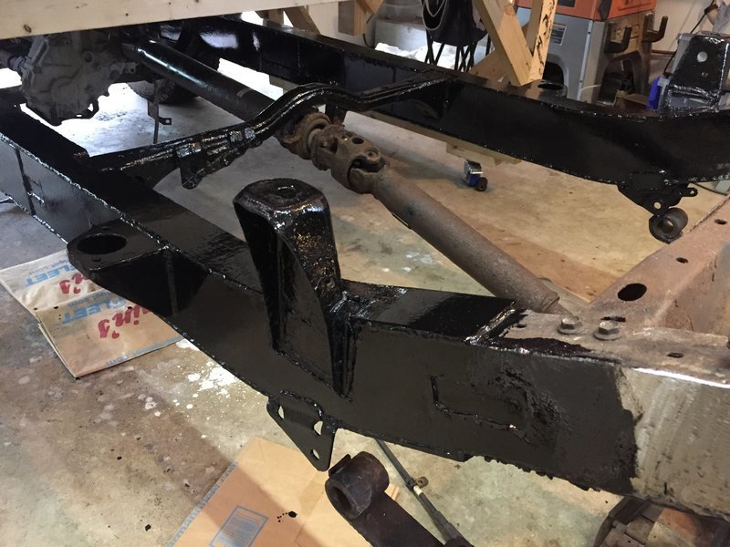

    First coat of Chassis Saver just went on! There is a light at the end of the tunnel...I'm going to do three coats, and the can says I can do a second coat after 3 hours, so I'll have three coats on by the end of the evening, hopefully. I work nights right now so I can stay up till the wee hours. I'm coating everything up under the cab first, and then I'll put the cab back on, hook up the brakes, and then pull the truck into the driveway to pressure wash the area under the bed since there are lots of nooks and crannies that are hard to get clean. Then I'll back it into the garage and paint the rear.
    The gloss black looks great. Brand spankin' new.

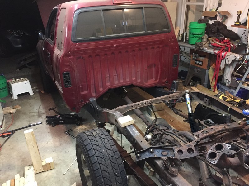

    Well, would you look at that!
    Long way to go, but accomplished a huge thing tonight by lowering the cab back down. Huzzah!
