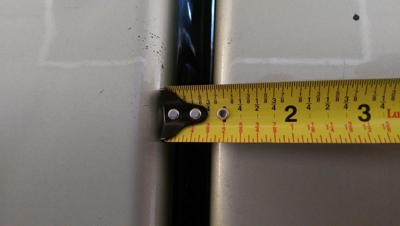

    Hey could you guys measure the gap between the bed and the cab on your trucks? What should it be? Thanks

    2009 TRD OR
    Stutely[QUOTED][OP] likes this.

    I think it is very likely my frame slightly sagged during the process. Which is annoying.
    But...I jacked the cab up a little today and slid stacks of grade 8 washers, and then the same for the bed.
    The result is:
    Compared to:
    So now there's a uniform half inch gap on both sides.
