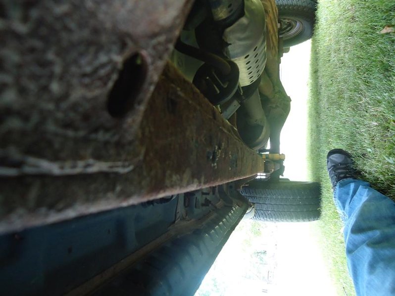

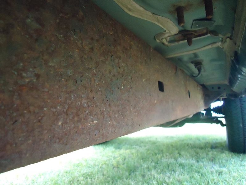

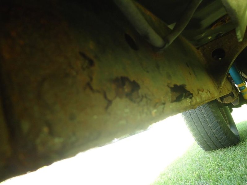

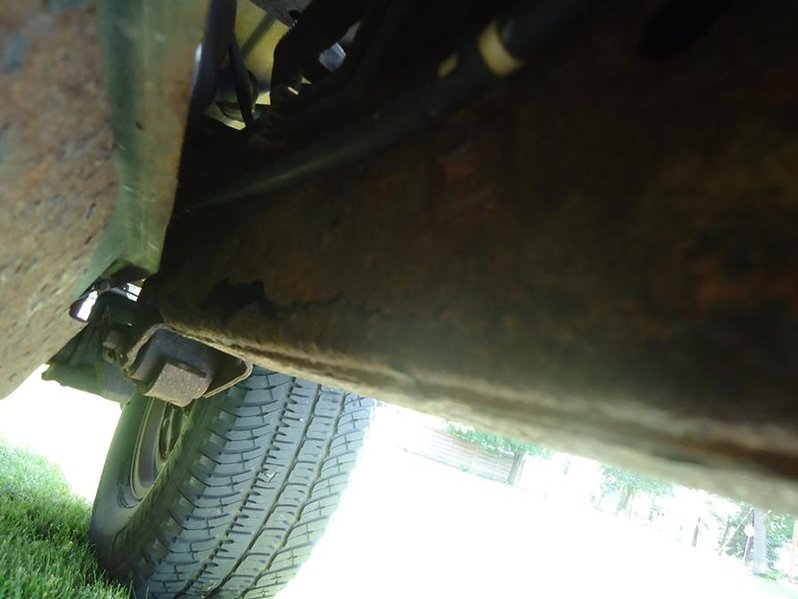

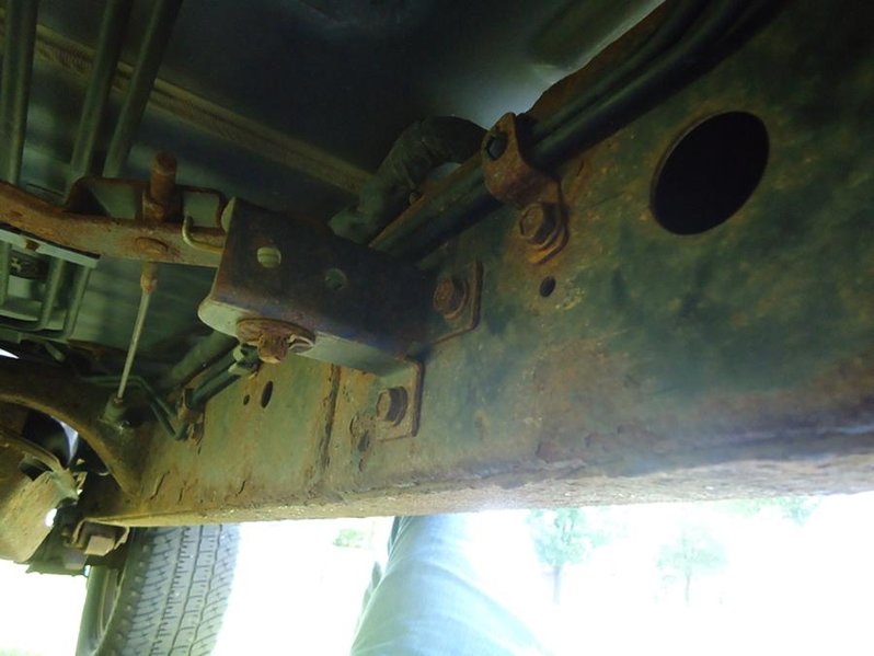

    My 2001 toyota tacoma has some frame issues and no chance in receiving a new frame as the deadline has past and I just bought the truck in May. There is a lot of good metal surprisingly to work with on the frame. The upper and sides have alot of surface rust but the metal is still solid on the inside I can still feel factory paint on most spots in the inside places where holes allow me to feel the inside portion of the frame except the bottom lower layer is rusting away fast. The passenger side is rusted bad on the bottom portion I know if i hit it hard enough I could make holes in many spots. The passinger side also has holes in under the passenger door on the inside portion of the frame see photos but there is enough metal to work with. The Rear portion by the gas tank on the driver side has holes near the leaf spring but there is alot of good frame around that area to work with as well. The bottom portion on the drivers side is quite solid unlike the passenger side but it is rusting from the inside out like the passenger side but still very solid. I am wondering if I can cut the bottom portion of the frame out completely and weld a new plate on both sides since the rest of the frame top and sides still feels very solid. I could also completely access the inside of the frame to por 15 all rails on the inside. If not I would like to overlap both sides with metal to strengthen the bottom portion the problem with that is the rust and dirt would still be trapped in there. I am also wondering how hard it is to remove the gas tank and box. I would also like to know how hard it is to lift up the cab enough so I can take car of the surface rust on the top rail of the frame. The front of the frame appears to be very solid still. I would like to rid the frame of most of the rust then por 15 the whole thing. If anybody has done anything like this please give me some help or direction. A swap is to much work and finding a clean frame in Minnesota is imposable anyway. Any help would be appreciated I'm in River Falls WI which is 30 miles east of the twin cities.

    That looks like a nice project most of it looks like you could hit is with a wire wheel and re coat it with some POR 15. That Passenger side looks the worst but it looks like it could be cut out and have new metal welded back on. I agree though If what 93toy says is true I would look into that first.
