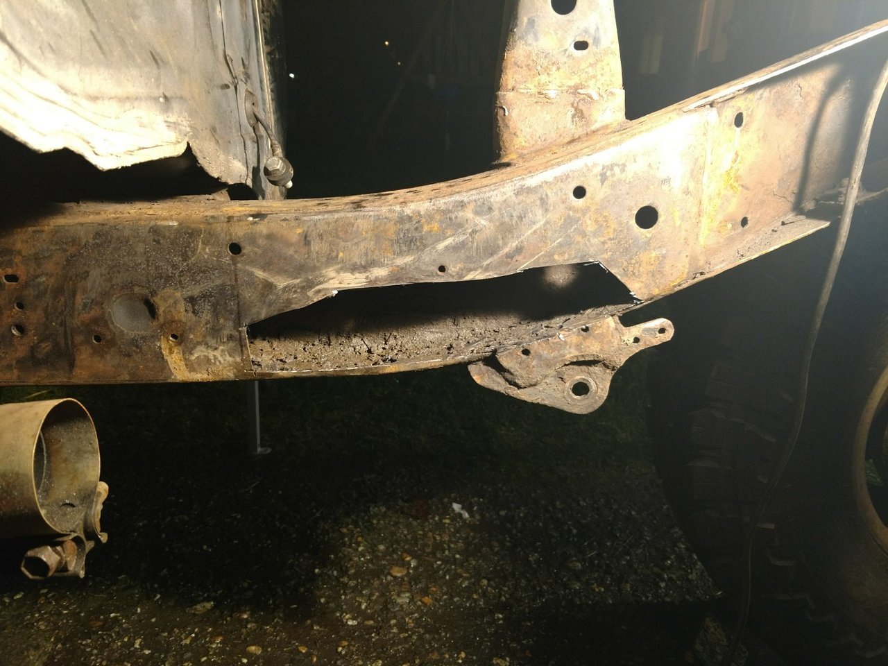

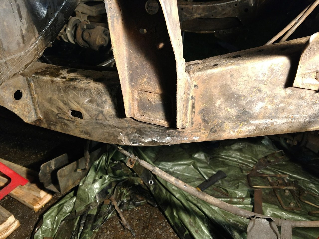

    Here are some before and after pictures of my 2001 Tacoma frame rebuild. I had severe perferoration around the driver's side front spring mount which required a patch of about 18 inches by 4 inches. The rest of the frame, trailer hitch mounts, and back two cross members were rusted pretty severely and only required a few small patches and a good cleaning and treating. I used a DA grinder with a wire wheel or sanding flap wheel for most of the clean up, then treated and coated the parts and frame rails all of the way up to the front tires with POR-15. Then I top coated that with VHT Roll Bar and Chassis paint. Let me know what you think! I estimate that I put at least 120 hours into the job, and my friends added about 16 hours of welding and helping me reassemble the truck. I used as much new hardware as I could find and cleaned up and reused the rest. Besides the patched-in metal, I bought a new spare tire carrier and reel assembly. Everything else was reused.image.jpgimage.jpg
