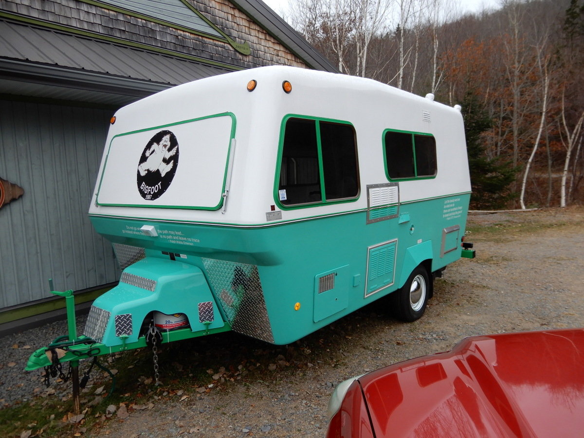

    I just purchased this 2012 Access Cab with Cap in early October from St Catherines, having flown one-way from Halifax to pick the truck up. I did this for the sole reason that this truck has the vaunted 6,500 lb TP {Tow Package}. We are rebuilding a vintage B-17 Sasquatch. Alas, there's plenty of rust on the undercarriage despite the low kilometres; i.e., 145,000 on the odometer. The spare had never been dropped, sporting all the nipples on the tread; yet, the metal 'round the valve stem was so rusted that the tire could hold no pressure. 'Sides, the stem was against the floor so an owner had no means of accessing it short of dropping the tire, which, we did. I am now concerned for the rusted underbelly. While waiting for a front hitch to come in for a CTC snowplow {we have an 800' driveway in the woods here} I scraped and wire brushed and blew off with compressed air what I could, waiting for a 10° C day to first use a rust converter then a black Tremclad. I have the K'ville dealer looking into this. I'm sorely disappointed!!!

    Thanks very much for this speedy reply. The local dealership is looking into the entire matter now. It's a real shame with these Tacomas having a virtual cult following. Yeah, strong motor. No question. This frame issue is catastrophic, since that's the foundation of any vehicle, {along with the motor} as I read reports from others. It takes some getting used to with this truck being two years older than the '14 Accord I sold to purchase this. I have to duck my head each time I enter and exit and I'm only 5'11-1/2" not quite a man yet.
    The seats are underwired, yet there's no heated seats, nor motor-driven movement, no heated mirrors and a fan on low speed, that's quite audible and that's with my hearing aids not installed. hahaha. I'm glad it has a CD player as most newer vehicles do not. Lot's of rear tire noise echoin' under the cap at back, so when spring arrives, I may investigate soundproofing the entire cab. Unsure if that's worth the effort. Too much woodworking high frequencies, will do one's hearing in sooner or later even with insertables and muffs. Essentially it'll be a very good drive to pull our vintage Sasquatch.
