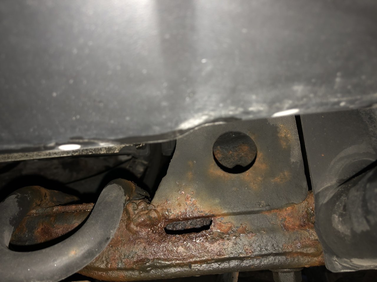

    The cavity stufff they used really seemed to hold well. I had spent a lot of time under it trying to save it. Pics are after a year of not doing my rust inhibitor. I’d clean and treat after winter and before winter.
    18406C16-AF0D-4436-9209-1A3F0D41D9C6.jpg 8D3F52E5-3E20-4DA3-B1B8-134F0515D17B.jpg
    1st photo my old frame on top of the last one he did.
    2nd photo is why I failed.
    Front cross member by the tie down driver side.
    Seems a weld burned thru or something?
    New frame is solid weld on bottom of gusset mine was not.
    Don’t trust your dealer!
    Got a local shop you trust?
    Ask them to put it on a lift so you and them if needed can inspect your frame. The tech there was more willing to hit stuff harder than I.
    Know your truck if plan on keeping it.
    I have had mine back now for 3 days it is amazing.

    Jeffch, thanks much for posting the pics. Actually, my frame looks much worse than your old frame but I'm gonna get under there and get a better look soon.
