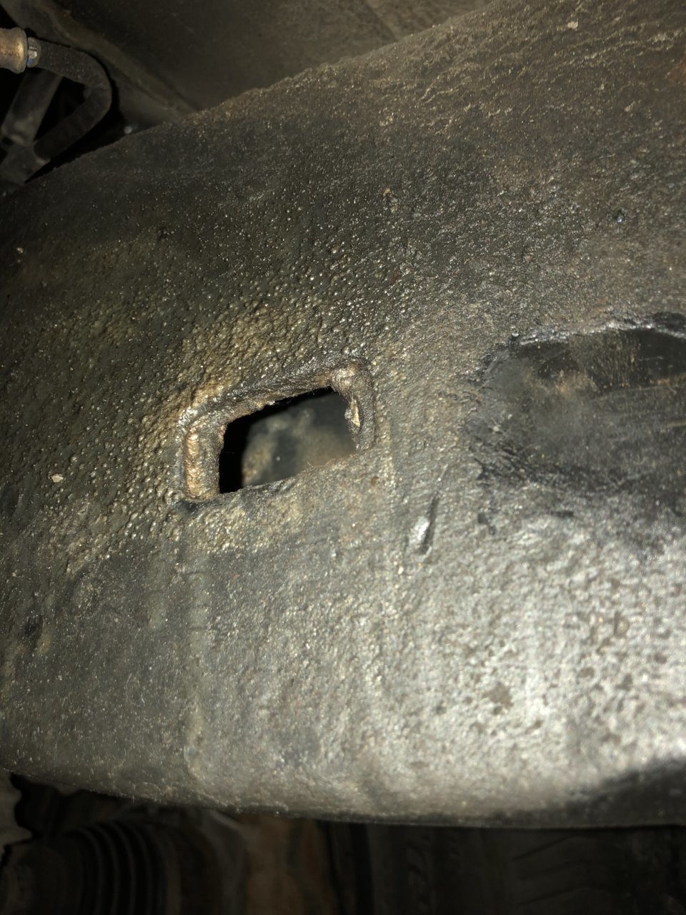

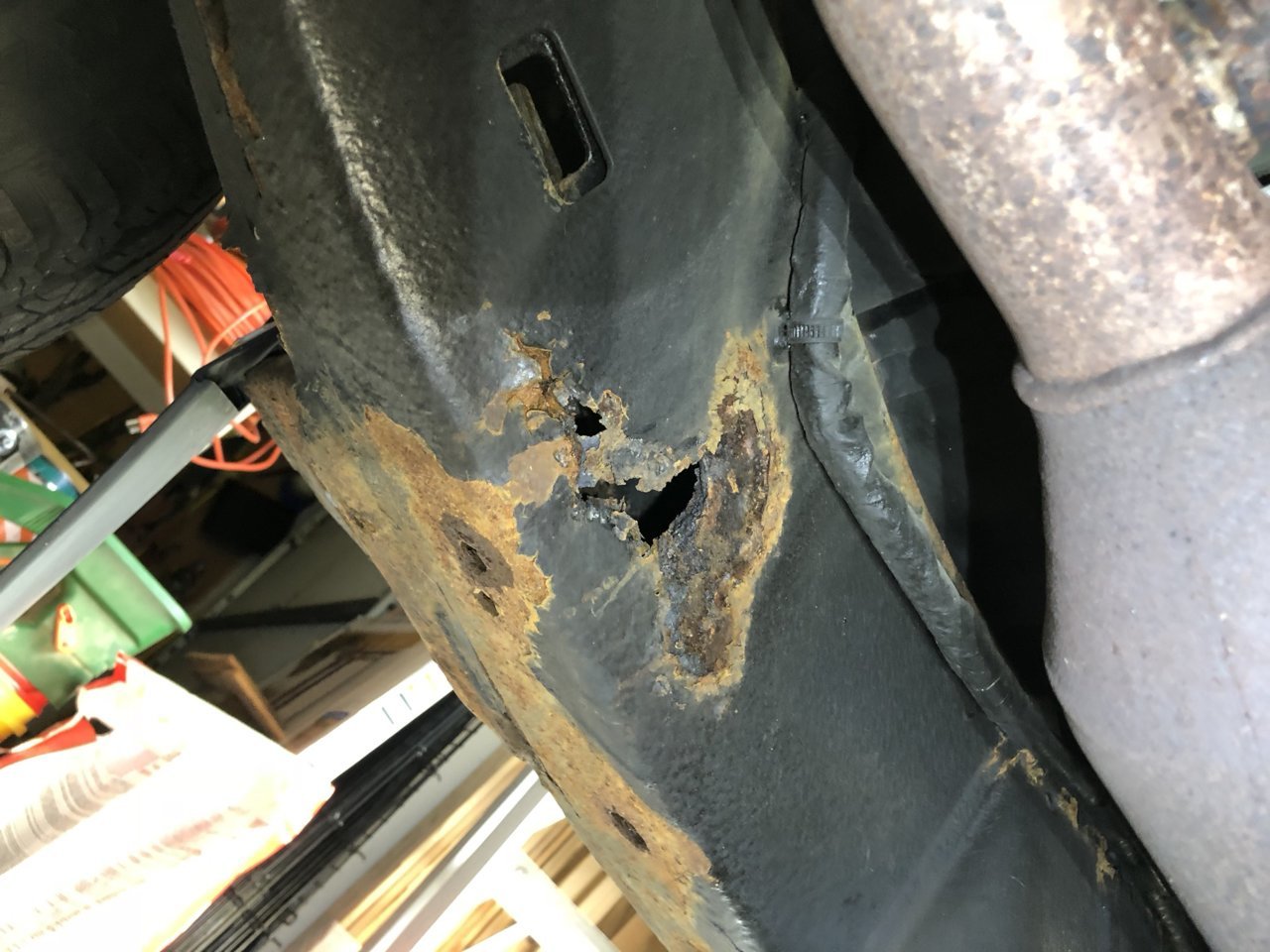

    I was in that boat also.
    Your covered by the suit for 12 yrs from in service date. 2021 or 2022 sometime for you. It ain’t over yet get under it and inspect it yourself with a ball pien. The crc won’t last long if you have rust now. Some pics would be good. I spent a lot of time trying to save mine but still lost the war thank god!
    This failed mine.
    Don’t trust the dealer!!
    Mine was coated 3 yrs ago noticed this like a year later not as bad as this but yea they tried to bury it to outlast the original lsc for frame corrosion.

    By the catalytic converters around this opening.
    Above the spare tire.

    My hole on the starboard side directly across from the converter.
    Did the dealer actually tell you a replacement frame is available if the crc failed, before your 12yr wep?
    There is some controversy about the “squirt and done” crc and any future claims against Toyota. When I read the wep, it only says it covers previous crc treatments not the wep treatment.
    Get it in writing. Or not get the squirt done until later. It’s not of question if a hole will appear, just when.......

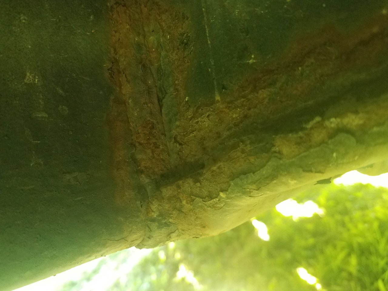

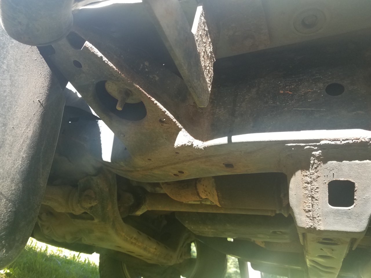

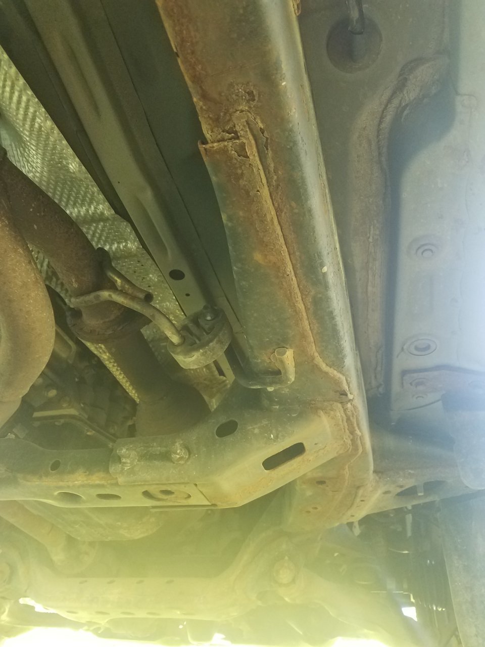

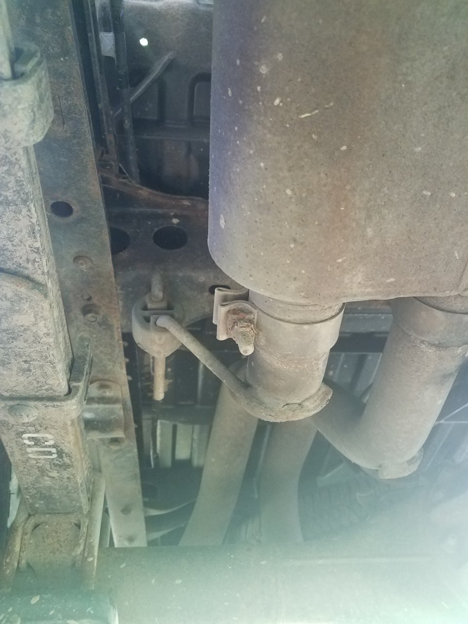

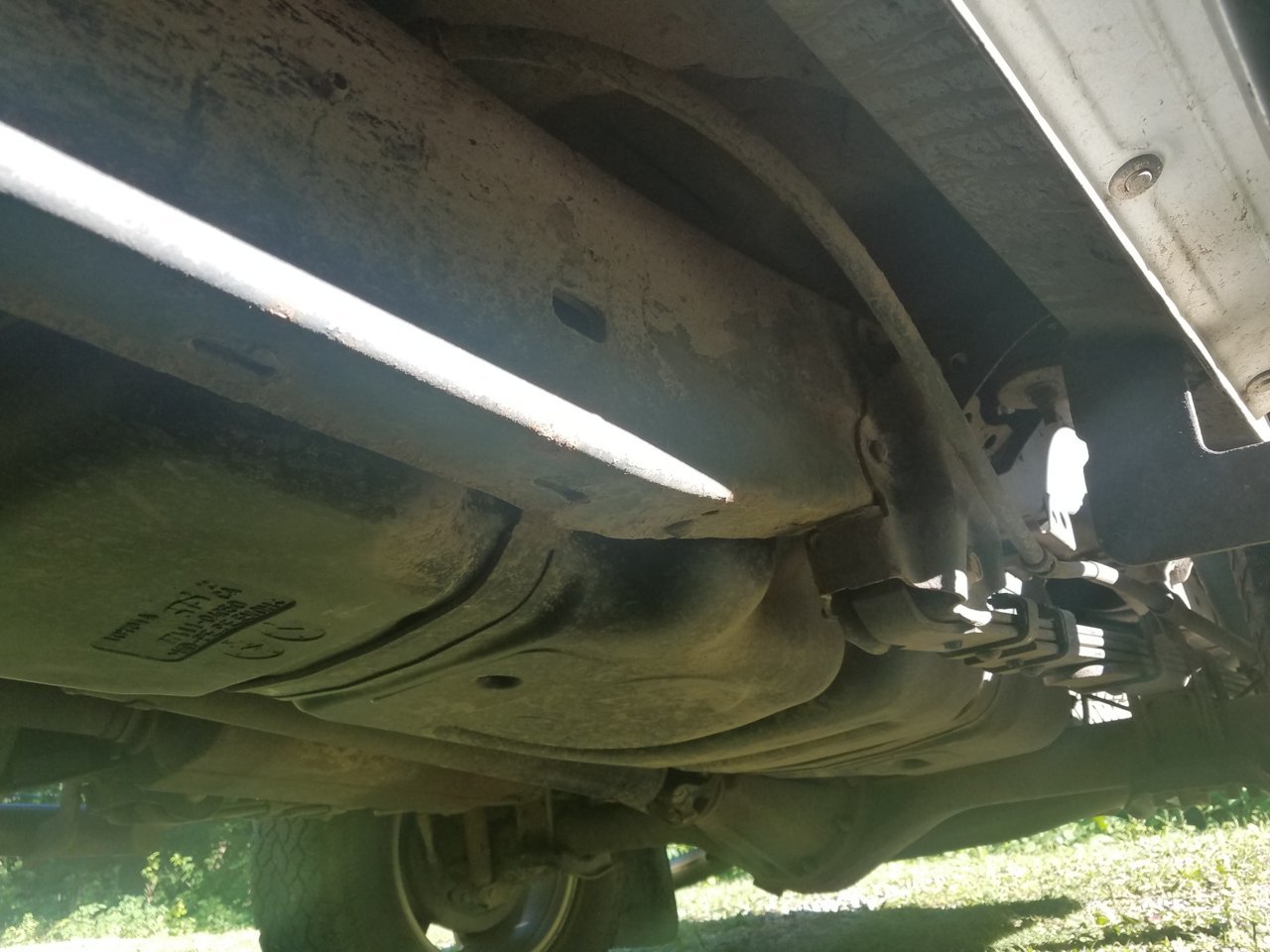

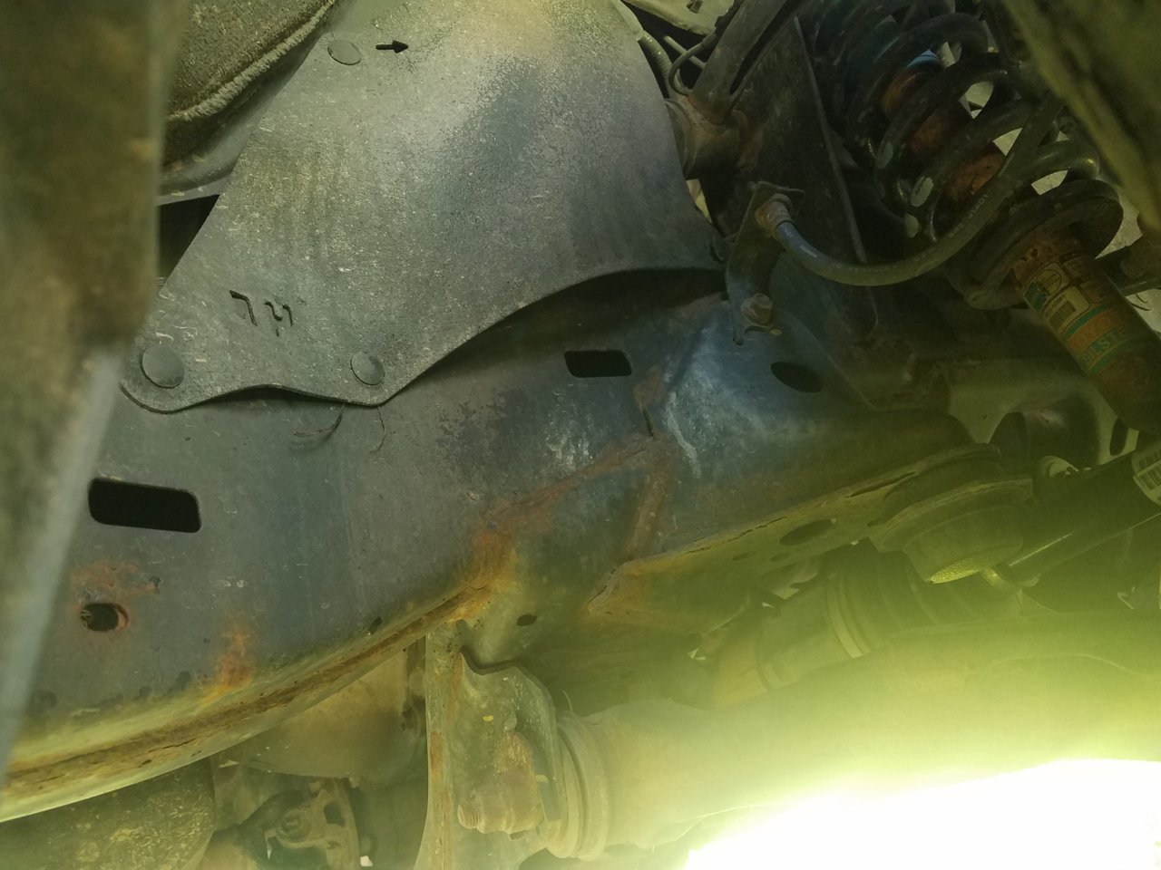

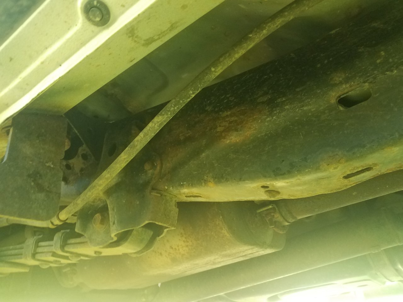

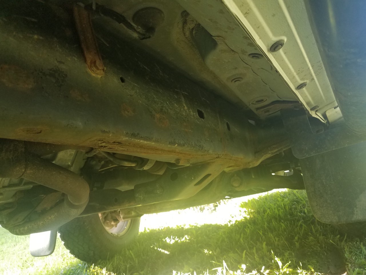

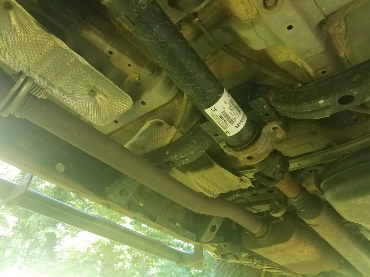

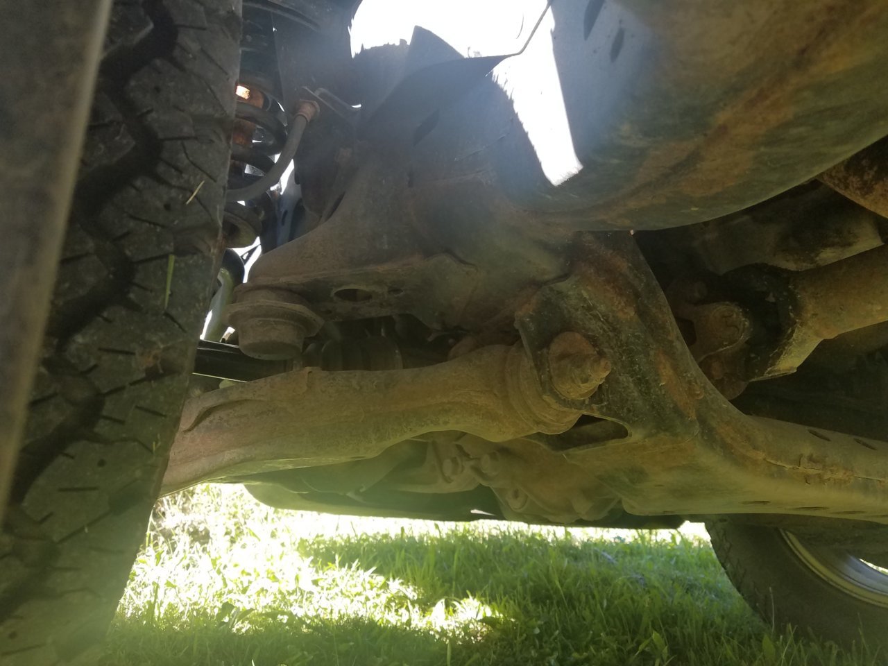

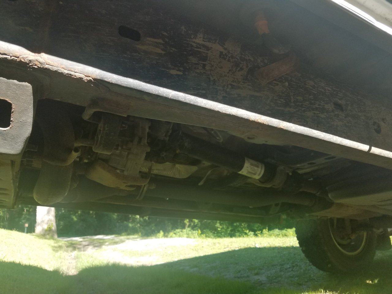

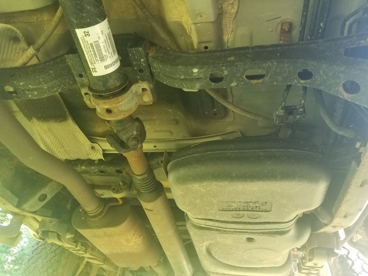

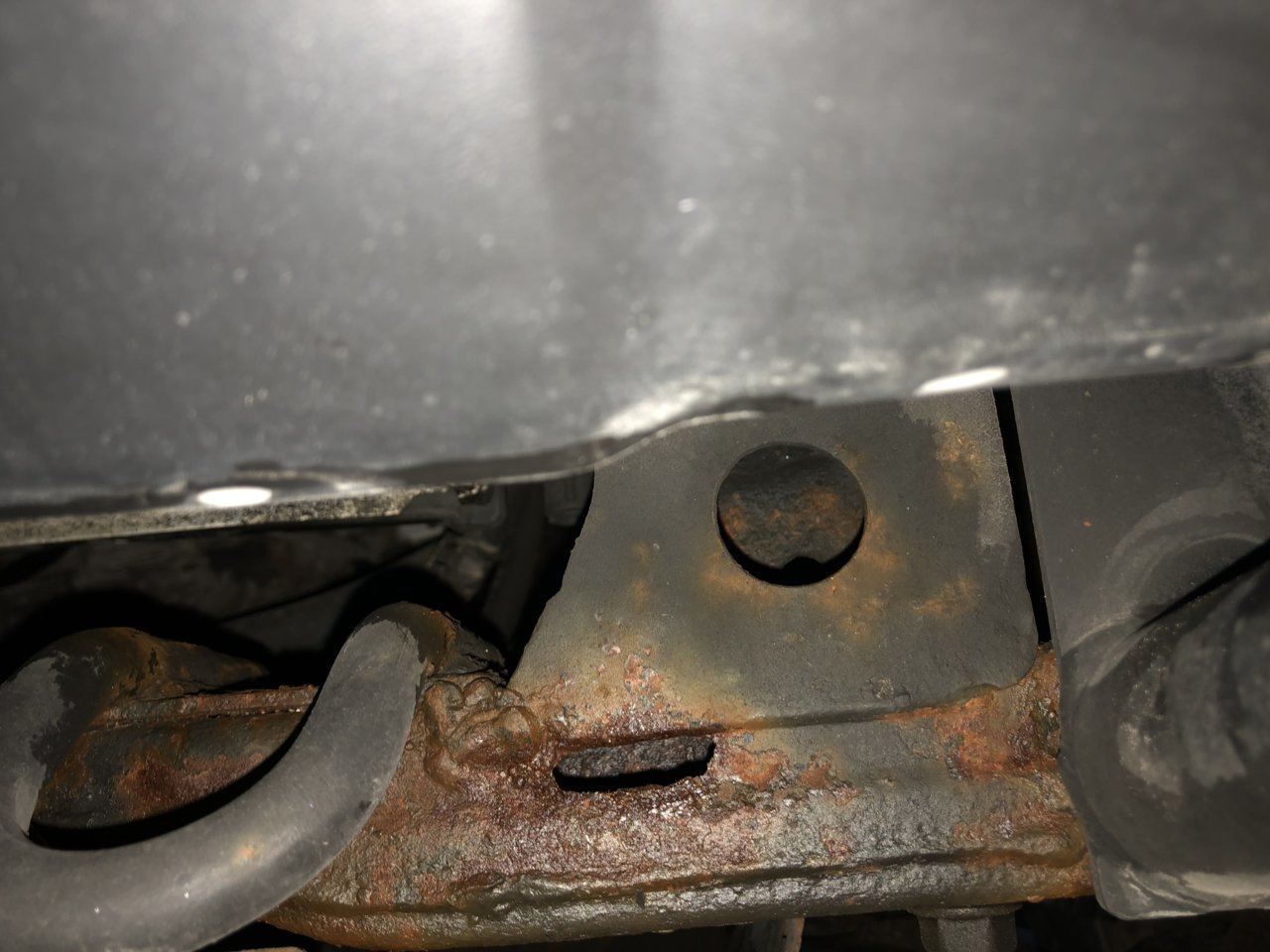

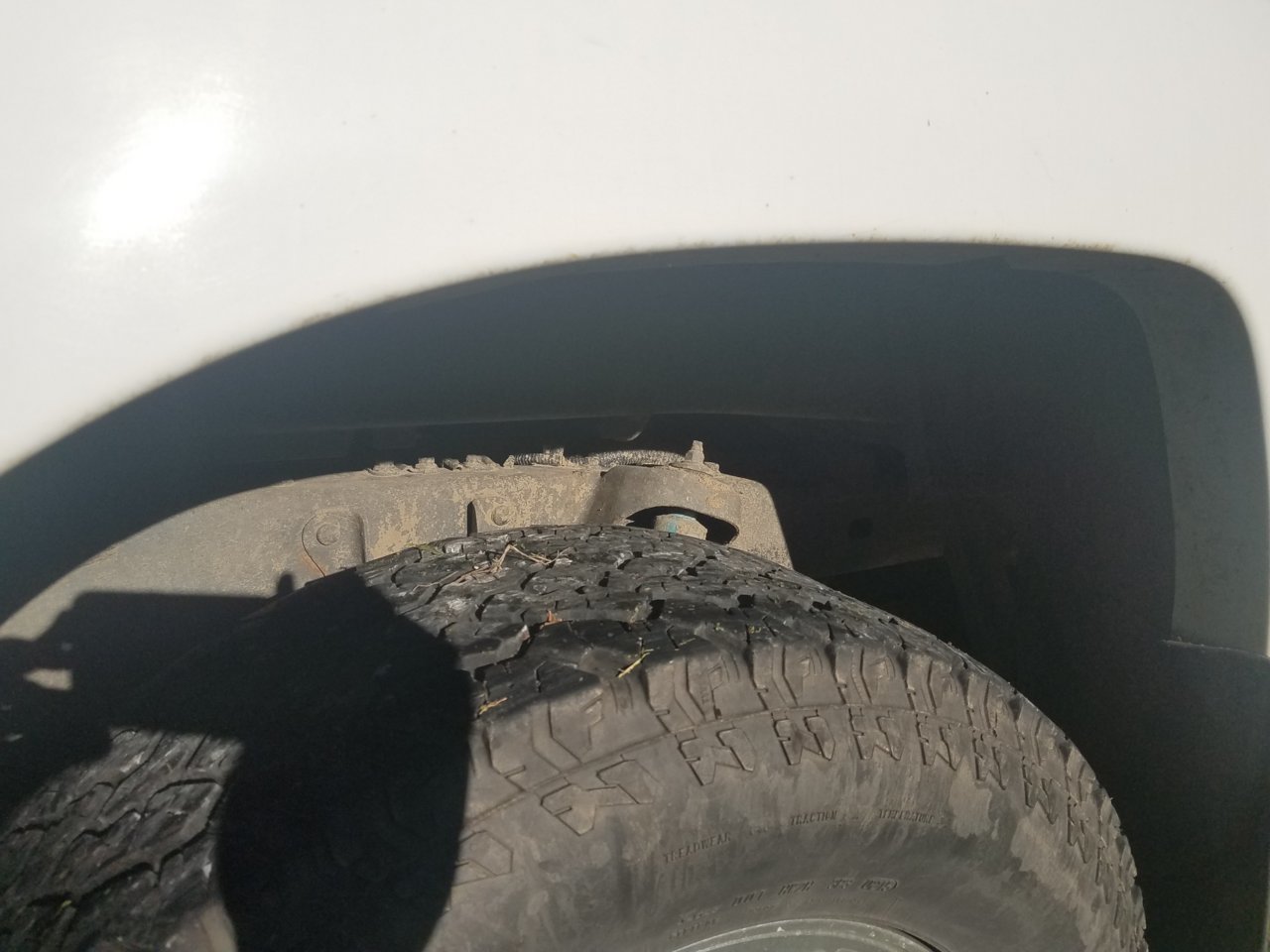

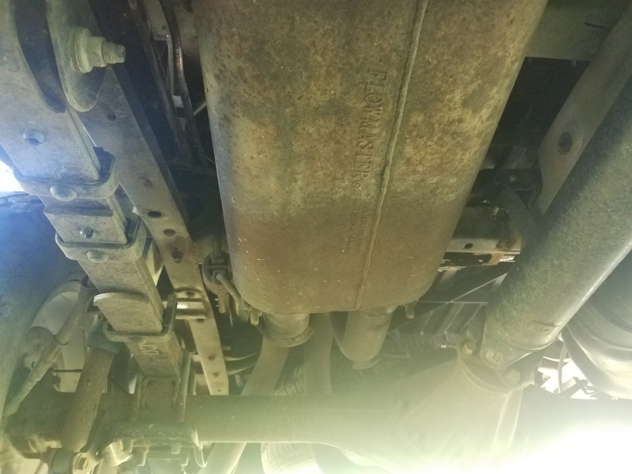

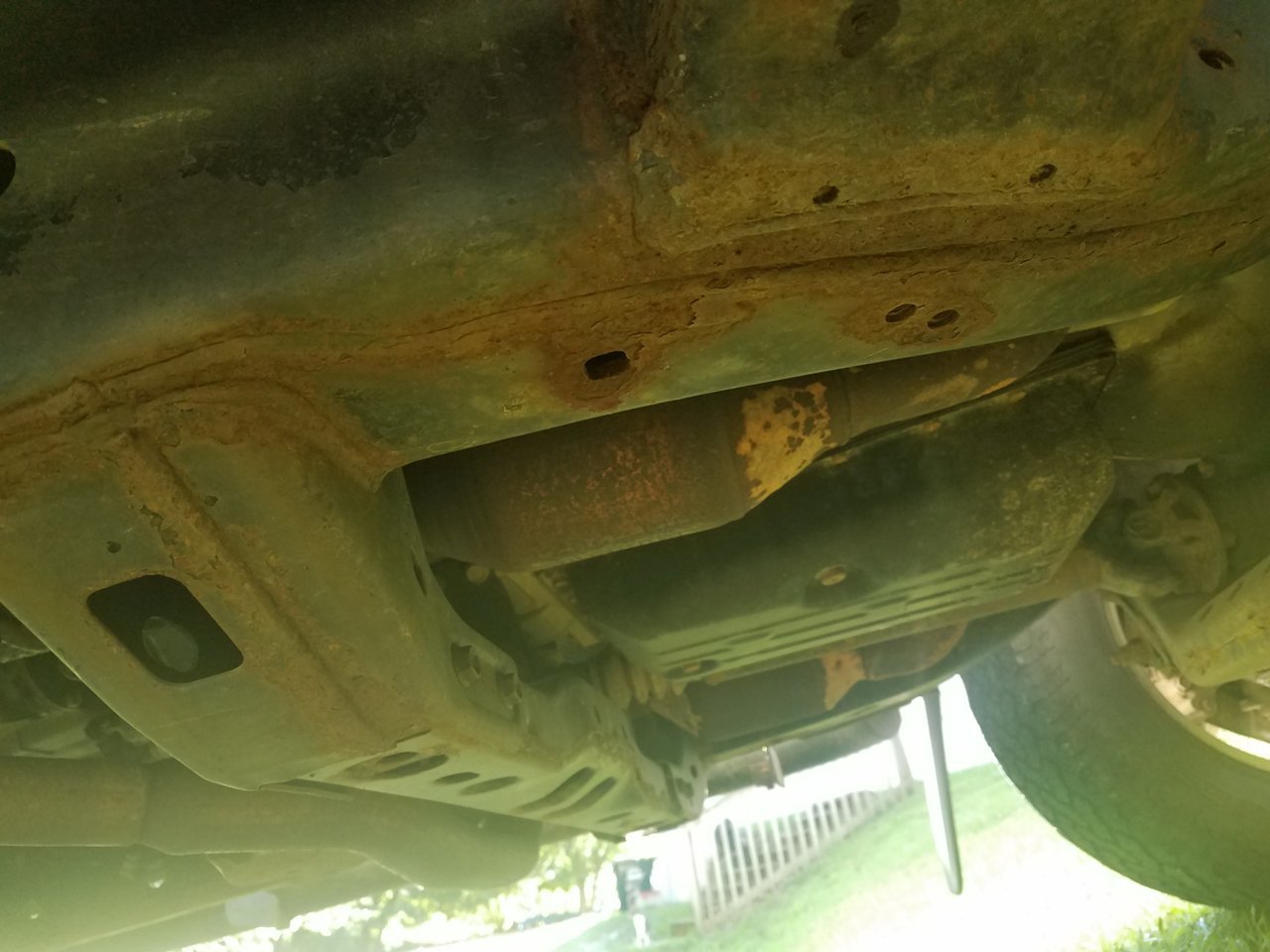

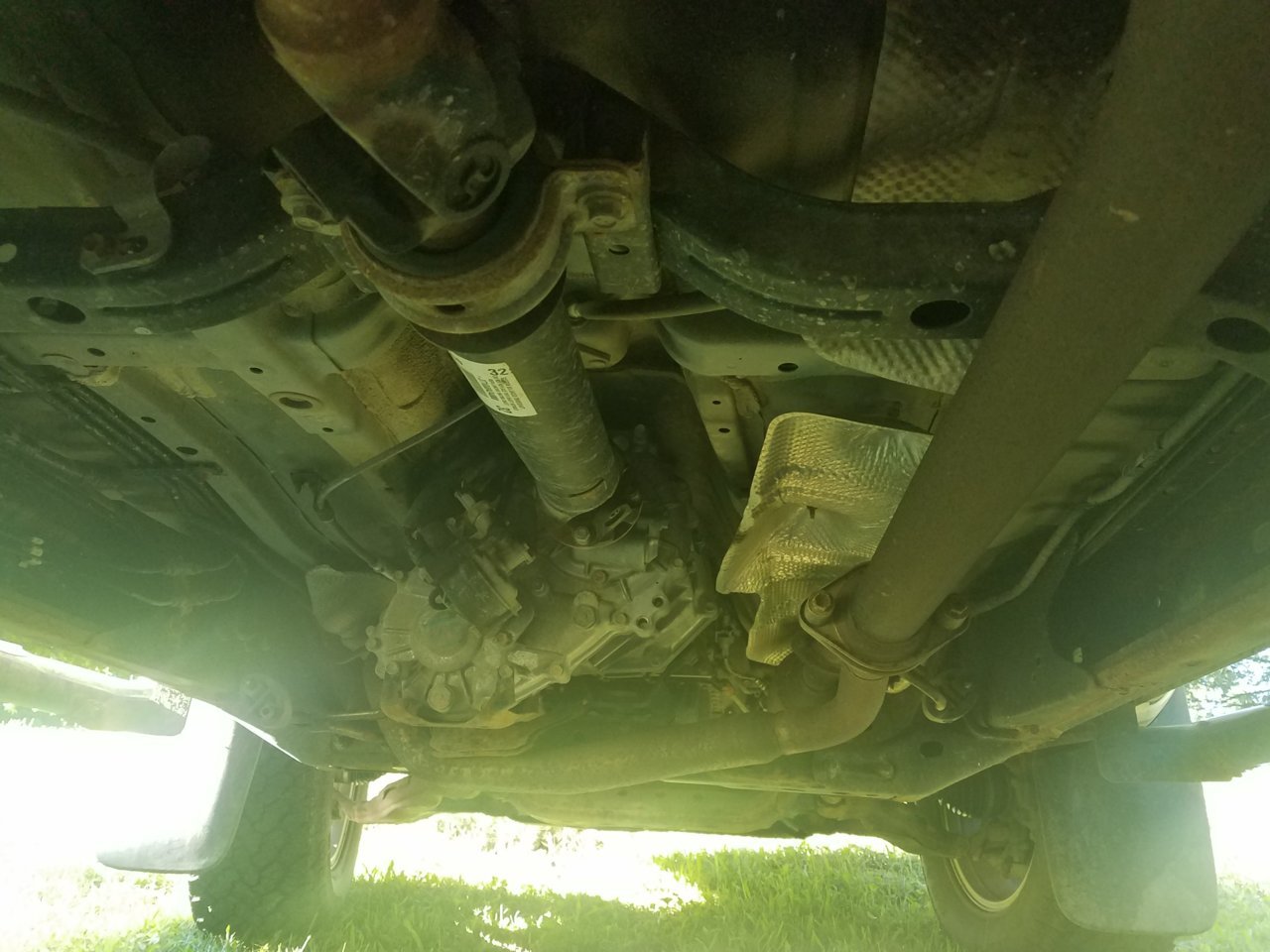

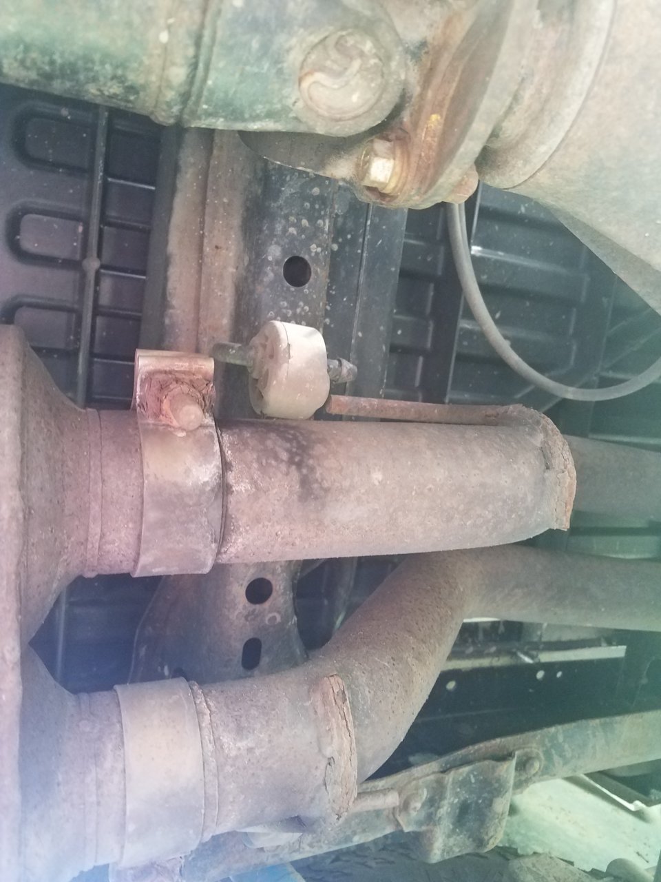

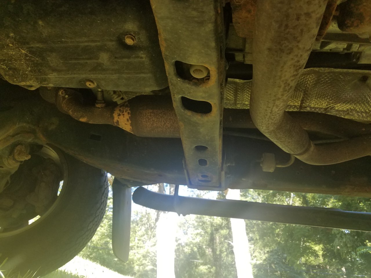

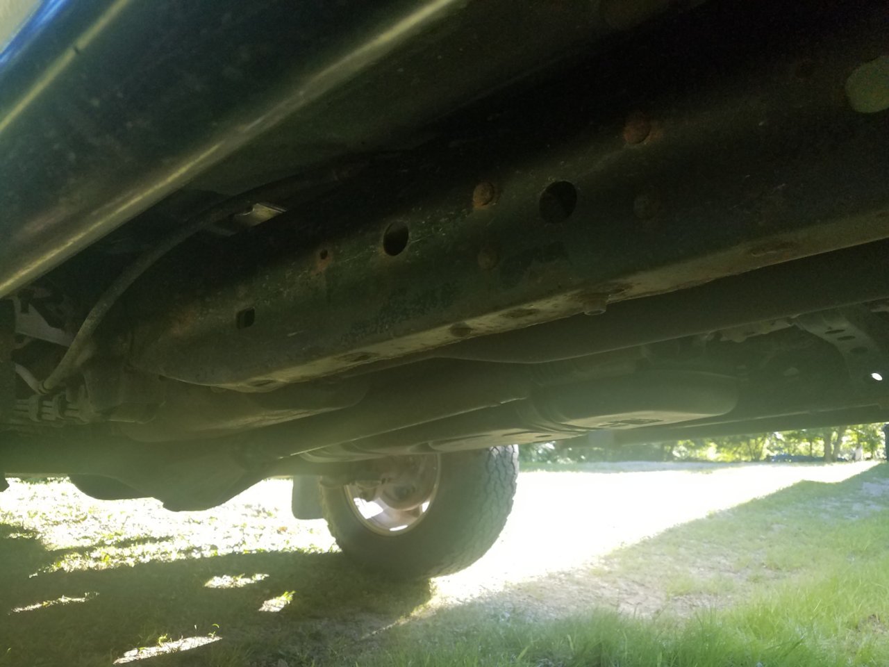

    Ok, so sorry in advance for so many pictures was a little unsure of exactly where to look but i think i got most of it covered, lighting sucked in some spots but here is my frame at 185k, do you think maybe the frame rot has started?20180707_184730.jpg 20180707_184734.jpg 20180707_184742.jpg 20180707_184754.jpg 20180707_184814.jpg 20180707_184820.jpg 20180707_184825.jpg 20180707_184847.jpg 20180707_184925.jpg 20180707_184939.jpg 20180707_185019.jpg 20180707_185039.jpg 20180707_185059.jpg 20180707_185105.jpg 20180707_185140.jpg 20180707_185149.jpg 20180707_185202.jpg 20180707_185328.jpg 20180707_185351.jpg 20180707_185502.jpg 20180707_185432.jpg
    CharlieVictor, Jeffch and dborrer[OP] like this.

    Frame replacement time. Yours looks somewhat better than my 2007 did at 65K miles, but seems to me you had a couple of money shots in there.
    BTW, the dealer tells me my frame replacement should be done on Monday, so I'll soon let y'all know how it turned out. My truck has been in the shop since late April, so it's going to be interesting to be back with it...

    The issue i have is they already looked at it a few months ago and said there is no perforated rust so we are going to under coat it. It goes in on Monday :/ i would much rather have a frame replacement but how do i convince them otherwise? does it work to there benefit to do frame replacements? I.E they make a lot of money from charging Toyota?

    Go to a different dealer... that frame is toast

    Let them coat it!
    They will not do a good enough prep for it to stick.
    6-8 months it will start scabbing where rust is growing.
    Your frame looks like it’s got some spots but by 2022 they will be holes.
