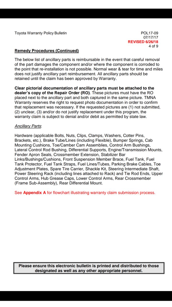

    My truck has aftermarket total chaos boxed LCA's an dthe list that my dealer gave me showing replacement parts, included new factory LCA's. So it would seem that the LCA's are a package deal when replacing the frame.

    This is the first I'm seeing a list of ancillary parts :thumbsup:, glad I stumbled in here, but I'd wager that "If needed" is the key phrase there. It also would need to have been damaged during removal as part of the frame replacement process. "Normal wear and tear" is not covered or considered a justification for replacement.
    For instance my rack and pinion is blown out and should be replaced, but I'd be paying for a new one out of pocket, vs toyota replacing it under warranty as an ancillary part. The lawsuit uses the term "incidental" in relation to parts that can/should be replaced during the warranty procedure. Basically if said part failed or was broken during the strip down of the frame being replaced or due to rust and corrosion, such as a rear shock rod end breaking or say the R&P ends up with a bolt broke off inside the housing, it should be covered and replaced at no cost to the vehicle owner.

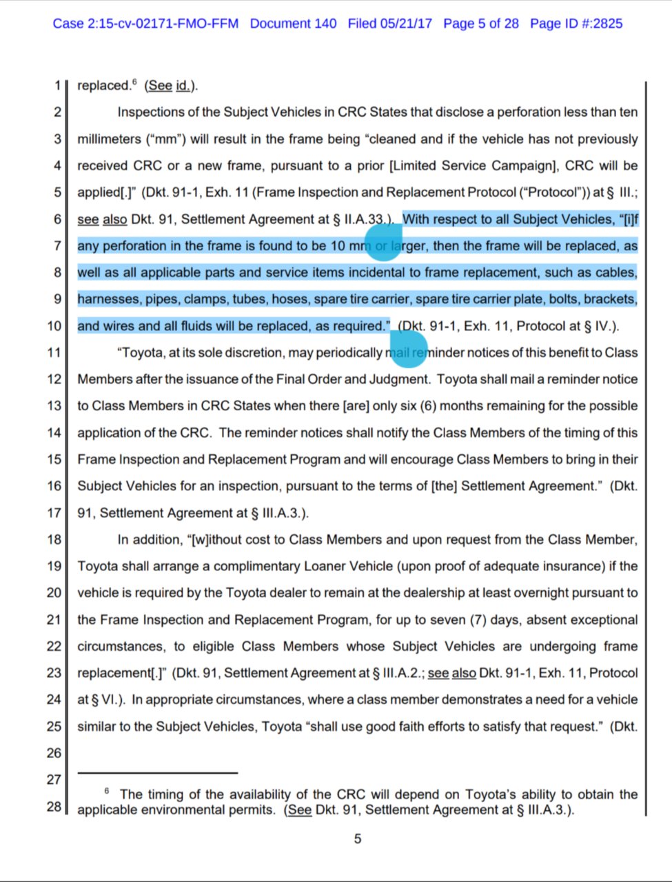

    Here's a screenshot of the final order per the class action suit dated 5/21/17.
    I'm guessing since theyve been doing these frame swaps pretty regularly, they've extended coverage to include other specific items that may be affected with this revised dealer bulletin, dated 6/26/18.
    I'm currently waiting for my replacement frame to arrive. My 06 qualified at the very last hour, and at the discretion of a corporate service field tech. I ended up in a game of ro-sham-bo with the dealer, they claimed I drilled holes on the frame. After I made a call to corporate to complain followed by a few negative reviews about the dealers service dept on social media, my frame was approved.

    Agree, magic word is “if”. My tie rod ends came off fine in the during the removal and could have gone back on. But they were wearing, they called and offered to put the existing back on go new. Open wallet, bought parts, labor free.

    I believe, if I'm reading it correctly, that stabilizer links are covered as cited on the paperwork posted above. Learning point for someone else maybe.

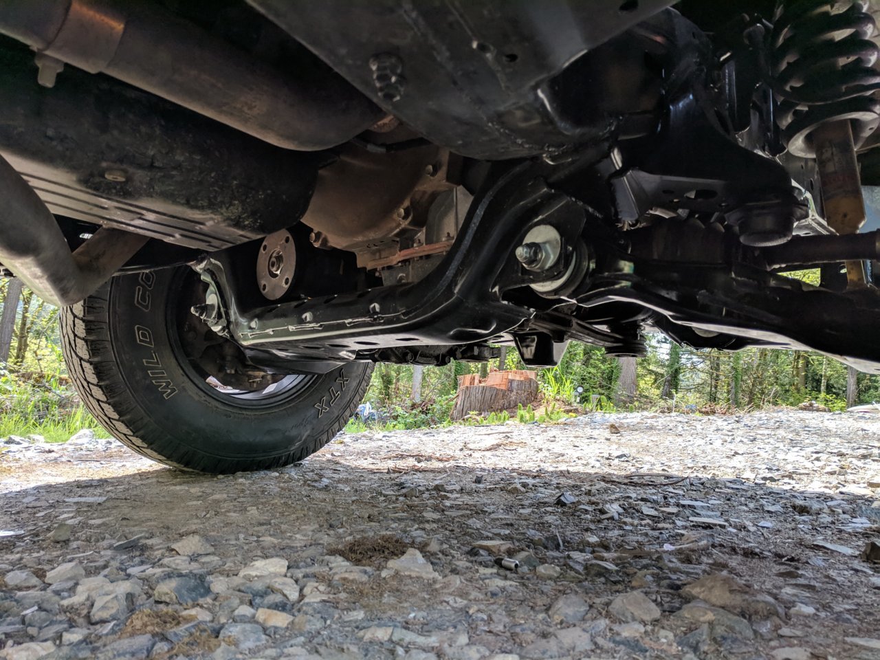

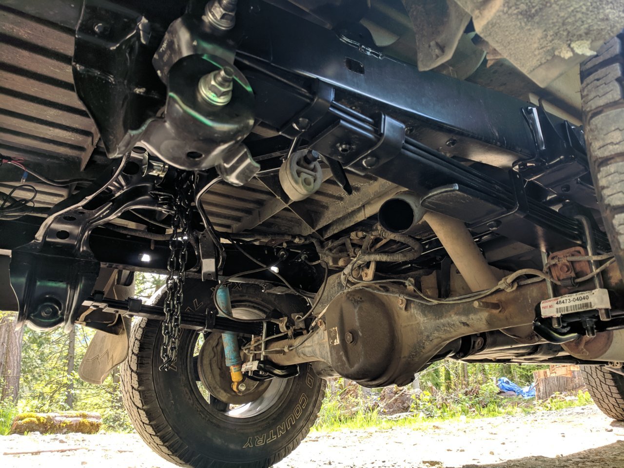

    Just got my truck back today. It took an additional 5 days from the original projected completion date. I should have got it back Monday the 22nd, but just picked it up Saturday the 27th. No additional cost to me, but did receive additional electrical headaches. Started off with a major misfire and a p0351 code. They fixed that which was a loos pin at the ECU where plug E4 of the engine harness plugs in. That was followed by a p0974 code for the S1 solenoid in the transmission. They found a loose pin at the transmission wiring harness. It seems they where a bit aggressive when removing plugs and compromised pin/wire connections in the plugs. Truck now runs the way it did prior to the frame swap. New frame, new LCA's and new rear leafs with shackles and ubolts etc.

    Your front driveshaft is missing!! See second picture. Skidplate and spare tire are missing also. What a bunch of hacks that dealership is. Id be raising hell!!
