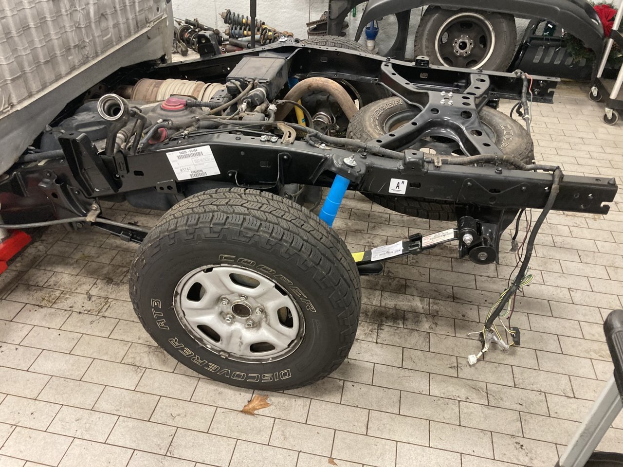

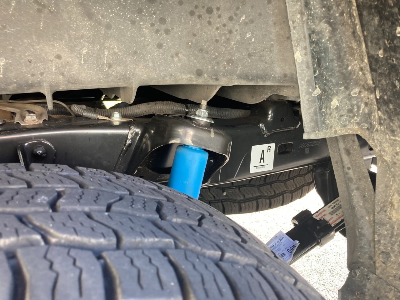

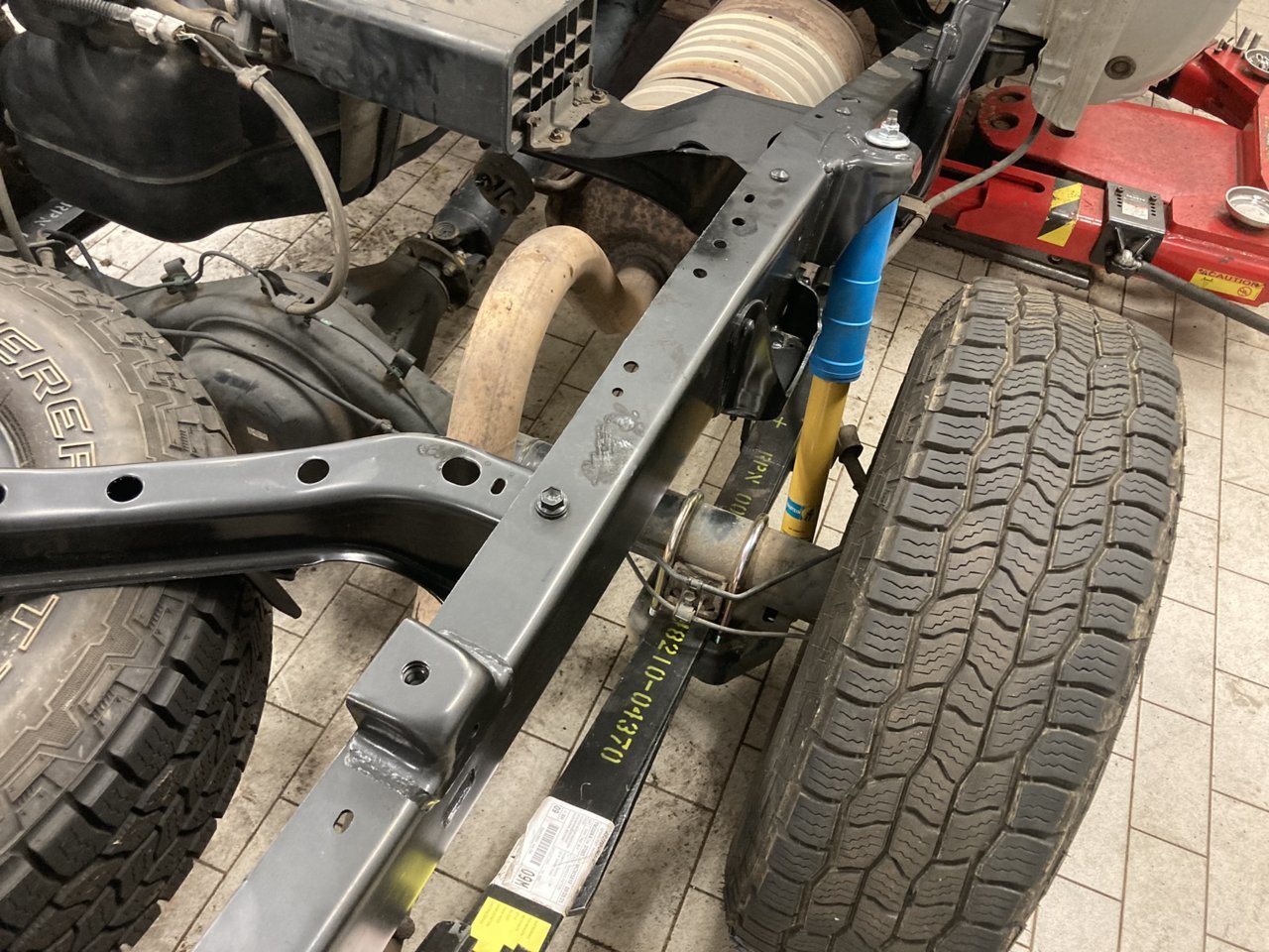

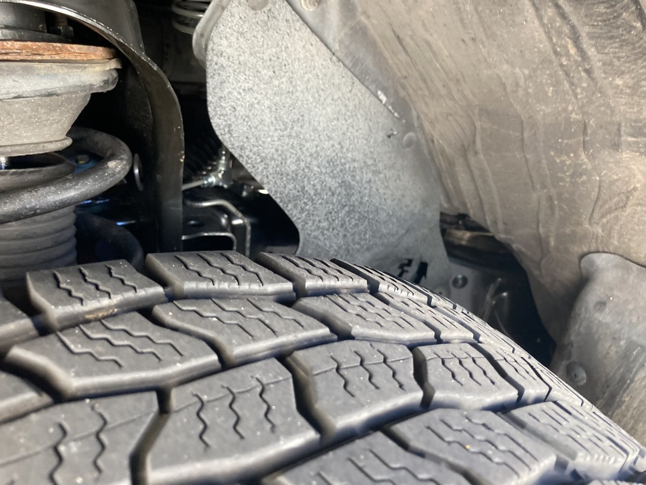

    New Bilstein shocks...
    A7A5902B-7143-4922-B724-C1AB6F7EE289.jpg DE2F094D-6CC4-4AD6-AF6A-7D7BF0FCCAD9.jpg

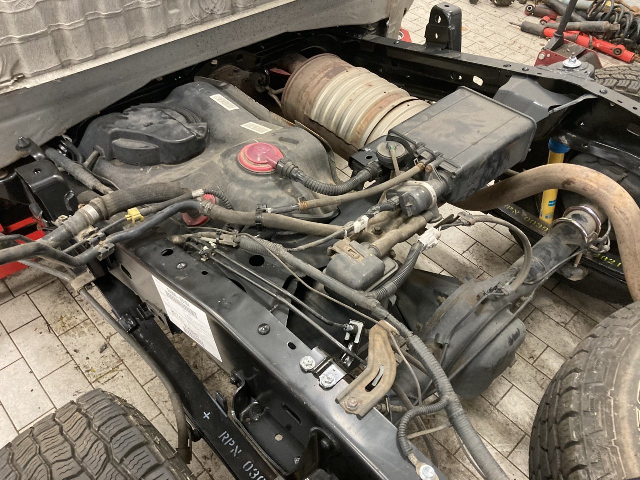

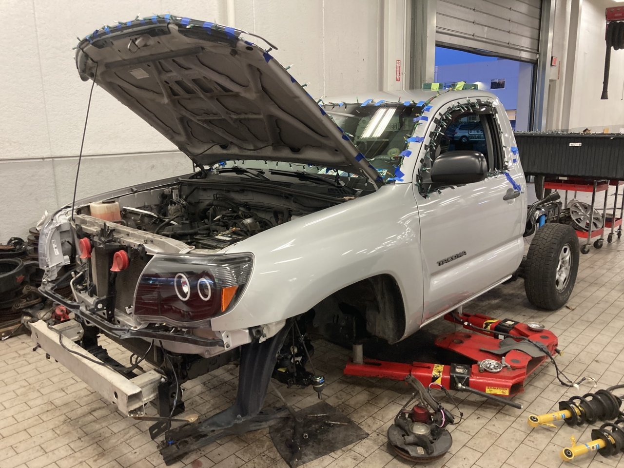

    Emissions-control stuff that I didn't even know existed until I saw my truck with the bed removed...

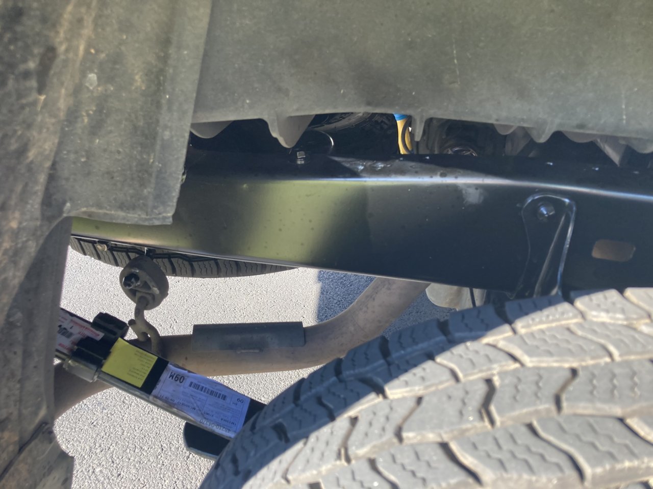

    I have given the new frame a coat of Fluid Film since these pictures were taken...

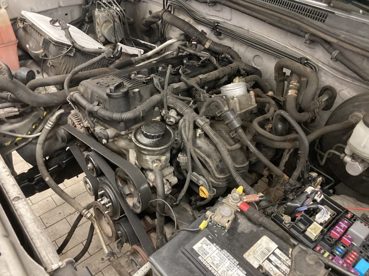

    Engine back in place...
    Jab969 likes this.

    This is where it started to resemble a truck again, instead of a 2-ton jigsaw puzzle...

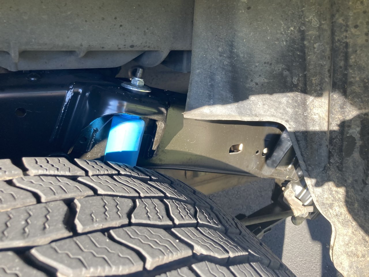

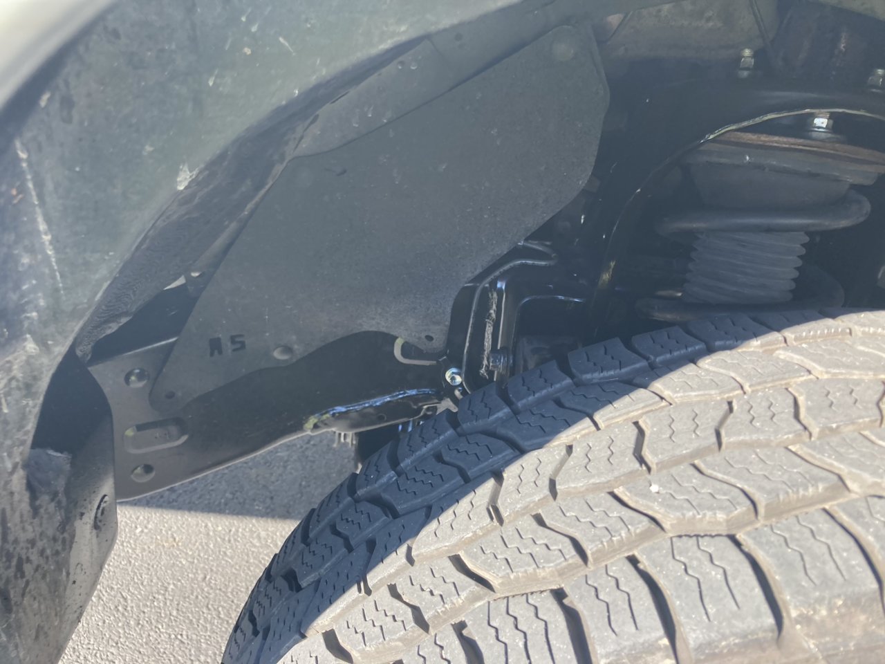

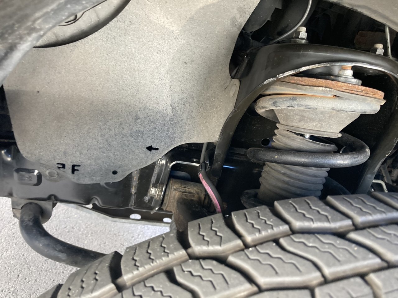

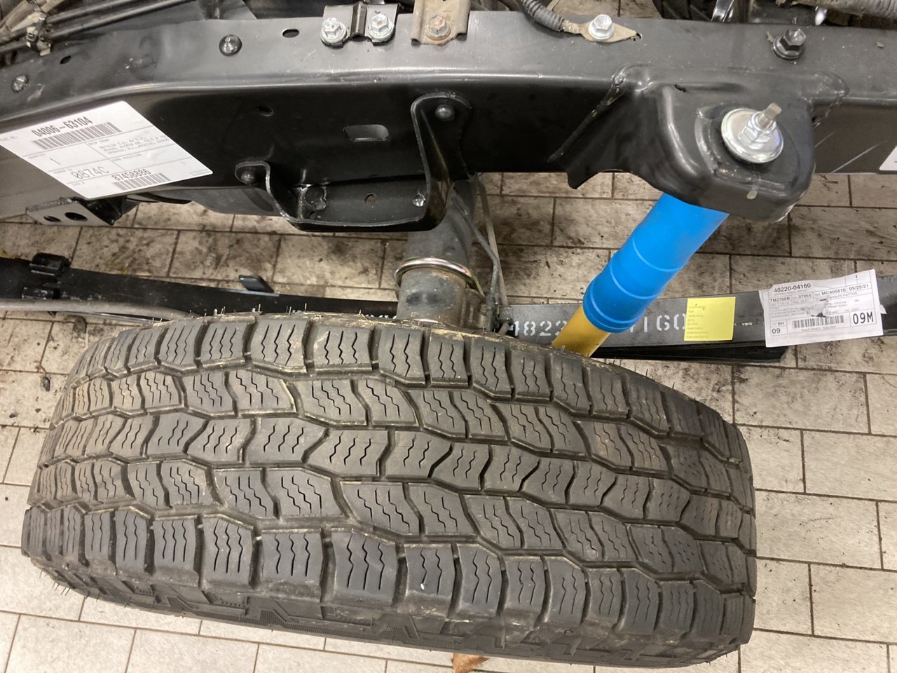

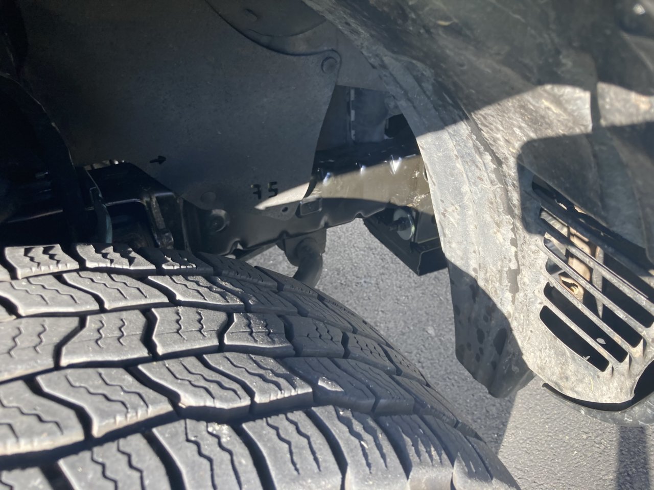

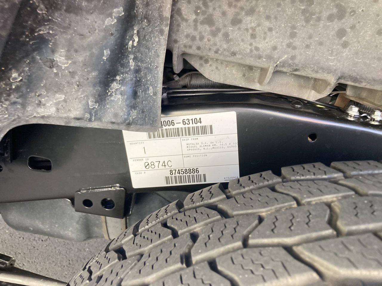

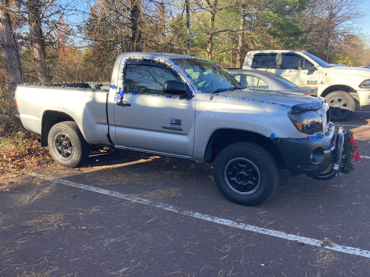

    Immediately after getting it back...
    C5C21EF1-33BE-49F6-AA8D-13B57EDBDDCA.jpg E49CFF33-8833-4780-8DCC-6445C2997E11.jpg 6660E493-C7FD-4822-82B8-9F83033789BE.jpg CD9B7432-B84B-43D1-B011-9FD9969BC459.jpg ECF0F7CC-C272-4583-9592-C51EF3808A85.jpg E5B80341-D502-47D2-8A48-79C587776519.jpg 1CC86CF5-E266-4759-816E-DC9BD681B08B.jpg 2DC0285A-513C-4963-BB3C-F30CAF5E028F.jpg
    Jab969 likes this.

    I had to bring my truck right back to the dealer because it jump out of drive and into neutral every time I hit the brakes, and it turned out that the locking mechanism that keeps the gear selector in place hadn't been reconnect. This was immediately addressed, and I haven't had any issues related to the frame replacement since. One of my biggest worries was that A/C was going to properly reassembled, but it got me through the summer of 2022 and it still works fine...
