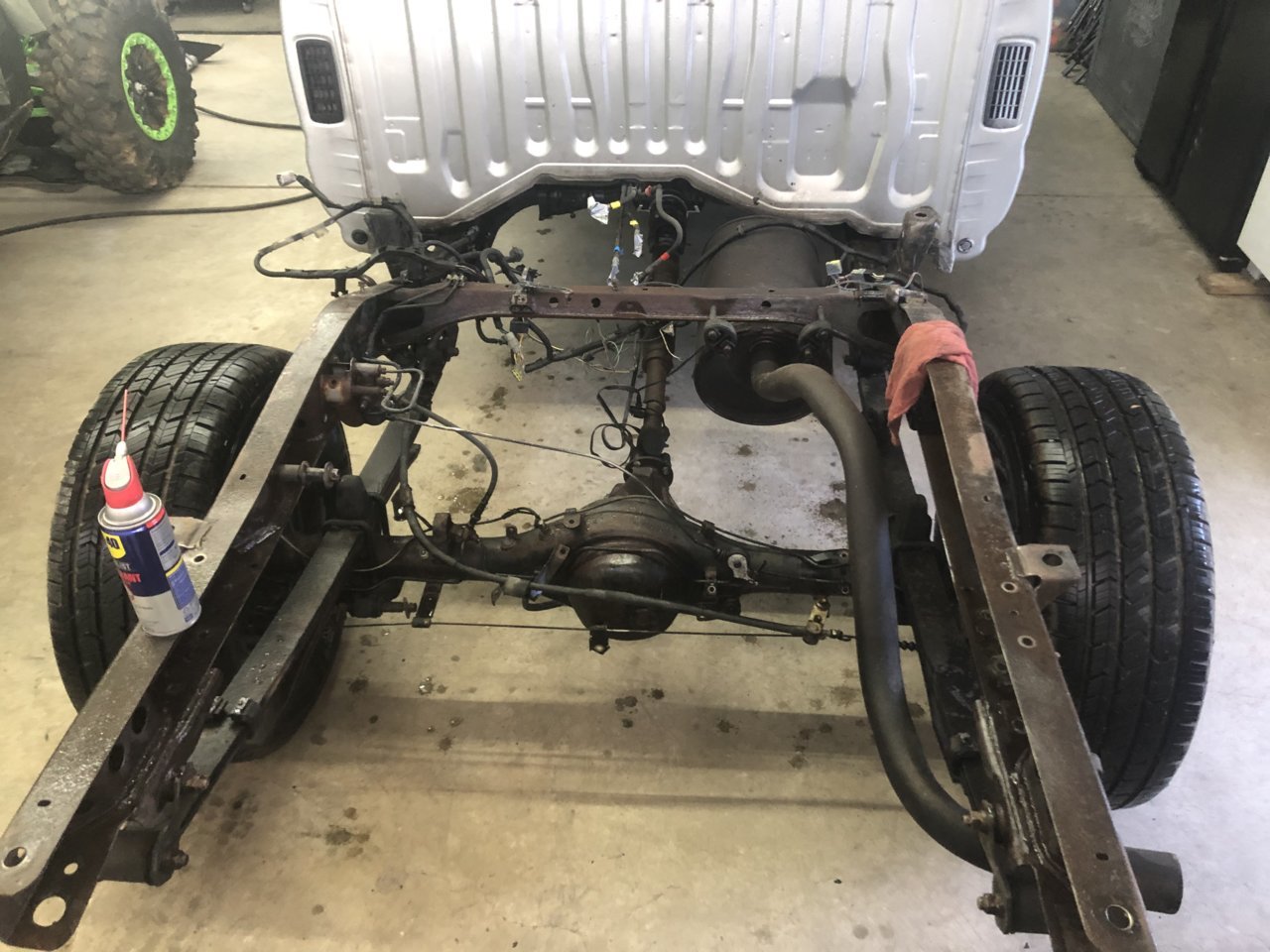

    I didn't have an air hammer with a chisel bit, so I used a flapper wheel on a grinder. Made a mess but was easy work of the rivet head. Punched out the rivet after the head was turned to dust.

    Do you have a grinder?

    Another way is drill a hole in the rivet head smaller than the rivet and then just slice the head off with a chisel and a BFH.

    Why do you want to completely remove the crossmember?

    The tool you showed in your original post will not have enough power to slice a rivet head off. And air chisel is my preferred tool for rivets. One bit removes the rivet head and another pops whats left through the hole.

    Looks like a big project... from the pics, existing frame doesn't look too bad. Curious what your plans are for the restoration? Wire wheel/brush and repaint or are you going more elaborate?

    Great work, same project in my garage 2003 Tacoma. I have removed the rear xmember, but the fuel xmember is being difficult. How did you get it out? It’s loose now(slides both ways on frame rail) but binds up when I try to remove it.
