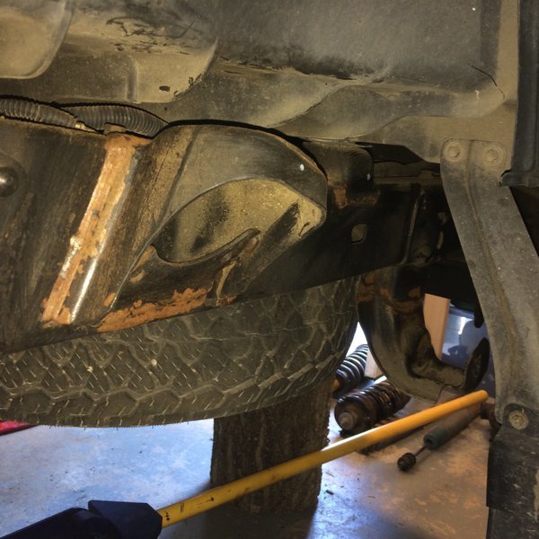

    #188910
    200

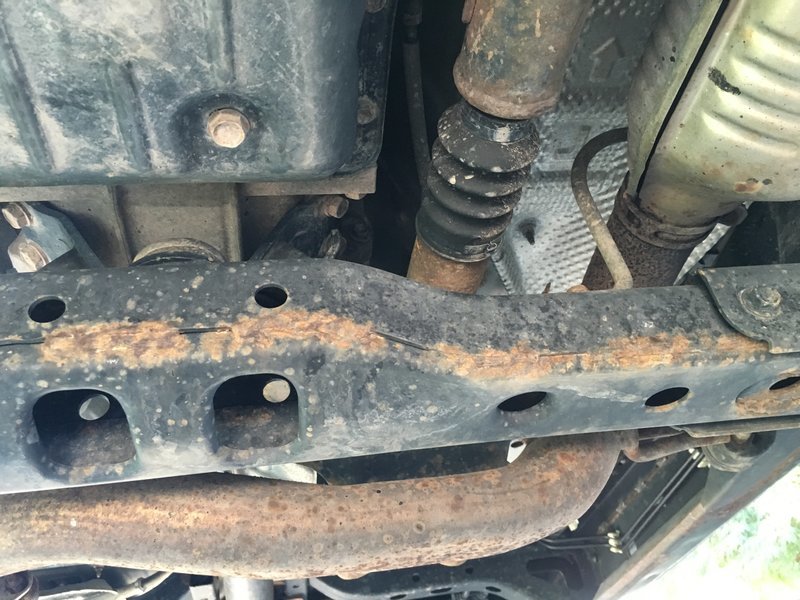

    Has anyone had a 09 frame replaced?
    The pic shows just a small area of the rust but...... You get the picture
  5. Jul 28, 2016 at 8:01 PM
    #45
    Icepuck72
    Icepuck72 [OP] Well-Known Member
    Jul 9, 2011
    #59563
    1,809
    Mark
    Richmond, VA
    2006 DC TRD
    OME 885's, Dakars, TRD Trail Edition Wheels, 285x75x16 Goodyear Duratracs, Magnaflow 12256 muffler, Fog Light mod, 2 Baby seats
    consider yourself lucky!! That looks brand new compared to some. Check your frame by the catalytic converter. That's where my holes are and a majority of others. I'm not sure if 2009 was under the recall...I thought it was 2005-2008. Call your dealer, they'll get your VIN and let you know.

    200
    The worst rust on my Tacoma IS by the Cat... Gonna try and get a pic of that if the rain stops... This is a NY truck so it has seen salted roads.

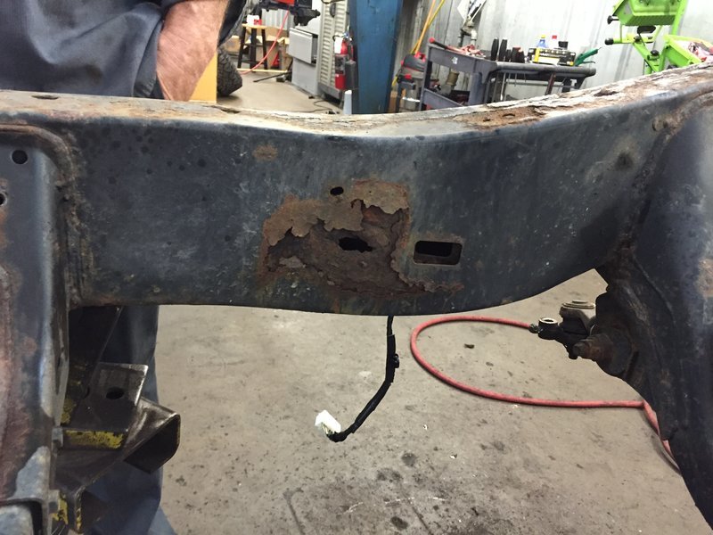

    Good luck op. I had a red 06 dcsb trd offroad just like urs a few years ago and it was rusting so fast it was scary. Never could get dealership to fix it. But they was happy to take it in on trade like it was fine and sell it to the next poor guy.

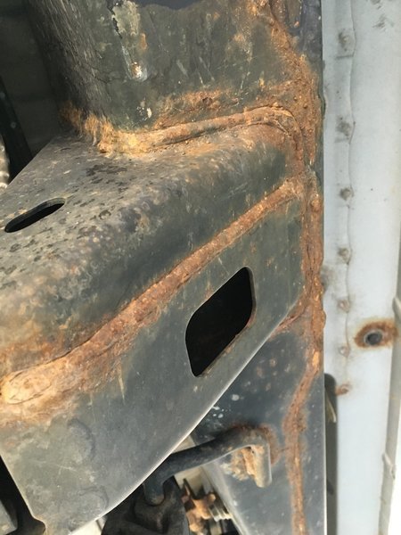

    1,735
    Some people theorize that the heat from the catalytic converter promotes the corrosion in that area -- i.e., heat increases the rate of a chemical reaction.
    The reality is that these frames actually have a self-destruct mechanism built into them. In the back of the front cab mounts, there is a gaping hole into the center of the boxed section of the frame, right at the catalytic converters! The cab mount is sitting right there where the wheel sprays nasty salt crap straight up into it. So essentially, you've got perpetual salt crap shooting off the wheel and into the frame at that precise point.
    I closed off my front cab mounts to keep the road crud out. I suggest that everyone do this.

  12. Jul 29, 2016 at 2:39 PM
    #52
    2Labs4x4
    2Labs4x4 Well-Known Member
    Jun 6, 2016
    #188910
    200

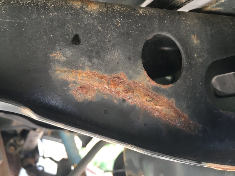

    A few pics of rust close to the cats and a pic of how the welds look after wire wheeling and POR treatment/painting
    DaveInDenver likes this.

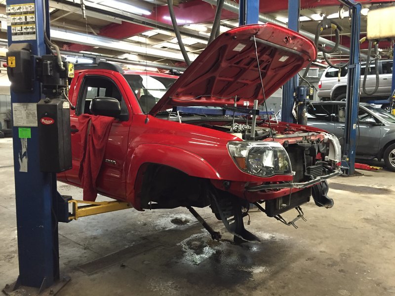

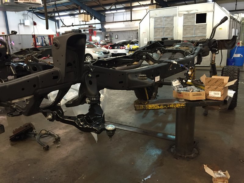

    Update on my truck...they called today things are going well. Totally agreed to put all of my OME stuff back on no questions asked. When I initially talked to the Service Manager back in May, he was hinting that he would have to charge me to put my Dakars and OME crap on. What?? Much nicer dude and more competent said that's ridiculous. Anyway, they have 4 teams of 2 that do frame swaps all day long...and they know what they're doing! Hoping to have it back Wednesday night!!!!

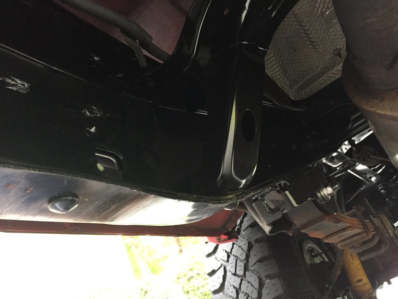

    Unexceptional

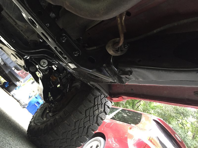

    Mine was inspected and "No Significant Perforation Found", thus it was not eligible for replacement. But I'm doing the same as you, keeping after it.
    Before:
    After:
    Rust may never sleep but on Tacomas it seems to take Trucker's Choice.

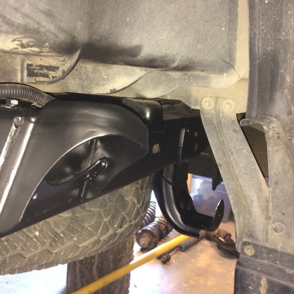

    My dealer did an awesome job.

    2009 Silver 2.7 AC 4X4
    My 2009 looked similar to yours, maybe even a little worse. I wire wheeled mine, Eastwood treated, and painted. Still looks good 1.5 years later and I am not concerned at all about the safety or integrity of the frame. Looks like you did a good job as well.
