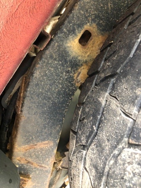

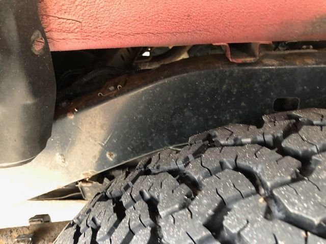

    This is what the majority of the frame looks like, was stored in a dirt lot for a month or so so some of what you're seeing here is surface rust/sand/dirt/mud.

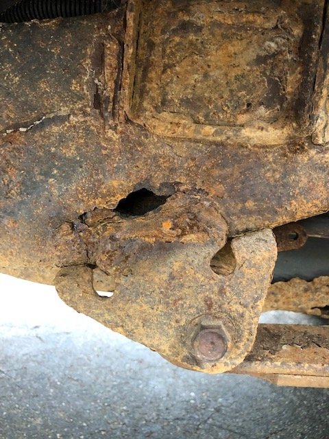

    And here is the piece that I found to be rotted, which from what I understand is a common spot.
    And yes the gas tank skid plate is going to be replaced!

    Being a 2002, you are well beyond the extended warranty period for your truck, which is 15 years from the in-service date.
    You're only hope now if either patching the hell out of that one, or sourcing a frame from AZ and start cleaning and treating your frame regularly.
    From the looks of that frame which has supposedly already been replaced, do you park that thing in tide pools or something?

    Yeah, that area is pretty harsh on frames.
    If it's a beater and you ignore the whole "it's not safe thing", just drive it until it falls apart, and it WILL fall apart... But if you want to keep the truck long term you'll need a whole new frame. It'll take some work, but you could source a used one like I said earlier, and new frames run around $4k iirc if you can get one. I think Toyota is holding on to a lot of them until the warranty period is up on all the trucks.
    If you want the truck to last (once the frame is replaced) you're going to have to be super anal about cleaning and treating it. There are a few threads I've seen where people describe their routine (seasonally clean and treat with POR-15, etc...).
    Good luck!

    Your photo looks to be the "mid frame section w/spring mount"
    xjoeyc23x[QUOTED][OP] likes this.
