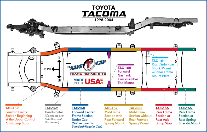

    Keep in mind the frames typically rust from the inside-out. Go ahead and use the patches, but be aware there are others spots likely to rust through, too.

    Even better. They can tell you exactly which part of the frame needs attention.

    it looks like after they swapped a new frame on it was NEVER coated by them
    were they supposed to coat these replaced frames?
  9. May 14, 2019 at 6:19 PM
    #29
    Blue92
    Blue92 Well-Known Member
    Aug 26, 2017
    #228071
    16,471
    Daniel
    North Carolina
    2018 Sport
    nope
  10. May 14, 2019 at 6:25 PM
    #30
    GQ7227
    GQ7227 mw survivor
    Dec 6, 2018
    #275019
    29,298
    J A Y
    HFS for real?
    so it was up to the owner to pay for that treatment?
    my relatives used '98 was bot back and crushed since it failed in 'o11
  11. May 14, 2019 at 6:31 PM
    #31
    Blue92
    Aug 26, 2017
    #228071
    16,471
    Daniel
    North Carolina
    2018 Sport
    Dealer pays for it before the frame replacement if the frame passes inspection. Once they replace it, youre on your own.

    when i ordered my new frame (out of my pocket), it took 5 months. built to order. you can tell it was hand made.
    cruiserguy and GQ7227 like this.
  14. May 14, 2019 at 10:25 PM
    #34
    Empty_Lord
    Empty_Lord Toyotaholic
    Mar 13, 2016
    #181186
    28,286
    Dan
    Northwest Indiana/Chicagoland
    the coating is shit... it usually causes the rust to get worse.

    Fluid film, rust check, or krown. You need to coat any frame in the salt belt, especially a Tacoma frame
    Xbeaus and CS_AR like this.

    CorrosionX HD too :thumbsup:

    if the new frame was rust free the newly applied coating would've prevented it :notsure: or most of it?
    did that cost about $4k or $5k ?
  19. May 15, 2019 at 7:21 AM
    #39
    Northern Taco
    Northern Taco Well-Known Member
    Oct 8, 2015
    #166156
    2,816
    2022 Tacoma trd off road premium 2023 tundra trd off road
    The coating Toyota applies is crap, new or old metal it just traps moisture under the coating and rusts the metal behind.
    I use rust check annually on my new frame because I have 6+ months a year of winter and salted roads and surrounded by the ocean. Any frame will rust in these conditions, but a Tacoma frame seems to rust quicker than most

    About 2600. But I work at a dealer. For a customer probably 3-4K.
