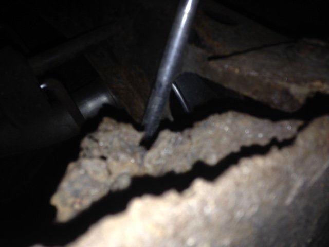

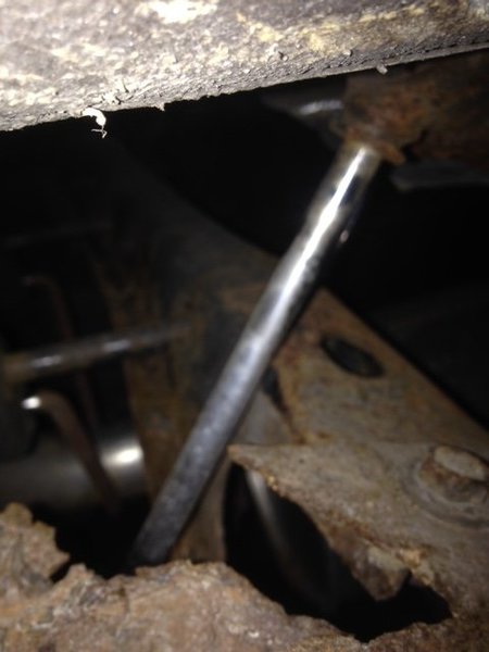

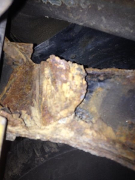

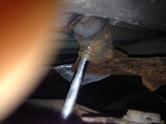

    Hey everyone,
    So about five years ago I brought my 99 Tacoma in for the inspection and they said it wasn't bad but they would spray the frame. So last year as I was noticed that the shock had broken off of the frame. I brought it to my mechanic and he welded on a new mount and it was fine. So today I notice the same thing! Only this time there is a nice chunk of the frame attached to the mount. I just emailed Toyota to see what they can do, I have heard of them replacing the frame/ buying back the truck if they did the spray and the frame still rotted. Has anyone else had this happen???

    As I understand it Toyota extended the warranty to 15 years on the frames. You are outside the 15 year window for either the buy back or frame replacement. You are, unfortunately, on your own.

    they are wrong, it doesn't matter when it was sprayed, all spraying does is extend the rust through warranty to 15 years from manufacture date so add 15 years from the mfg date on the door tag and thats when your warranty ran out. (which was sometime last year)
    sorry for your loss but perhaps you can locate another Tacoma that needs an engine so you can get back on the road at an affordable price. otherwise all you can do is sell it for a parts truck, sometimes this can get more returned money in your pocket then you would think.

    Or find another frame...Mine is rusted, too. I found a parts truck with a really nice frame to swap. If your frame is good other than the shock mount you could get a plate welded in across the broken place.
