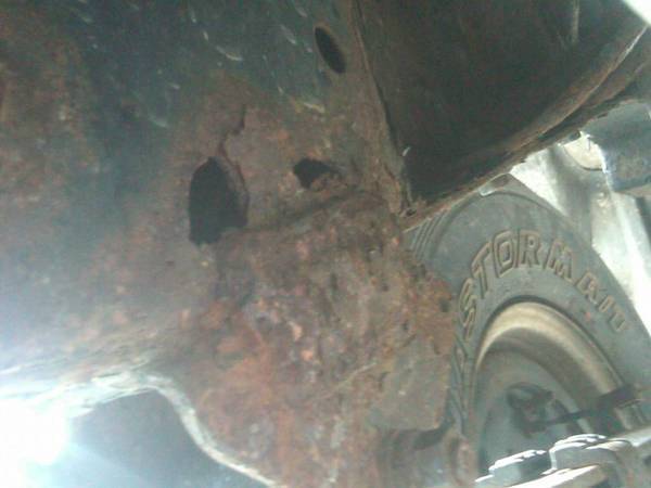

    Hey VanTaco,
    The inspection shouldi be free. Like I mentioned I had the 98' bought back and my 2002 has been reframed, but I don't think I have the paper work anywhere, but I'll have a look around for you. Are you just looking for something to show the dealer?
    My 98' rotted through, and my 2002 looked like it was going to be ok, but once hit with the hammer you can see where it did rust from the inside out. First two are the 98 and last is the 2002.

    It's not like your frame is going to look mint one day and have a hole in it the next. I think most of these trucks with rotted-through frames passed inspection a few times when we were thinking 'holy shit, there's no way this thing will pass...' only to have Toyota tell us that it was 'superficial' or 'surface' rust. I don't think you're going to have a mint paint job on the outside and a totally rotten and rusted frame inside. Furthermore, if you don't live in a state that salts the roads, there shouldn't be any issue.
