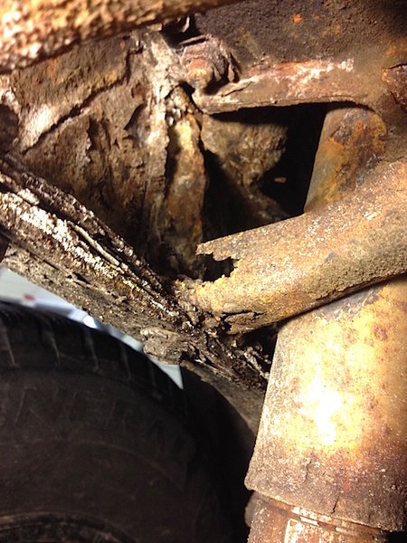

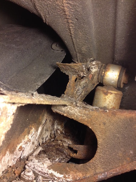

    So I started hearing a rattle in the rear of my 04 Tacoma. Slid underneath Fu4KPass side rear shock-21.jpg
    Cole_peppa and chaosrob like this.

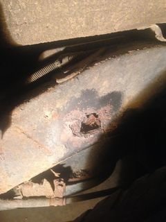

    Okay,I'm jealous,what's the trick to getting Toyota to do a frame replacement?? I went to my local dealership an originally(on the phone) I was able to get the new frame under the recall,then when I took mine in framehole_zpsfanbkuos_7a5ae3aa7340598fe8e4a365fc91fd4e0de09d95.jpg they ran the VIN an said it was coated in 2010(by another dealership)an that Toyota met their responsibilities under the recall an sorry about the rust hole but i wasn't eligible for the frame replacement,so I went out to the parking lot and called Toyota an basically was told the same thing..This one is a 2004 also..

    If you had your frame coated you are covered for a perforation until 2019 and you should be given a frame replacement.
