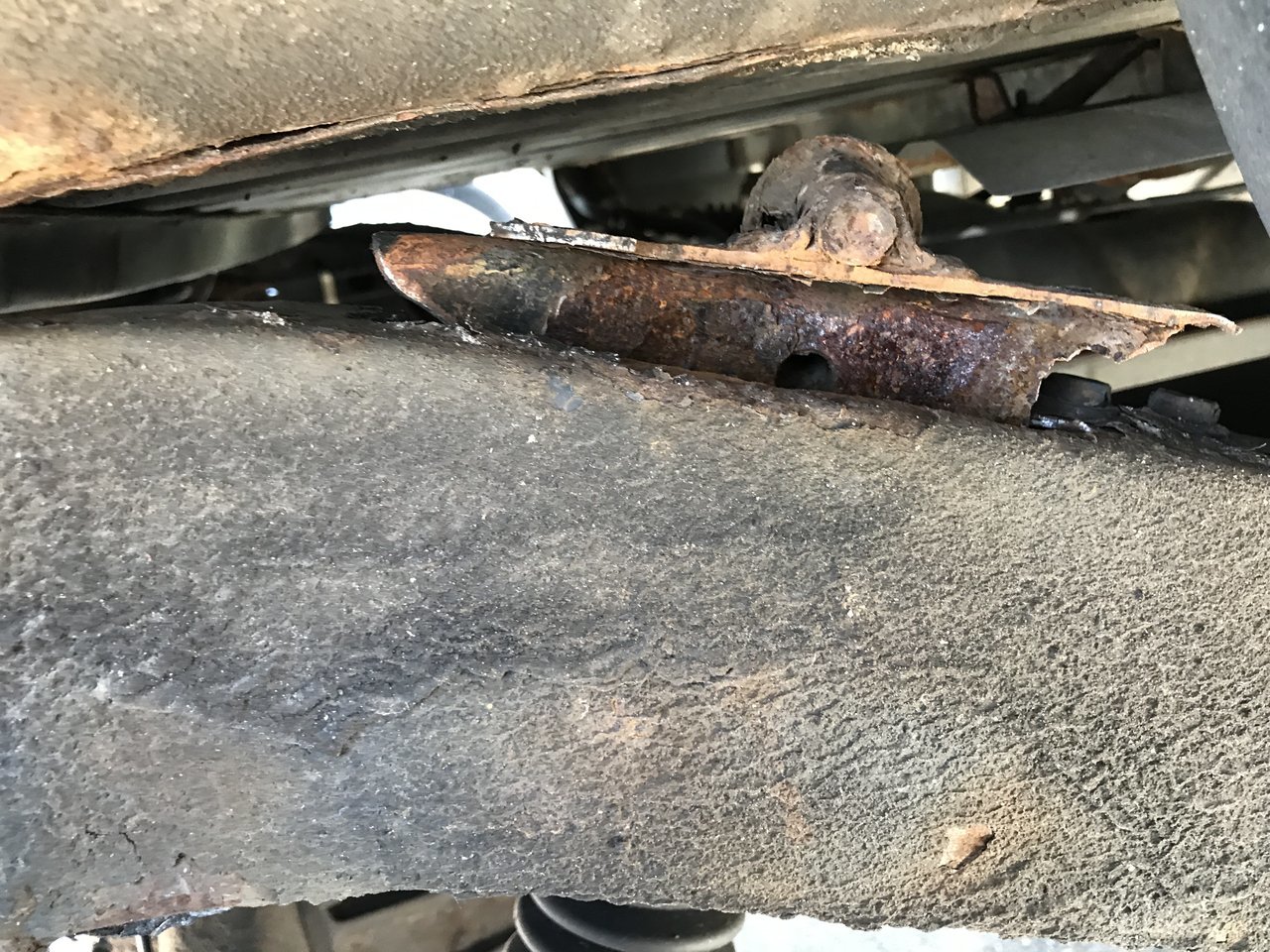

    My frame cracked at the pasenger rear strut mount. Not covered by warranty. I have a 2001 did undercoating in 2010.
    The poor quality metal caught up with my truck!

    Sorry to see that. Check out the rest of it and get 'er fixed if you can. Weld on reinforcements are available.

    Do you think this could be repaired? Had one shop tell me no so far. Seems like these frame plates might help from CBI.
    Question for the forum would be can i remove the strut entirely on that side? I have a 1.5" AAL. will my drive rack the suspension possible causing the wheel to move forward and back on that side in relation to the wheel well? Trying not to die driving the truck on the highway!!
    I dont want to get rid of it but it doesn't look great now.
