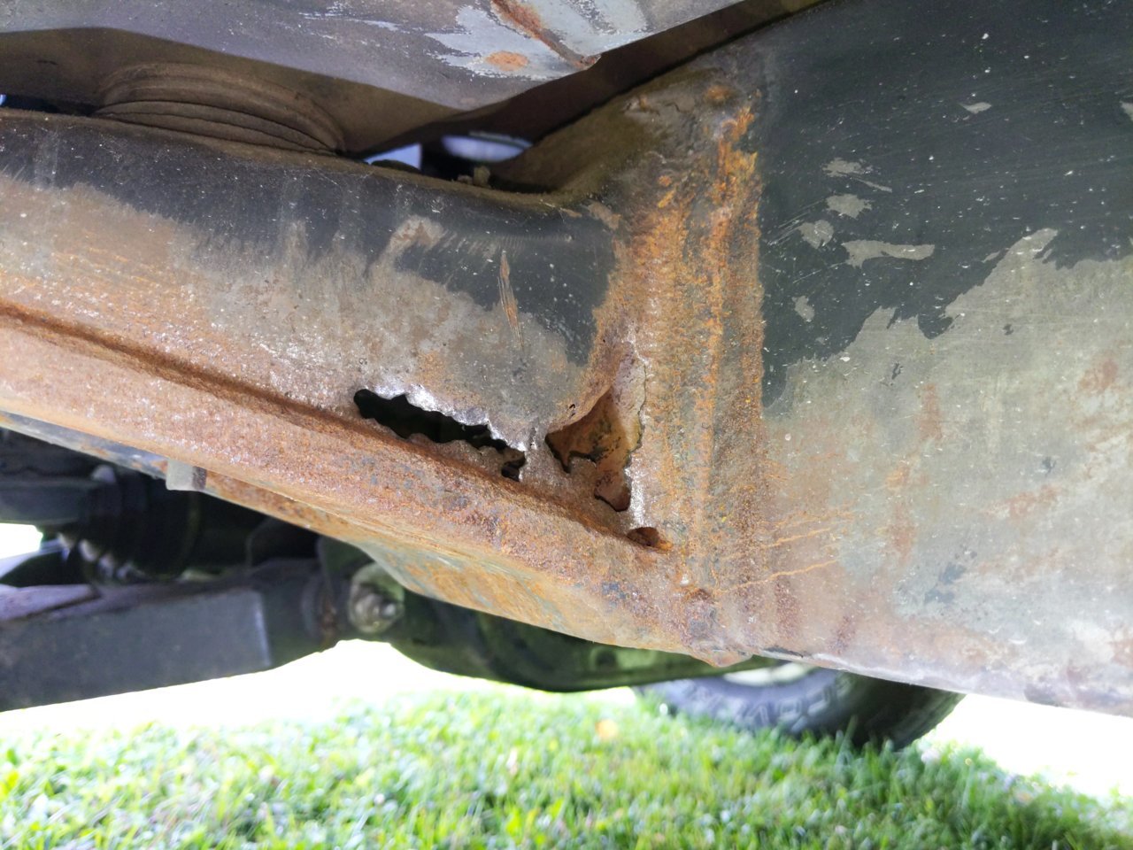

    Doing an overhaul of the truck and doing a lot of wire-wheeling and prep for POR-15.
    8 months outside the replacement window and what do I find this morning underneath big flakes of Toyota CRC...
    Oh look, it's EXACTLY what I knew was going to happen.

    I hit up a friendly dealer service manager about this and learned something interesting about the inspection process:
    "... if we as a dealership had been that aggressive to find those holes, meaning any evidence of hammering, scraping, etc, the claim would have been denied. This is per Toyota. The holes have to be visible with zero external influence."
    Most people seem to think that the dealer inspection involves taking a hammer to the frame and seeing if it goes through. It would appear that that is not the case, and that as long as there's a thin layer of black goop holding the rust in place, Toyota calls it good.

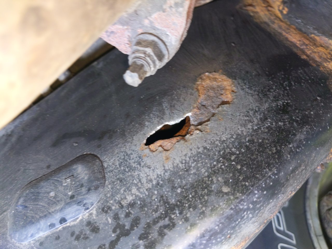

    I think I can answer that one, or at least my educated guess. My wife had a 96 that was bought back, at that time the hammer was being used. I'm not sure if her particular truck needed that or was bad enough as it sat..nor did I want to even look at it when we went back to pick up her rental car.
    My 2010 just got reframed, found an exhaust hanger falling in April. The bottom and outside of that rail had 10-13mm sized holes (pics in my album). The outside one, I pushed with 2 fingers and it caved in to a 1x2 inch hole.
