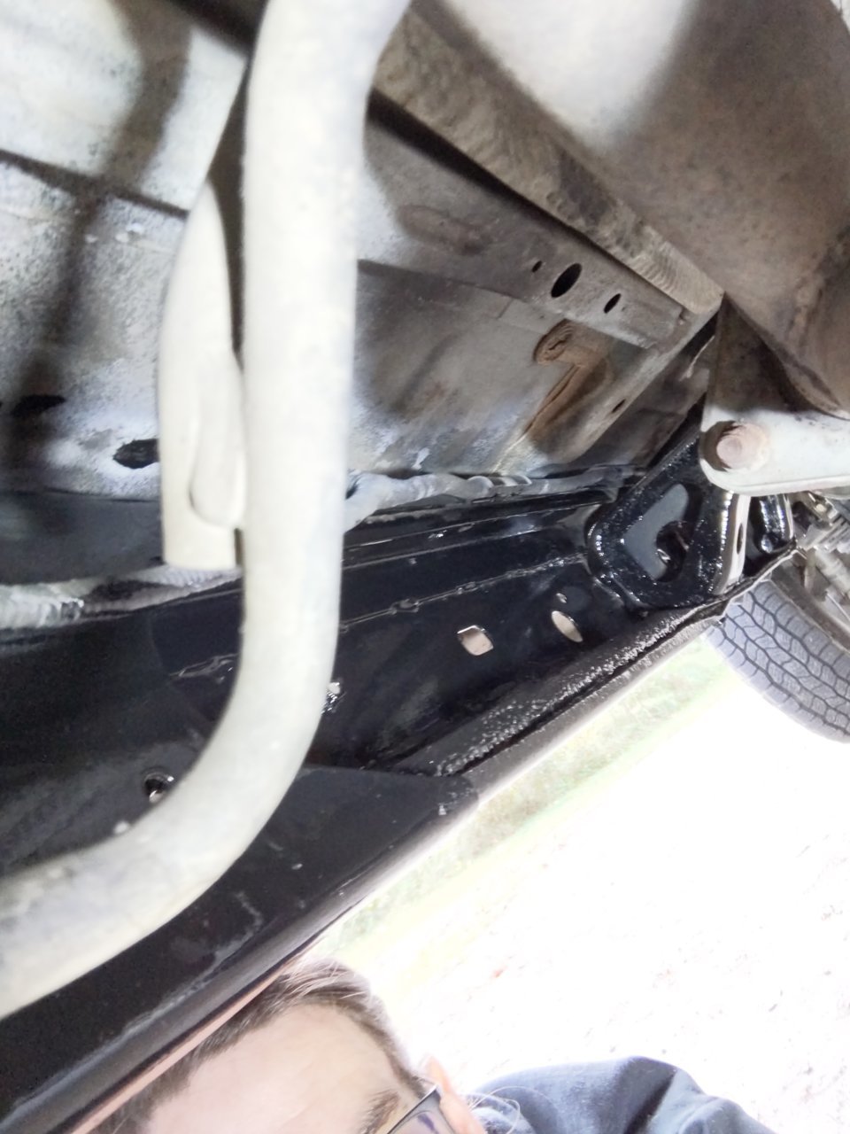

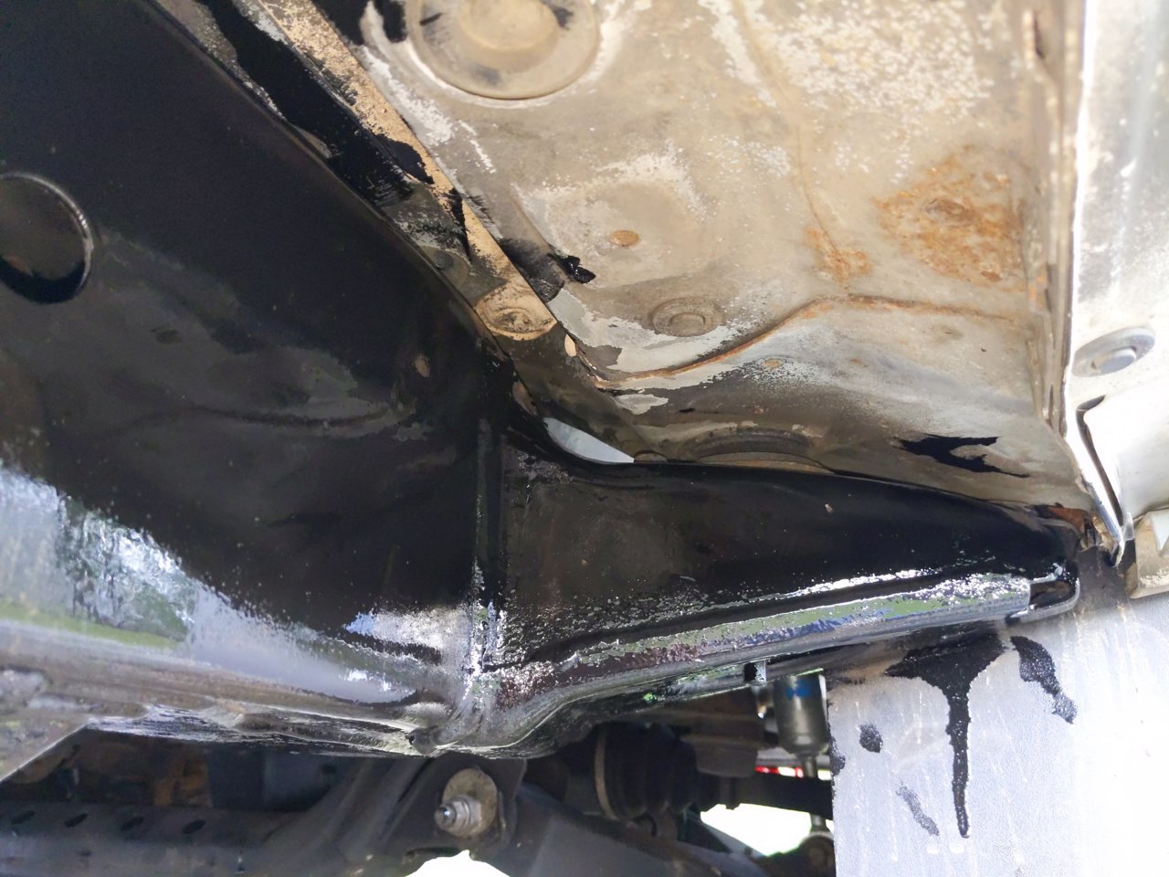

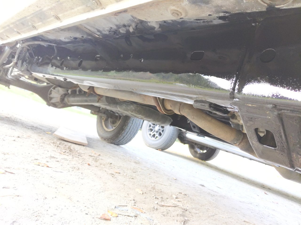

    Here's what's currently up with the frame:
    Wire wheel, zinc etch, and POR-15 from front cab mounts to rear spring mounts. Plating welded onto cab mounts on both sides:

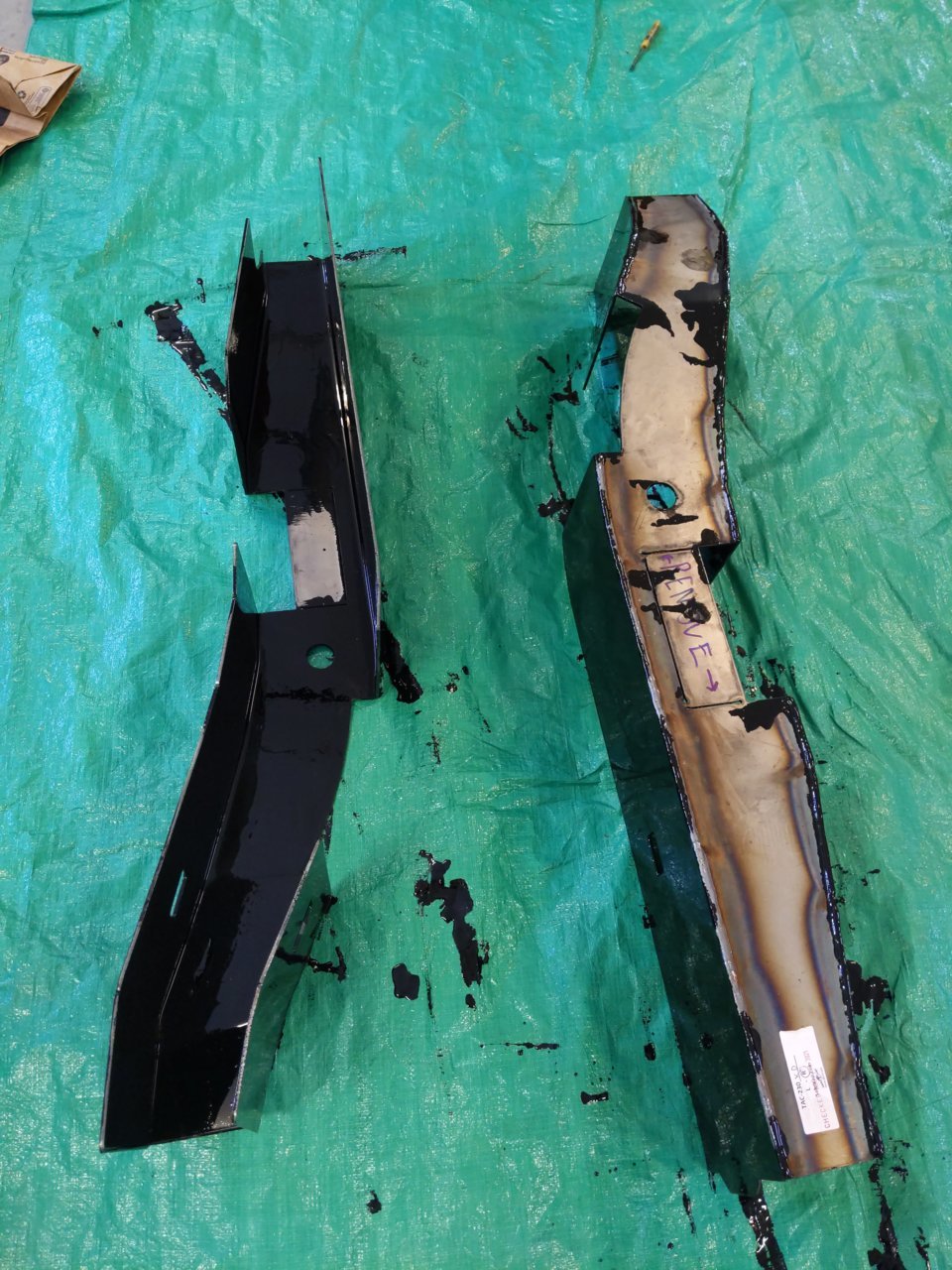

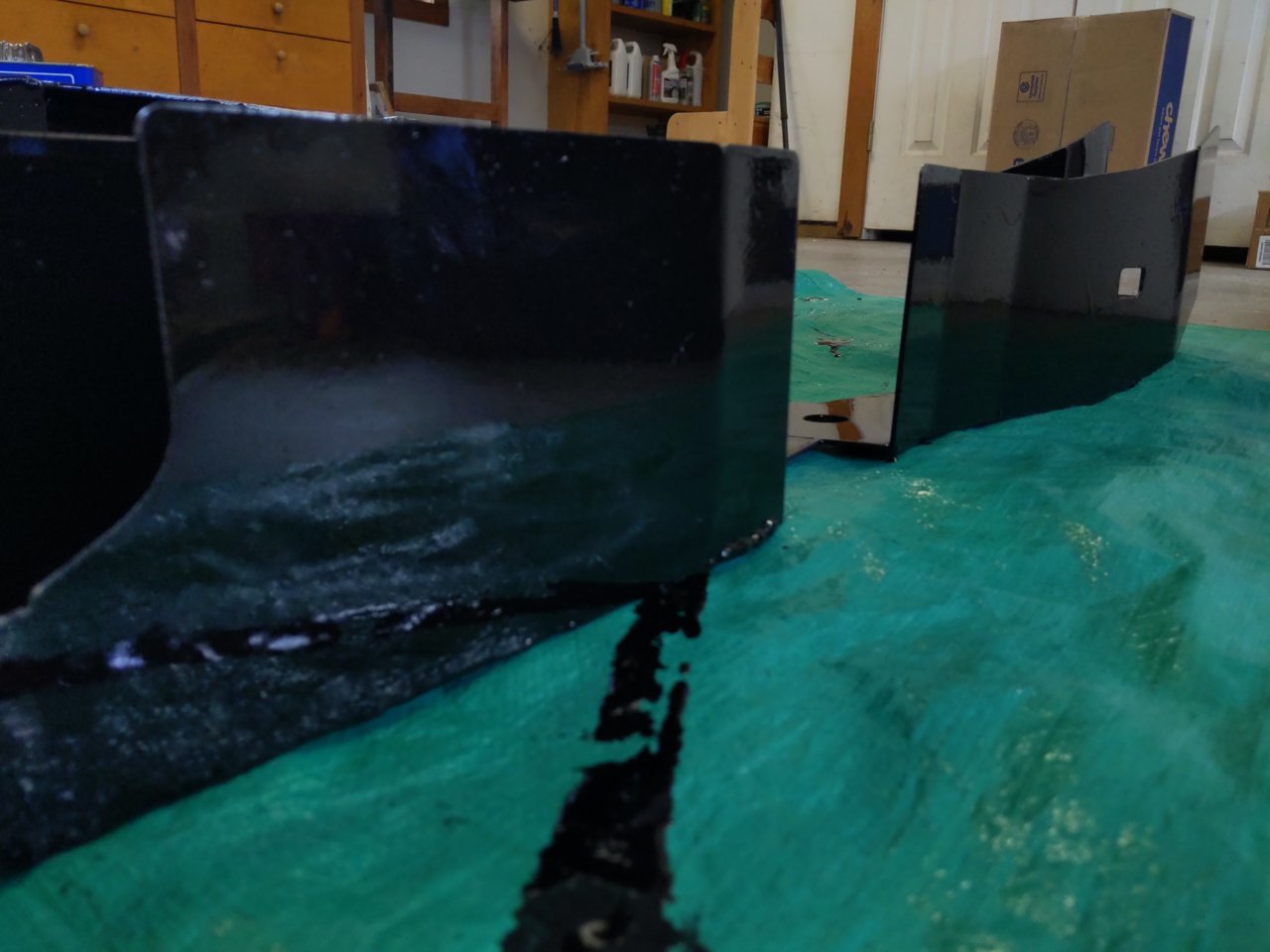

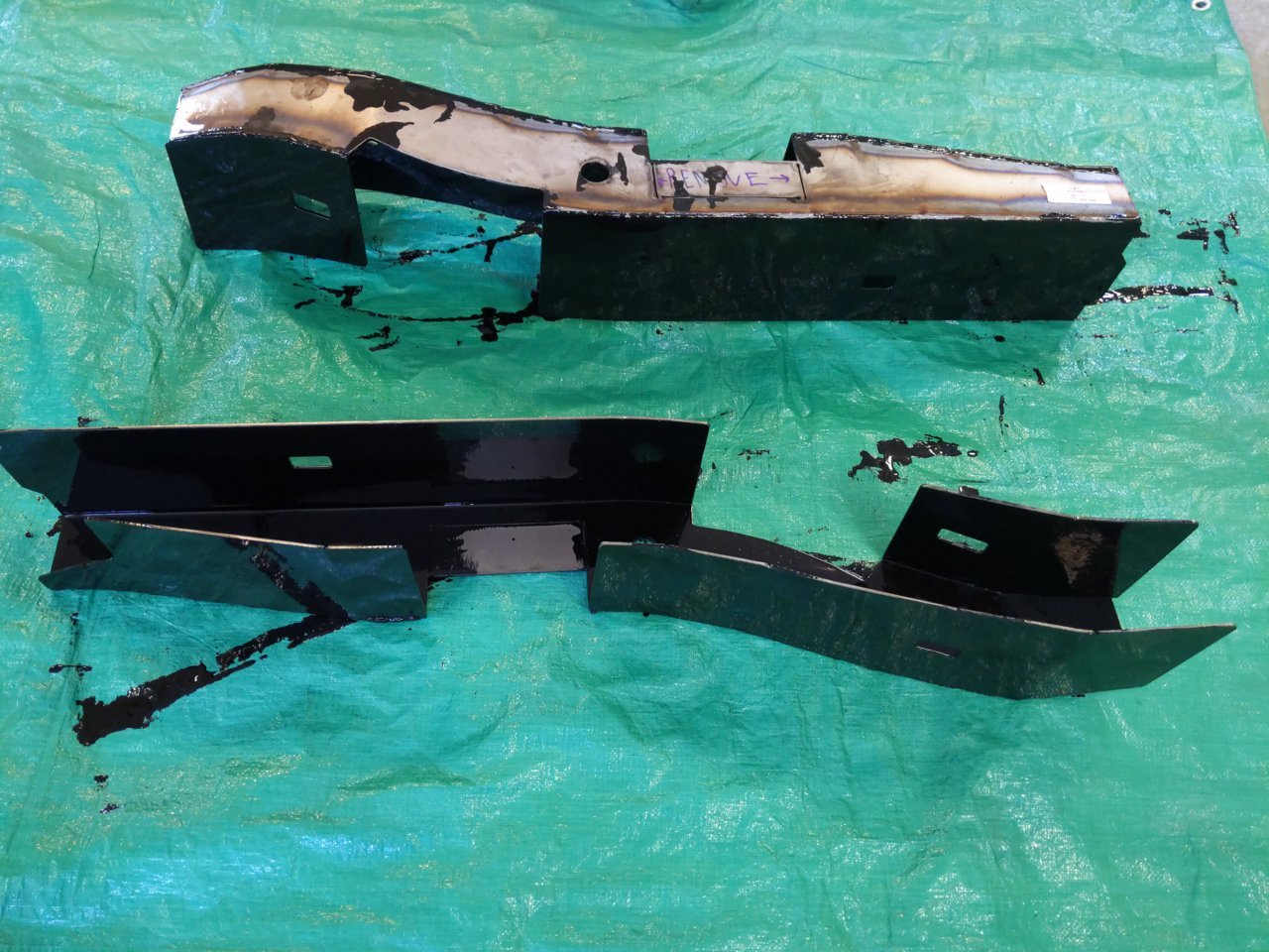

    Saf-T-Caps prepped and POR-15 inside and out as prep for welding. For some reason I didn't take a pic of them fully coated, but you get the idea I'm sure:
    The manufacturer recommends cutting the bottom face off the frame before installing the Saf-T-Caps. Since the steel on mine was still pretty good, I decided to leave it in place. Fit was great even without cutting the frame.
    Instead, after welding the full perimeter of the caps, I through-drilled the drainage hole in the bottom of the cap through the bottom of the frame, and welded a bead along the edge of the hole to allow drainage but keep anything from getting between the cap and the frame.
    Since the cap and the frame are both POR-15'd, this should keep rust from building between the two.

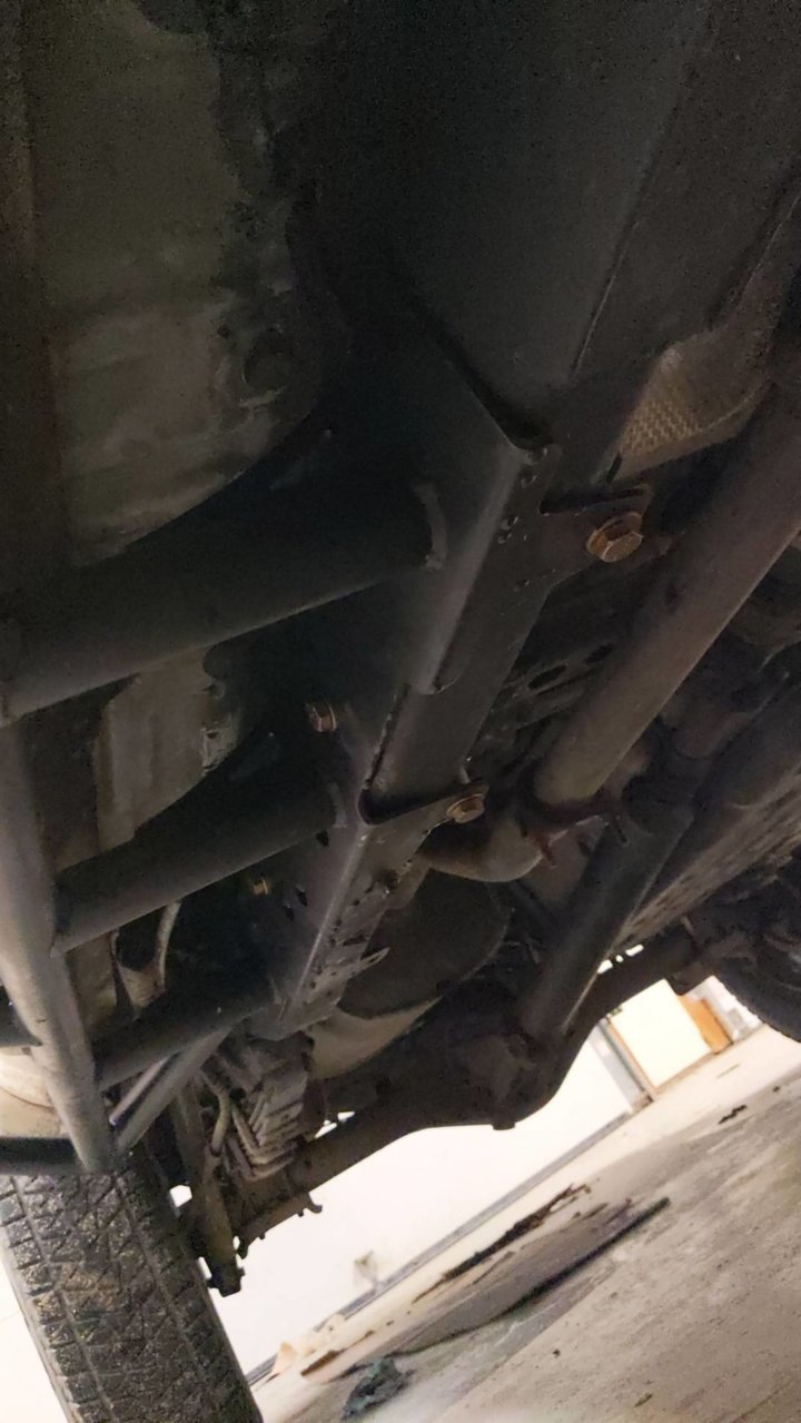

    After install of the caps, the insides of the box frame sections were cleaned out with a chain flail and heavy coated with SEM cavity wax to protect them for at least this winter until I can POR in the spring/summer.
    As part of installing the caps, I lifted the cab off the body to make room to weld the top edges.

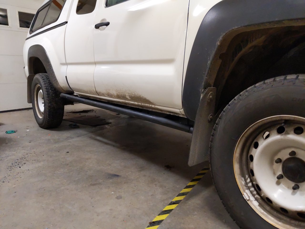

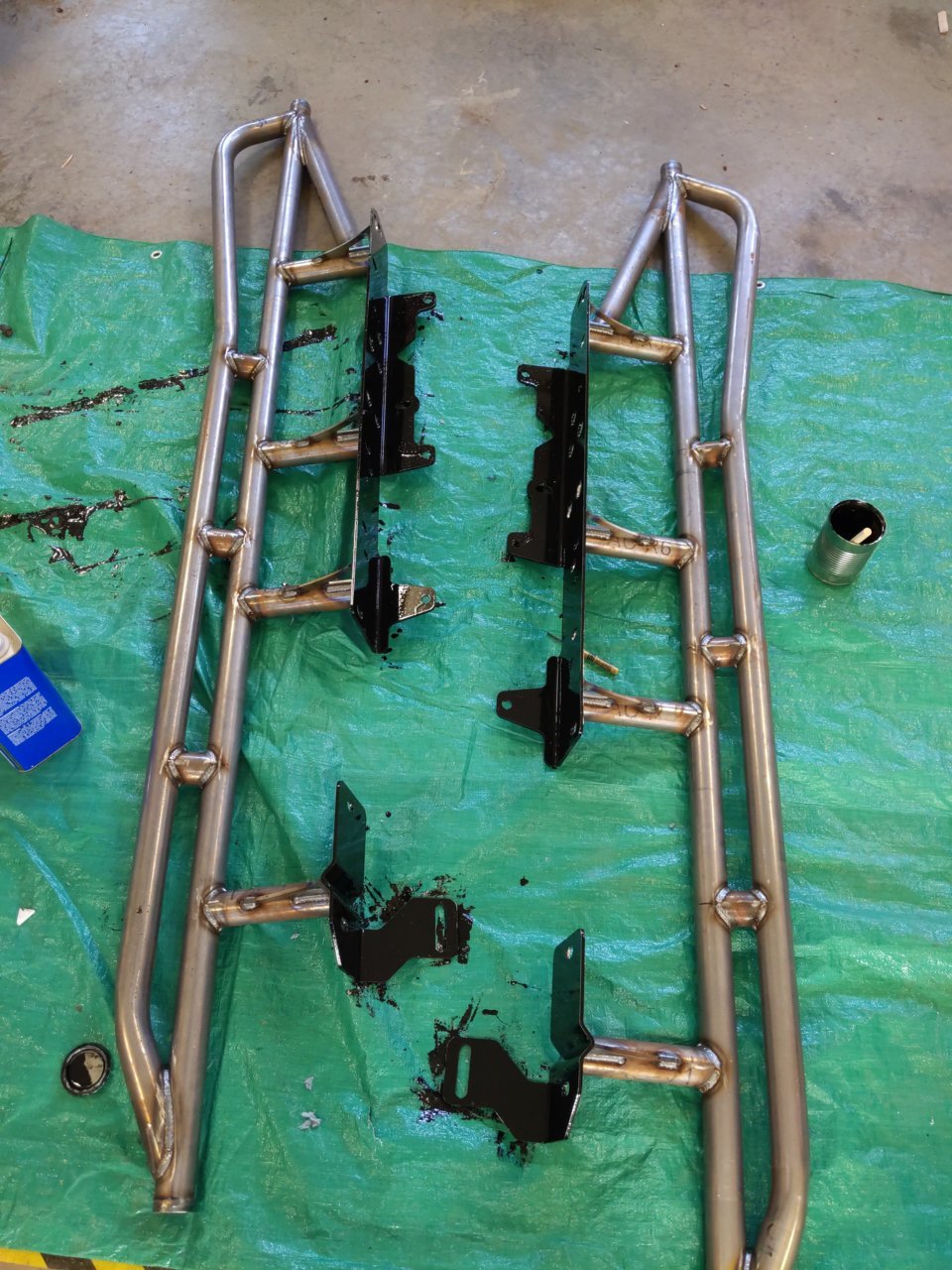

    Also, Cali Raised trail sliders installed. It was required that I drill holes for the front mount bracket due to the Saf-T-Caps.
    I located the holes by installing the sliders, then drilling through the brackets as a guide. The job was easy using a 1/4" aircraft bit for pilot holes and a 1/2" aircraft bit for sizing.
    I did need to do a little fitting of the 1/2" holes with a small carbide burr and a Dremel for a clean fit. Paint and Amsoil HDMP applied liberally to exposed edges. Next time I work on the frame I will remove the sliders, then enlarge and weld the edges of the slider mount holes the same as the drainage hole mentioned above.
    POR-15 on the inside faces of the slider brackets (and whatever half-cans of black rattlecan I had sitting around for a couple coats on the rest):

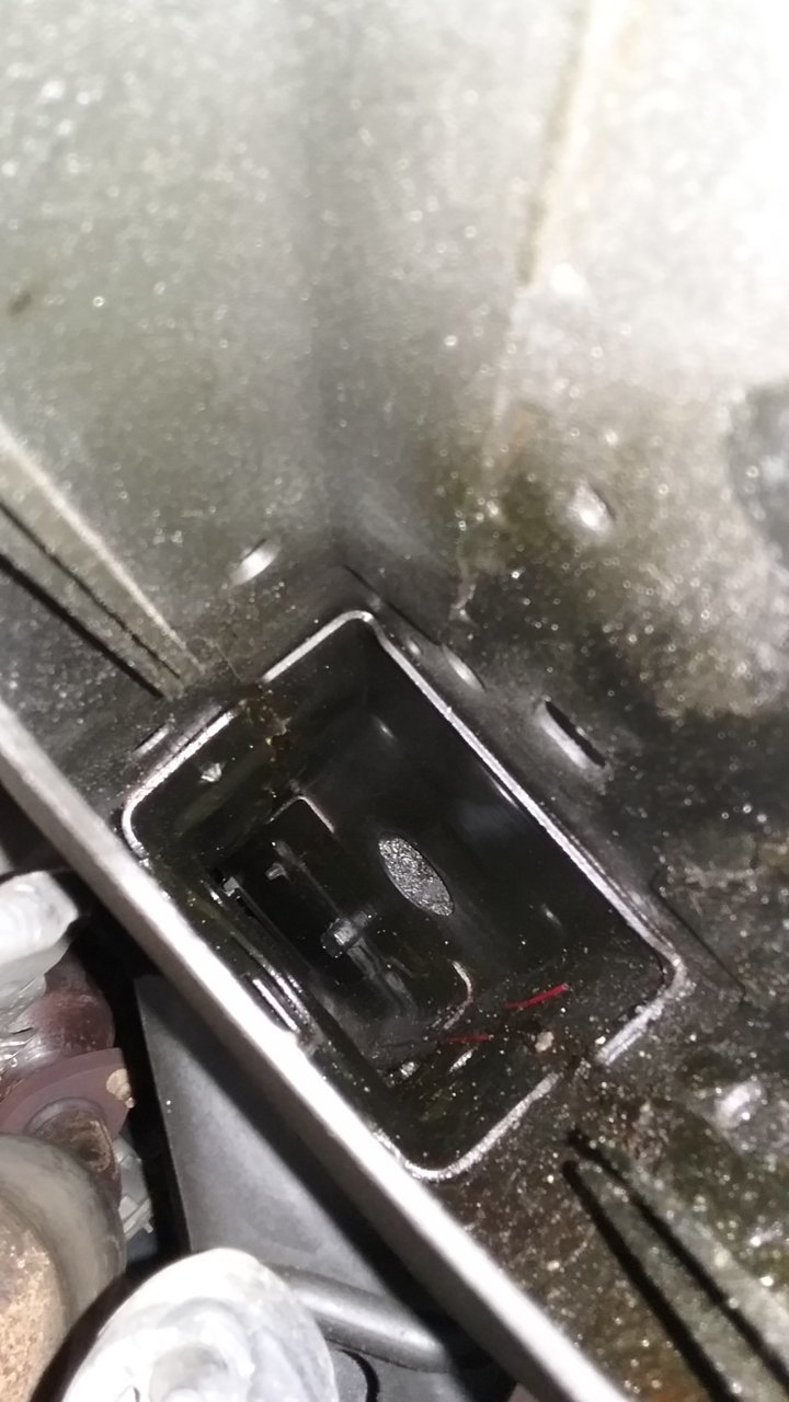

    I just spray on and inside all of the critical areas. Here's what the inside of my boxed sections look like after 6 winters.

    haha I took a screenshot in your original post… I wonder if this would play nice with the wool wax or if I have to choose one.
    Does it wash off easy, so far the wool wax is standing up to weather.

    It goes on a little runny but thickens up over a couple of days. No it doesn't rinse off particularly easy.
