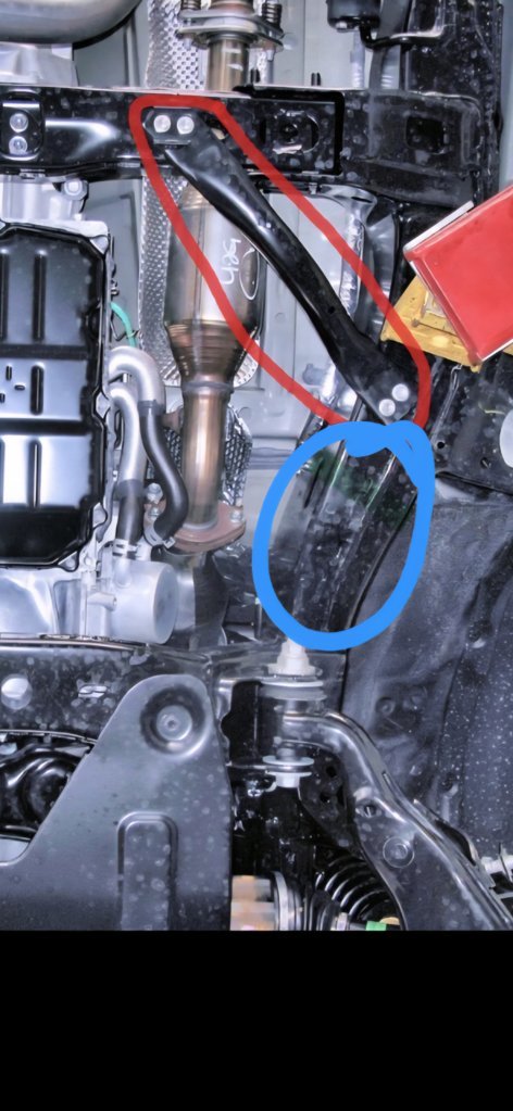

    Yeah I believe so. I found a picture online of the underside. I believe it actually came from TW. But the area circled in blue is the area in the picture. Ignore the red. Honestly looking at this picture it almost looks like there's a dimple on their frame in the same area.

    What state was the truck from?
    My 93 pathfinder was from upstate ny, salted roads and I drove it on the beach out there and eventually the frame cracked on both sides.
    Welded plates on both sides and eventually got the tacoma in 17....I miss the manual transmission, manual hubs, locker and transfer case

    Its From Ontario. Between Niagara falls and Detroit. Definitely rust belt territory.

    Wire brush or wheel then waxoyl or fluid film. Don’t paint it or worse use por 15. Look up waxoyl it’s the best product. You can diy or lots of application centers in Ontario. I had three Toyotas rot out before I found proper treatment. GL
    https://www.waxoyl-usa.com/index.html

    It is what it is OP. Clean it up and treat it and then get on with your life!

    Why do you think a 2017 frame isn’t likely to fail?

    It’s not old enough.

    No.
